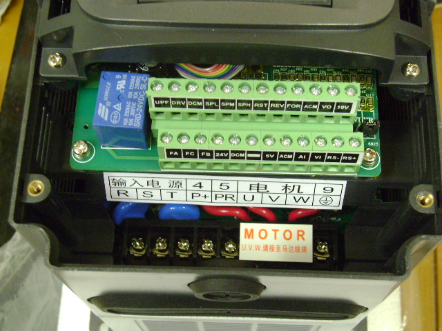

I have built a 3 axes 4 motors new cnc all in aluminum with a Chinese VFD (1.5kw, 13A, 400Hz, 120VAC input) and a Chinese water cooled spindle (800W, 400Hz, 24000RPM). I知 using Mach3 and the Gecko G540 controller. All my settings are for PWM.
All is working fine but the only problem I have is with the spindle calibration. I have checked the VFD and on local control when I press the RUN it goes up to 400Hz, 24000 RPM, and the voltage on the VR(+10V) terminal is 9.88v. On the G540 the voltage on terminals 7&8 varies depending on the speed I ask.
I input on Mach3 M3S6000 and the VFD shows 11300 RPM / 188Hz, the volts on G540 T7/T8 = 2.42v
I input M3S12000 and the VFD shows 15398 RPM / 256Hz, 4.81v.
I have been playing with all the Mach3 settings for about 2 weeks now with no success. I don稚 want the VFD to be exactly on but right now the difference is way out.

As I told you on the Mach3 forum, you have Mach3 and the G540 working correctly.
The problem is that your VFD is giving you the wrong frequency.
2.42Volts on the analog input should be roughly 100Hz (96.8).Gerry

Right, but the 2.42V goes back to the VFD, correct? The VFD uses that to set the frequency, and should be setting it at 96Hz.
