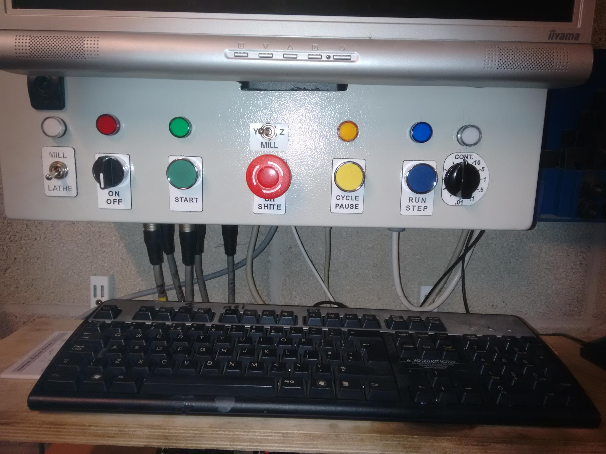

    With the 7i76 and 7i76E there are about 34 input and outputs with 5 axis two mpg's and spindle control encoder for threading A & B + index.
    So I have both lathe and mill wired to the card and use the two mpg to do both.
    I just select which config I want ie just one at a time.
    I used to use the lathe from the PP with just a 100 slot disc plus index pulse and it was fine for threading.
    PP has 5 inputs two were required for the encoder one for the O'shite button and two spare (could be z and x home)
