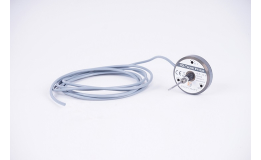

    Hello @a_camera
    Got a custom made cnc router with a UC300eth and ub1 bob running on uccnc.
    In the post today I got the stepcraft 3d prober tool.
    Going to try and get this working this weekend.
    Not entirely sure on the wiring and looking for documentation about it so I shall be trawling the internet.

    Hi. Good luck with your machine. Unfortunately I don't know how to wire that thing so I can't really help you out.
