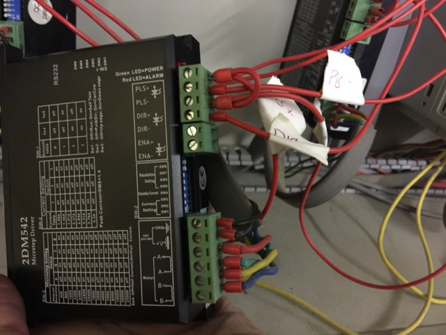

    After Mr Leadhead of these forums very kindly popped by to check over my Chinese 4x4' router and discovered the Leadshine M542-05 Y axis driver was indeed shot, I bought a JMC 2DM542 and installed it, connecting the wires like-for-like.
    Y axis now moves in the wrong direction.
    Now, if i was using Mach 3 i seem to remember there was a toggle to mirror an axis BUT i'm still stuck on NC Studio until i can afford a new control board (thinking Planetary; have heard good things) but in the meantime: anyone know a quick fix?
    NC Studio has 2 identical checkboxes labelled Mirror Axis, but neither do anything.
    The 2DM542 manual has a couple of wiring diagrams, nothing i can make sense of.
    The manual also has a chapter on parameter settings, but apparently i need an HISU adjuster to alter them. There's one called Initial Direction Selection which looks nice.
    SO, any hints and tips before i start switching PUL+/-; DIR+/- wires around on the driver?

    Swap the two wires of ONE motor winding over.

    AHA! Ok, so A+ to A-, or B+ to B-, but only switching either A's or B's?Click image for larger version.

    That's the plan. Don't forget to remove power before you do it

    Many thanks! Works perfectly. IOU a beer.

  8. There is a parameter in the drive called "Command Direction Selection", which can be reversed. If you make a mistake after changing, you need to change the direction of the location feedback. It should be like this, you can try it.
