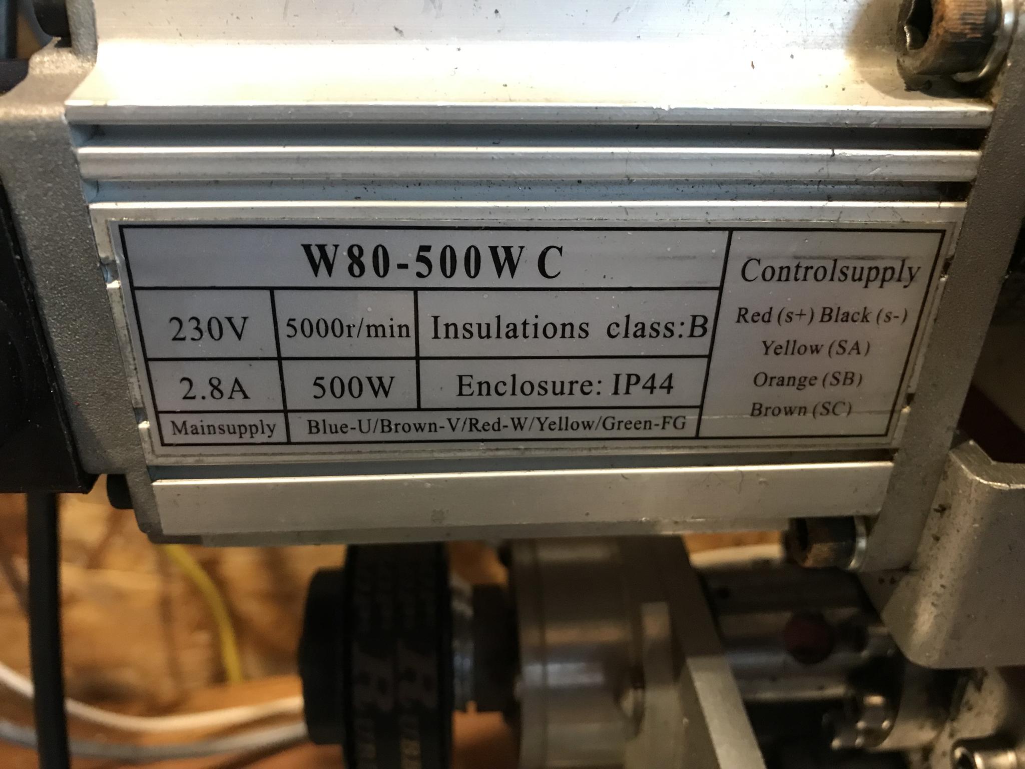

    Hi All
    I'm improving my mill and am looking to add spindle speed control from LinuxCNC to my Sieg X2 mill. I don't really want to change the spindle to AC and go the VFD route so am looking to use the PWM output to control everything. So was wondering if anyone had done this and how they had done it? I've found links to the Mesa spindle controller ( http://store.mesanet.com/index.php?r...product_id=205 ) and wondered if this then plugs into my mills transformer in some way to replace the manual variable resistor that controls speed. If it does has anyone got wiring plans or photos?
    If there are better ways to do this then please let me know too.
    Specs on the motor are in the attached photo.Click image for larger version.

    Thanks for that.
    Further investigation shows that the Leadshine MX3660 that I have has an analogue 0-10v out for spindle control. I've opened the potentiometer on my Sieg mill and the voltage there seems to be 4.7v max so could I just remove or bypass that potentiometer and use the outputs from my MX3660 if I calibrate them correctly?

    NO. As you will need an isolated pot, -- https://www.ebay.co.uk/itm/1-3KHZ-to...k5zL:rk:1:pf:0
    with an isolated small power supply https://www.ebay.co.uk/itm/AC-DC-Con...72.m2749.l2649
    and configure Lcnc to give you a pwm signal.
    Unless the MX3660 pot is already isolated.

    It looks like it already is.
    So is it just a case of configuring LinuxCNC to give me the PWM signal as per the documentation?
