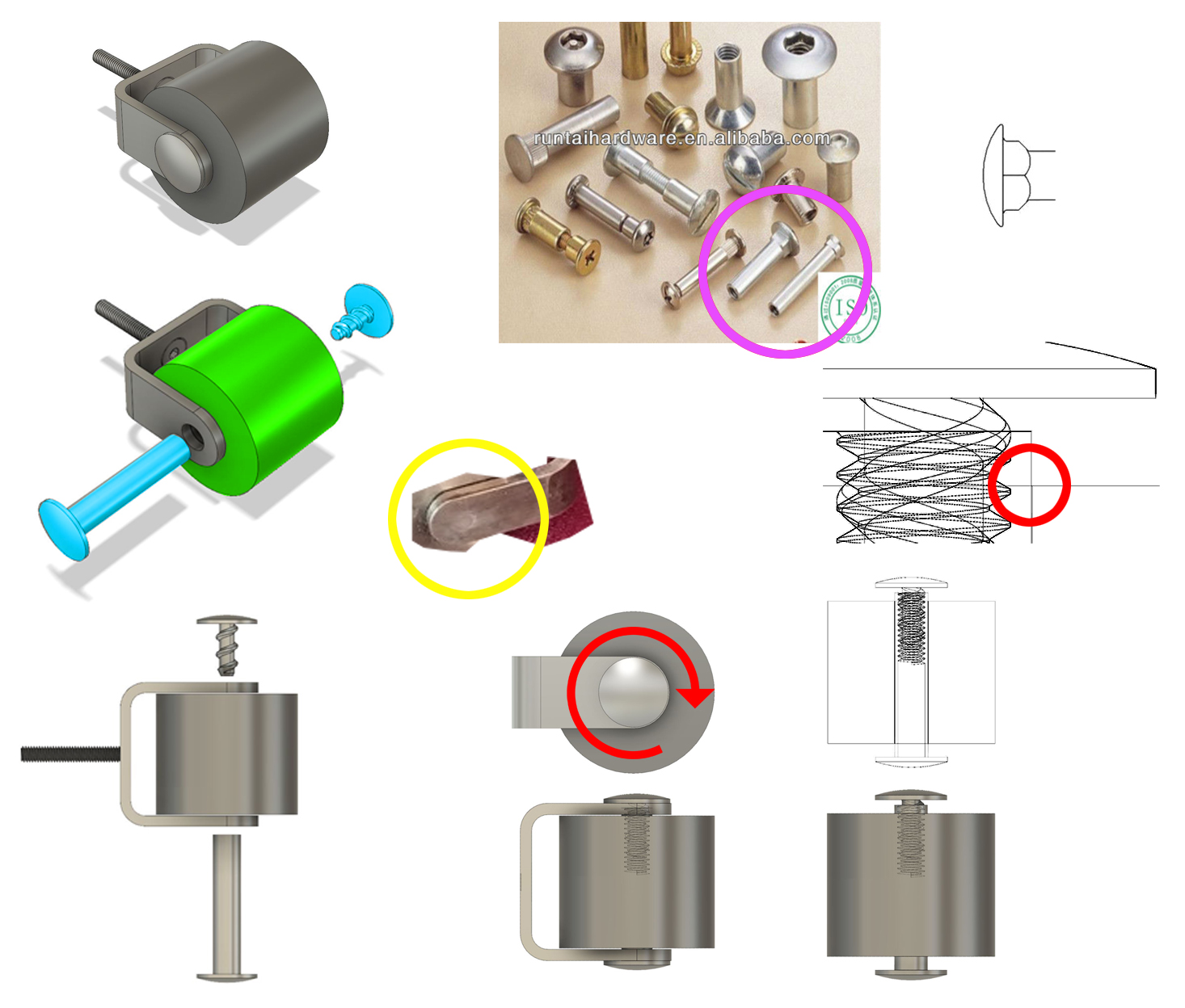

    i have a dilemma - i am working on this design - and the intent is that the (green) cylinder is to freely roll when applied to a surface (like a pizza cutter.)
    however - the binding barrel (blue) i sourced out at mcmaster-carr - i do not want to rotate. and i certainly don’t want to too tight as it will start to bend the channel.
    it’s also critical that the ends have no drive - but a nice polished-finished look.
    maybe an adhesive?
    i came across google images - where i can see a binding barrel with a hex at the base (like a carriage bolt) i think this would work - right?
    but i imagine it’s easy to drill the hole in the channel - but the hex shape not so?
    so i am at a loss.
    if you look at the reference in the yellow circle - the bolt is normally welded and then sanded off. i don´t like this look. (unless there’s a machine shop that could perform this with a better finish?)
    what are my options in achieving this function?

    We'll call the "Binding Bolt" the "Axle" and call the bolt which retains it the "Bolt"
    Simply make the hole in your channel to clear the Axle at one side and the bolt at the other, the axle will insert through one side of the channel and sit against the other, the retaining bolt will tighten and retain the axle without pulling the channel together.
    Use a chuck or collet chuck to hold the axle end still and to tighten the bolt, a little medium strength locktite on the bolt thread will ensure it does not work loose.

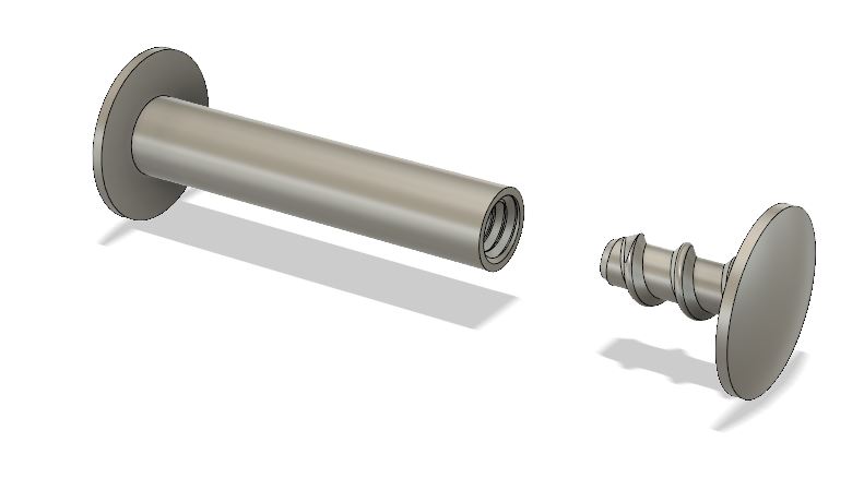

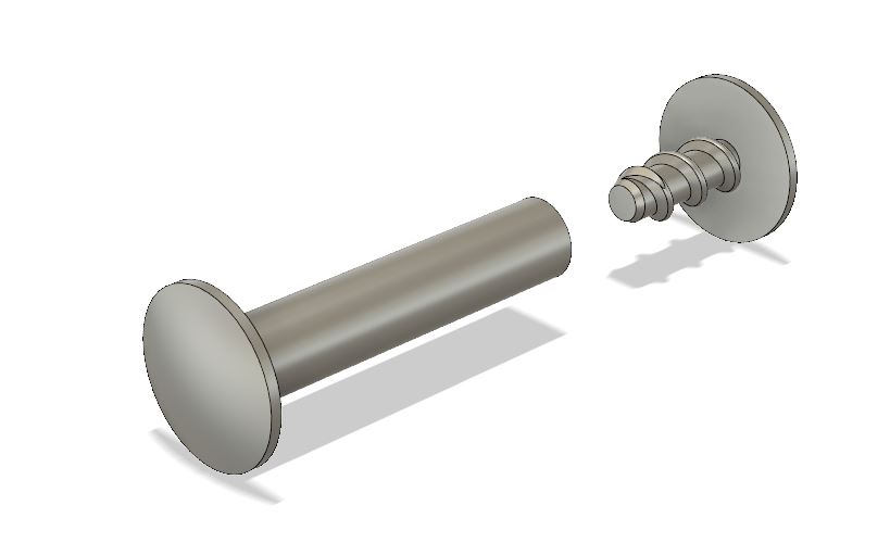

    okay -
    once critical detail, however - and that is hoping to have no drive at either end.

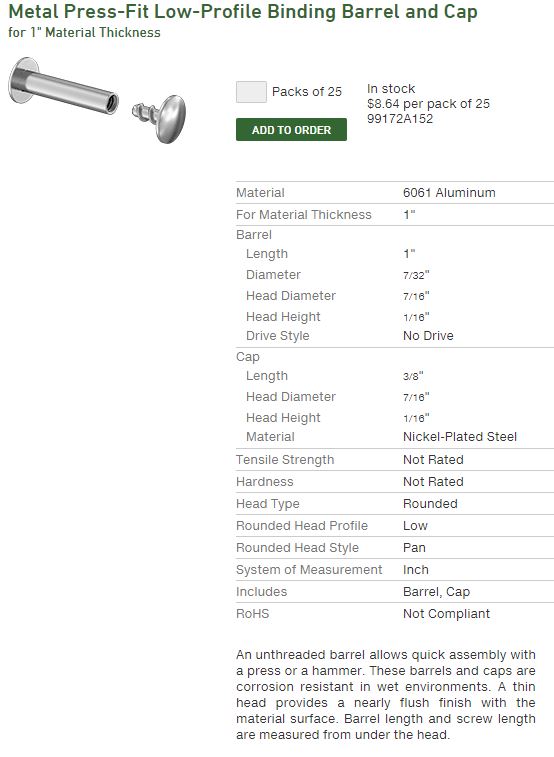

    i came across this binding barrel that is press-fit. but i doubt that'll provide enough tension to hold in place.
    also - if i decide to use a binding barrel with a drive head - i would prefer to be a thin head - but all the heads i looked at are bulky.
    i'm using mcmaster-car / are there any other manufacturers that you can recommend?

    You need to step away from your fixation on a fastener designed for easy use in non-engineering applications, they don't make threaded Chicago Screws without driver slots because they need to be user friendly for their intended purpose, holding together books, material sample swatches etc.
    Use a length of tube with two press-in ends.
