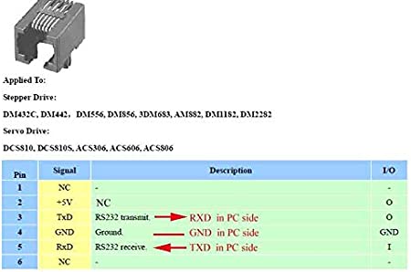

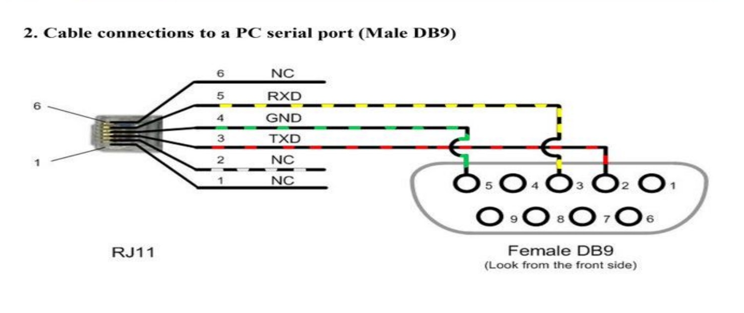

    I have 3 AM882 drives running my CNC and would like to tune them using ProTuner but am missing the serial cable.
    Would anyone have the pinout for that cable? Thanks

    Hope this helps.
