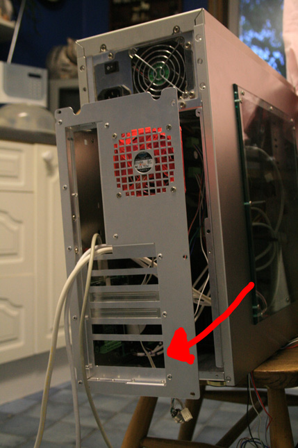

I am trying to put together a control box from an old PC case of mine(drivers, PSUs breakoutboard, maybe even a Mini ITX board). I am almost there, just need some finishing touches.
One of the things I would like to do is to have all the connections going into the box detachable. At the moment I just have cables running straight through the case. What Smiler did here with the plugs on the front of the case is round about what I am aiming for.
However, what I would like to do (just because I am difficult) is to have the panel mount plugs running out the back of the case.
To do this I plan to use two PCI slots. Now heres the problem... I have emailed some companies to get a quote on getting a specially made double PCI panel laser cut out of stainless steel (with holes cuts for the plugs), but because it is such a small part there is a minimum order and its £50. What I was hoping is that someone here would be interested in doing the same thing, and would could get the company to make a few of the PCI covers and share the cost between a few people?

14-10-2009 #2
Email me the DXF for the laser profile's you need and material spec and I will get some cut for you.
PM me your address so that I know where to post them.
Steve.

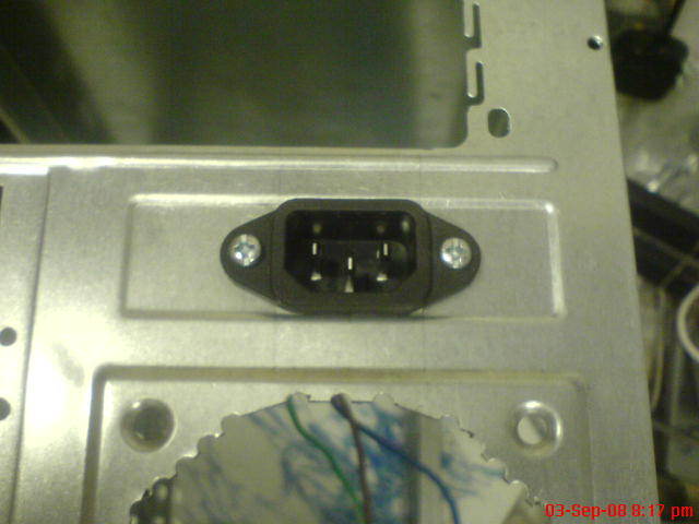

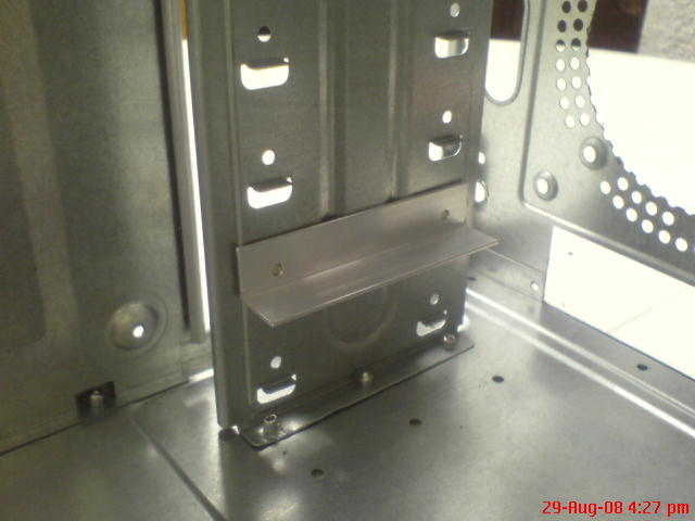

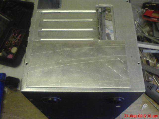

I have done somthing along these lines, sorry to hijack !
.Me
14-10-2009 #5
In the end i had the bob wiring coming out the back and into the bob, the bob then went onto the m/b with no need for a parallel cable to conect them.
Yea i had the PC in the same case, didnt get any problems and i never used shielded cable..Me

Looking pretty sweet Lee! I like the idea of putting the drives and PSUs in the drive bays. You've actually had the PC in there at the same time as the PSUs and the drives going? I didn't really think it would be a problem, but its good to know for sure.

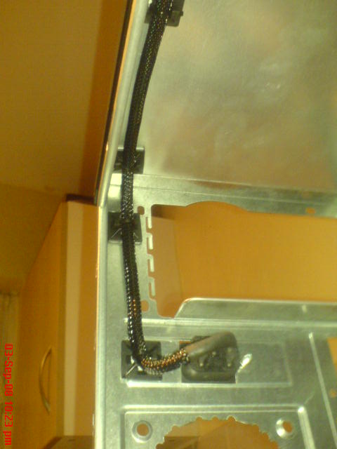

Where did you get the black cable tidy stuff?

14-10-2009 #7
Yo,
yea i was going to post up a build log with all the pics and so on, yea i liked the idea of using the drive bays as well, the tower is sat in front of me now, the plan was to extened the driver L.E.D's onto the front beisel? with fuses and so on.
I was also going to swap the pooh red and green L.E.D's fitted to the case and replace them with clear bule ones, but no never got that far.
Yea i'v got an older AMD based PC inside the case with all the other stuff, didnt see/notice any problems.
The cable brading i got from the USA on 300m drums, dont know how much is left now as i used to sell it on ebay. I know i'v got lots of the smaller size left, they use it for ICE installs and stuff like that on cars.

I have got a load of that 'black cable tidy stuff' as well, got a couple if sizes which should do you, let me know if you need some of that as well.
