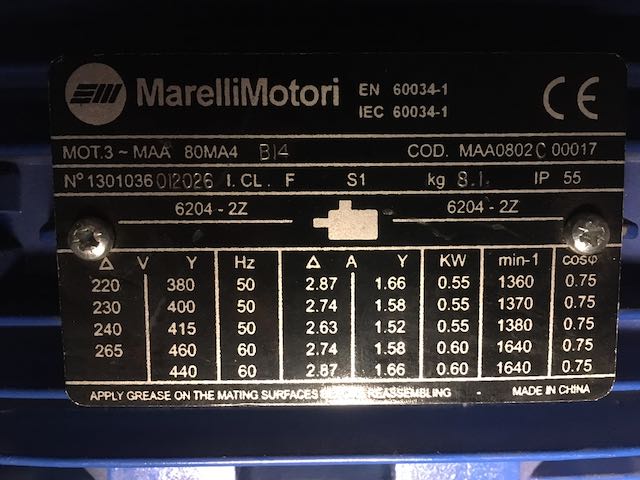

    Here's a picture of the spec plate. Oh, and the VFD is a HY02D223B. Cheers Jazz.

    Erm, I've left my manual for Huanyang VFD at work but I've done enough of these now to know these are the main parameters to check and looked back at a few posts to verify.
    Obviously make a note of the current settings before changing so can set back.
    Pd04 = base frequency so need 50hz
    Pd05 = Max freq so set this to the max you want to run this motor at ie: 100hz wouldn't go above that.
    Pd08 = Max voltage set to 240V
    Pd141 = rated volts set to 230V
    Pd142 = rated current set to 2.74
    Pd143 = # poles set to 4
    Pd144 = motor speed set 1370

    Result!
    As ever I'm in your debt.
    I'm kicking myself for not having spotted the rated current setting. I was mighty surprised that the frequency was set to 400Hz, I just assumed that it would be 50Hz. Clearly the spindle operates at much higher frequencies than the squirrel cage motor and presumably that's how it reaches 24k RPM. I have some motor related bedtime reading tonight!
