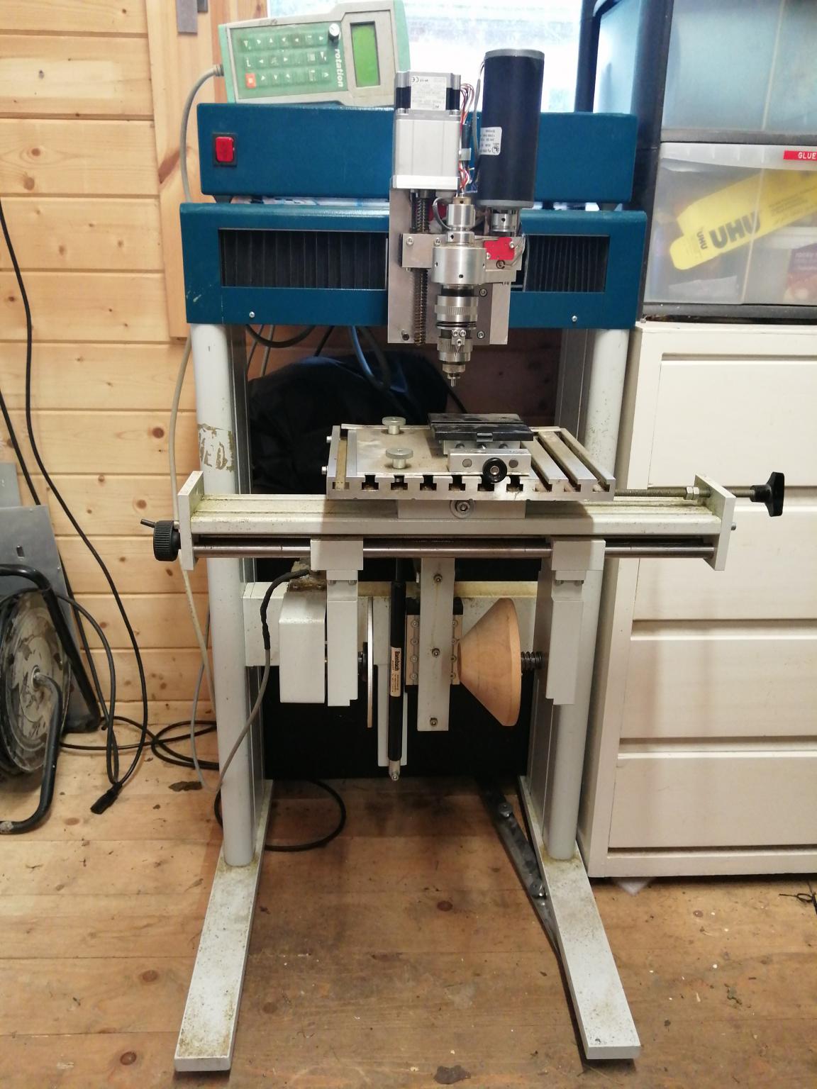

    I have been given a non-funcional Surgrave Rotation S engraver, a well constructed commercial machine, but the controller boards were always a touch flakey and it simply doesn't work any longer. Suregrave as a company have long since disappeared so no help there and as I'm just a hobbyist I'm looking for a low cost solution to getting it working again. I have absolutey no experience with CNC machines but I do have a very good workshop, experience with putting electronics together and a great deal of patience and persistance!

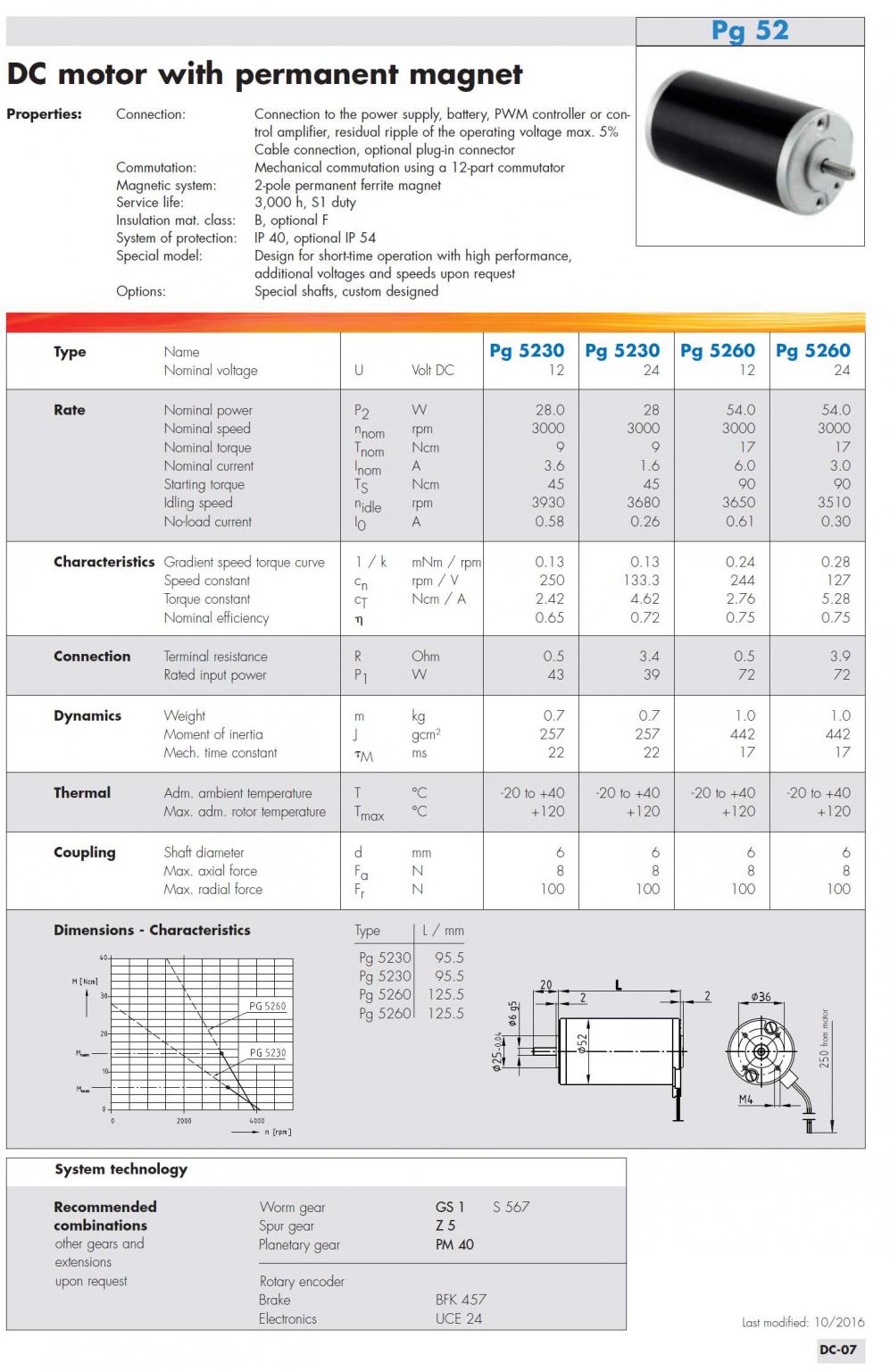

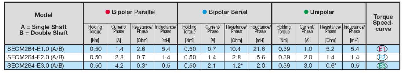

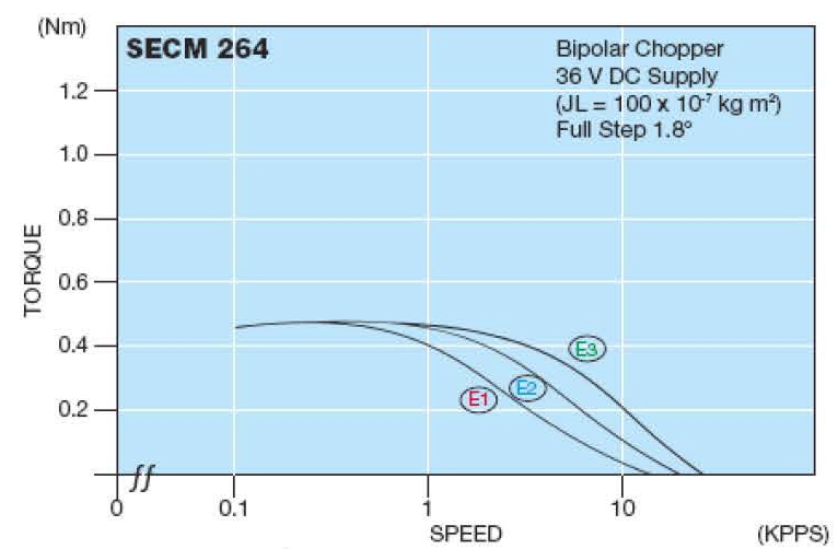

    The engraver uses ECMotion SECM264-2.0A stepper motors and a GEFEG 24V 17.4A 12000rpm spindle. The steppers are rated at 2.8A in bipolar parallel mode. Details of the stepper specs are shown below. I'll be running the system via a Windows 7 laptop with USB2.

    Photo of engraver, it's fairly dirty, haven't got round to cleaning it yet!

    Regards the Drives then most drives will run those steppers but you will need to decide on the voltage you intend to run them on. These would be a good choice for those motors and run them on 40-44Vdc. The PSU in your existing controller may be usable but without seeing it then can't say. Many of these types of bespoke control systems use AC transformers and then Rectify to DC on the control board it's self. You may be able to re-use the transformer and just add a bridge rectifier and Caps to give the DC voltage you require.

    Now comes the potential fly in the ointment.!! . . . . That spindle motor looks like a brushed DC motor so it will have a Brushed DC speed control drive. You need to identify the control board and see if it can be re-used and what type of reference voltage it requires. Many of these types of drive require an Isolated speed reference voltage and if you get it wrong will easily damage any board supplying the reference voltage not mention they often working at mains potential so can be lethal if you are not sure what you are doing and stick your fingers in the wrong places.!!
    This needs careful examination and it may mean either a new BDC drive or replacing the whole spindle and drive with something different.

    The power supply within the existing engraver controller is a large toroidal transformer with a rectification and smoothing circuit board. I've checked the outputs and it provides 36V for the steppers, 5V for controllers etc, and 24V for the spindle. All works fine and I don't see any need to use anything else. I'll post a photo tomorrow.
    The spindle spec sheet is shown below, the one installed is 24V brushed dc, but it's rated at 17.4A. Needs a PWM controller I presume but I'm not sure what to go for. There might be a PWM circuit in the existing controller but I think it's part of the stepper driver board, which is completely unmarked as to what each connection is, which is a bit of a bummer as I might have been able to use it. From my discussions with Mervyn White at Microwhite (he's a Suregrave guru) the main controller boards were somewhat unreliable and not capable of being repaired. More tomorrow!

    Regards the speed controller then you will need something that can accept 0-5 or 0-10v analog input for the speed reference because I don't think the Axbb provides a PWM output, I could be wrong so ask CNC drive first or go to there forum and ask.
    You can also get BDC controllers that have stand-alone PWM built into them and control the spindle speed with a Pot.!
    To be honest I don't do a lot with BDC controllers as Brushed spindle motors are not common on CNC machines these days.
