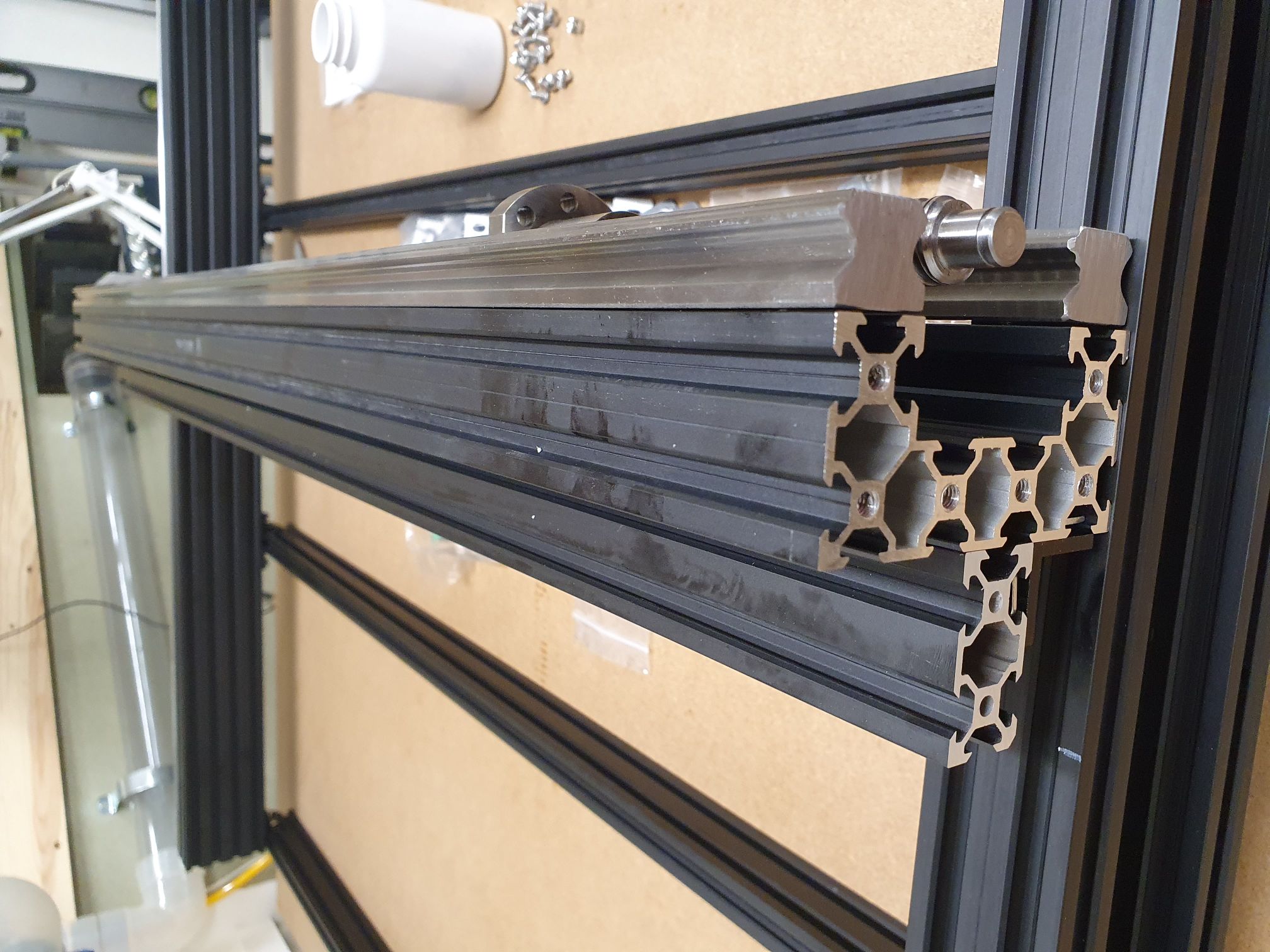

I will make use of most of what i have - but the ball screws are to short and will cause an issue as they are the exact length of all my profiles.
Were as the others are oversized generally by 40mm or greater to allow them to pass through the plates and be secured.

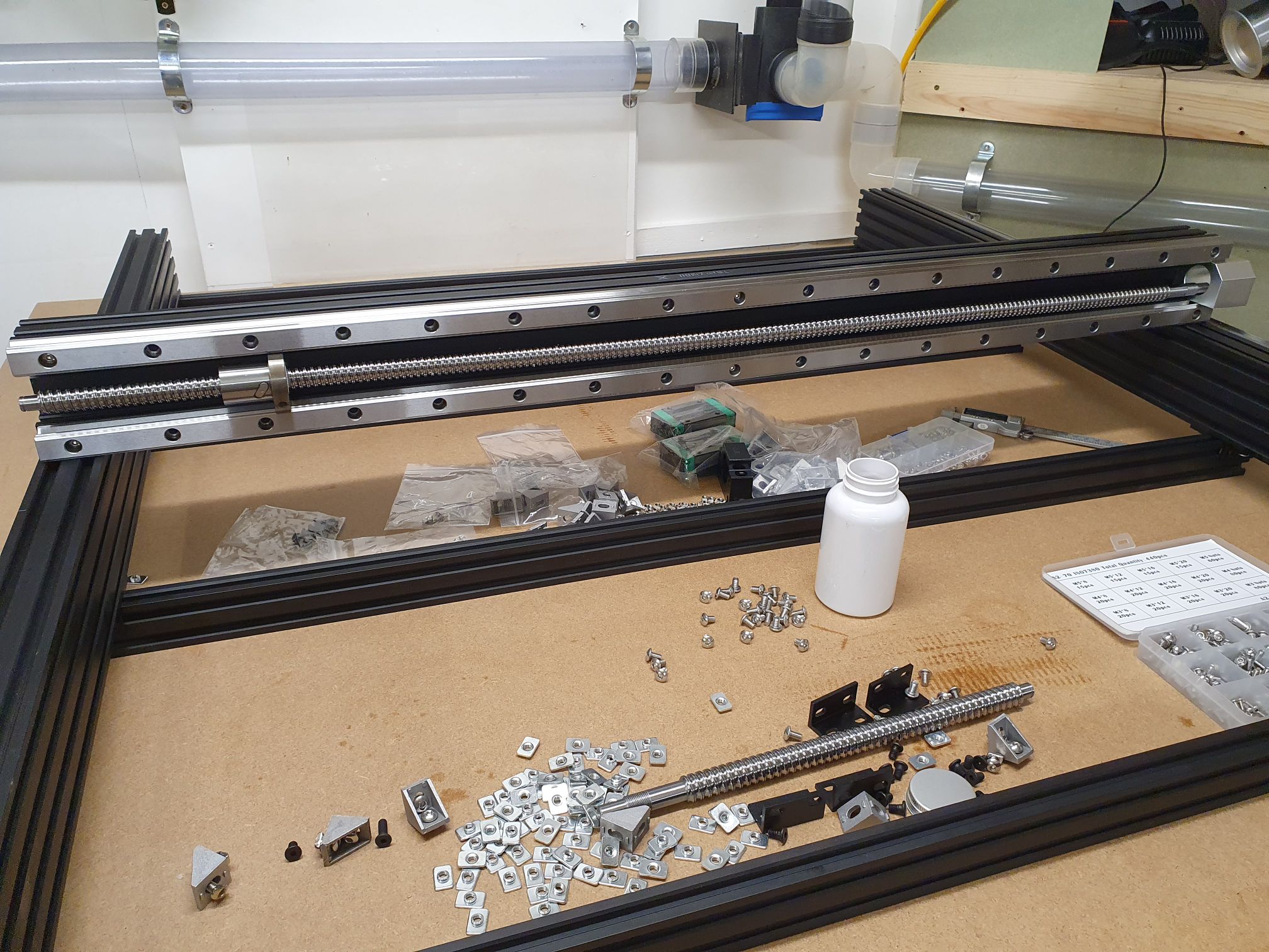

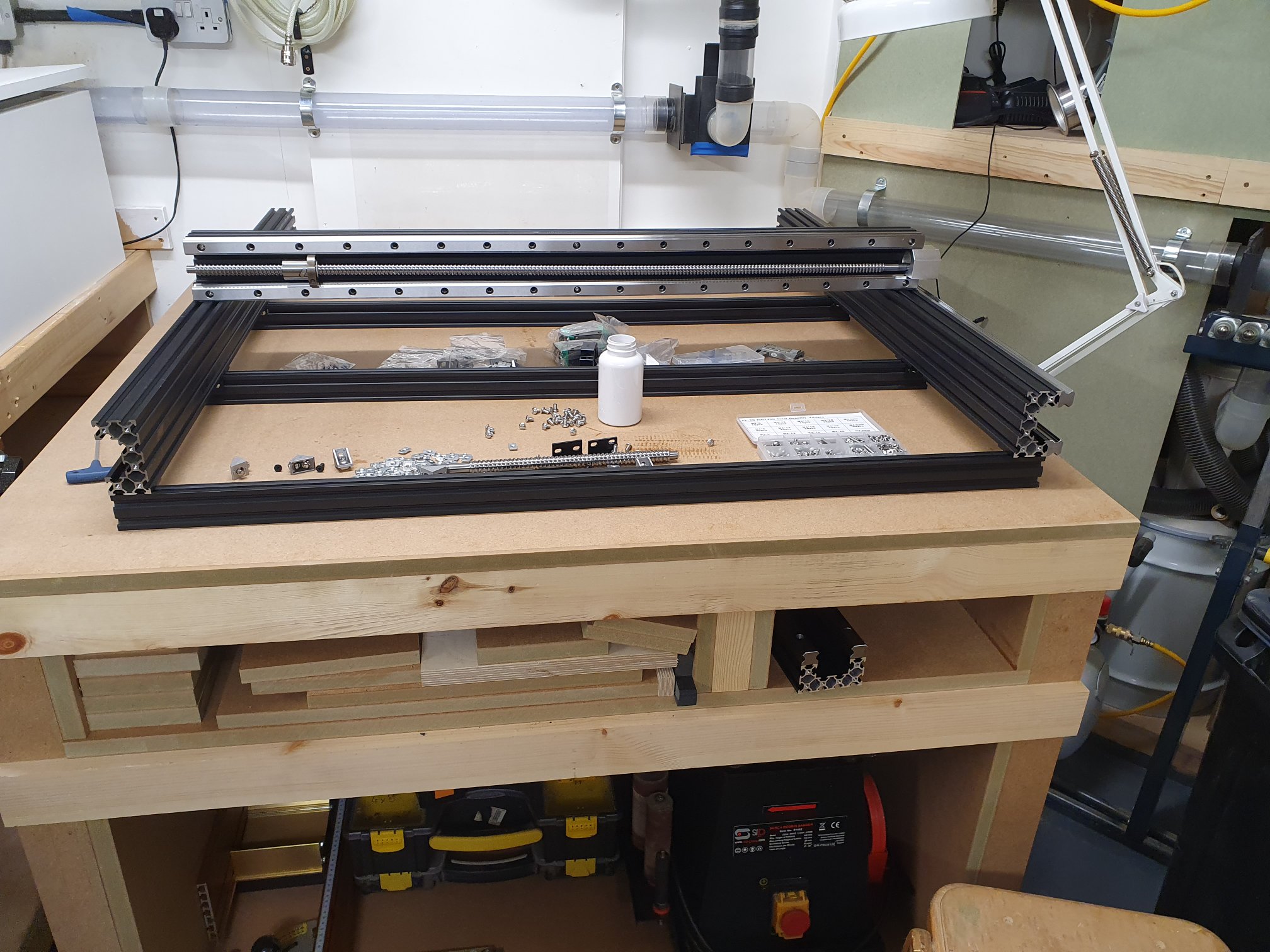

OK, open to suggestions - i did have an idea!! an outer plate and an inner plate - how the bloody hell i was going to make them though?
All my extrusions are exactly 1000mm
All my linear rails are exactly 1000mm
All my ball screws are exactly 1000mm
You kind of see my problem - i can understand how the 'linear and ball screw kit worked - but it was never for my profile of extrusions!!
To be fair (as I like to say!) why would i not assume that the ball screws would be longer, they are when you buy them separately

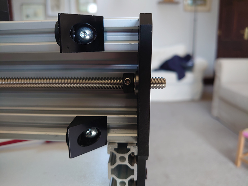

Oh, I see. Well, those extrusions are in my opinion far too weak. I was hoping that you at least use 40x80, but those you went for, I see as 20x20 C shaped. Maybe suitable for some very small, light machine with a small DC motor as spindle, but not for a machine of the size and type of use you are aiming at, even if you'd only work with soft wood, I think that would cause you more pain than joy when using it. I think at this stage I'd byte the bullet and start over, trying to reuse the strongest parts (rails and ball screws), not the weakest ones (extrusions), but in any case, I think it's high time to start sketching on paper or in a computer.

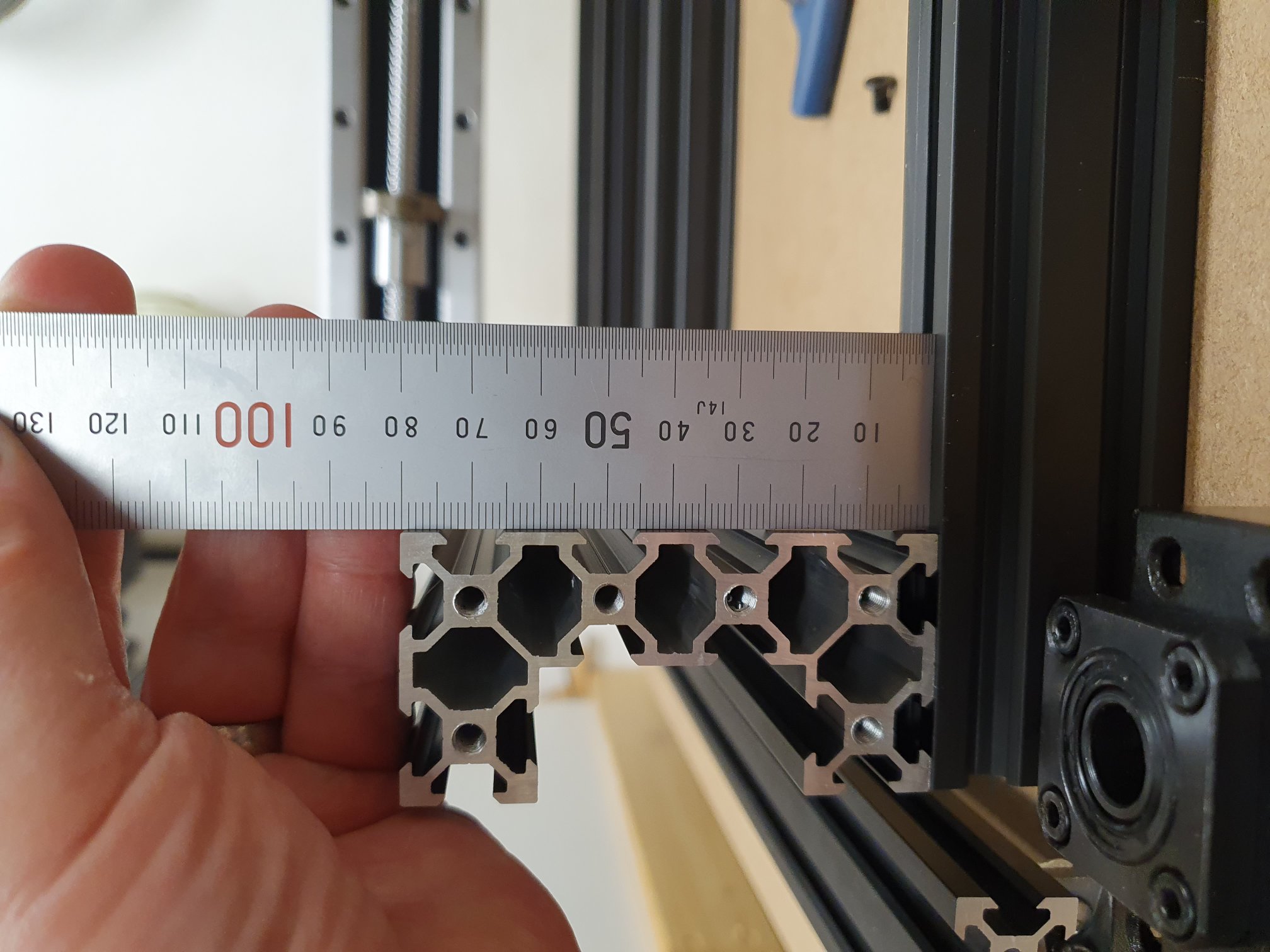

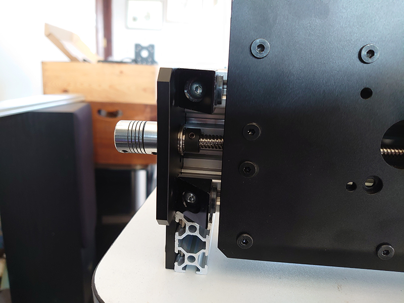

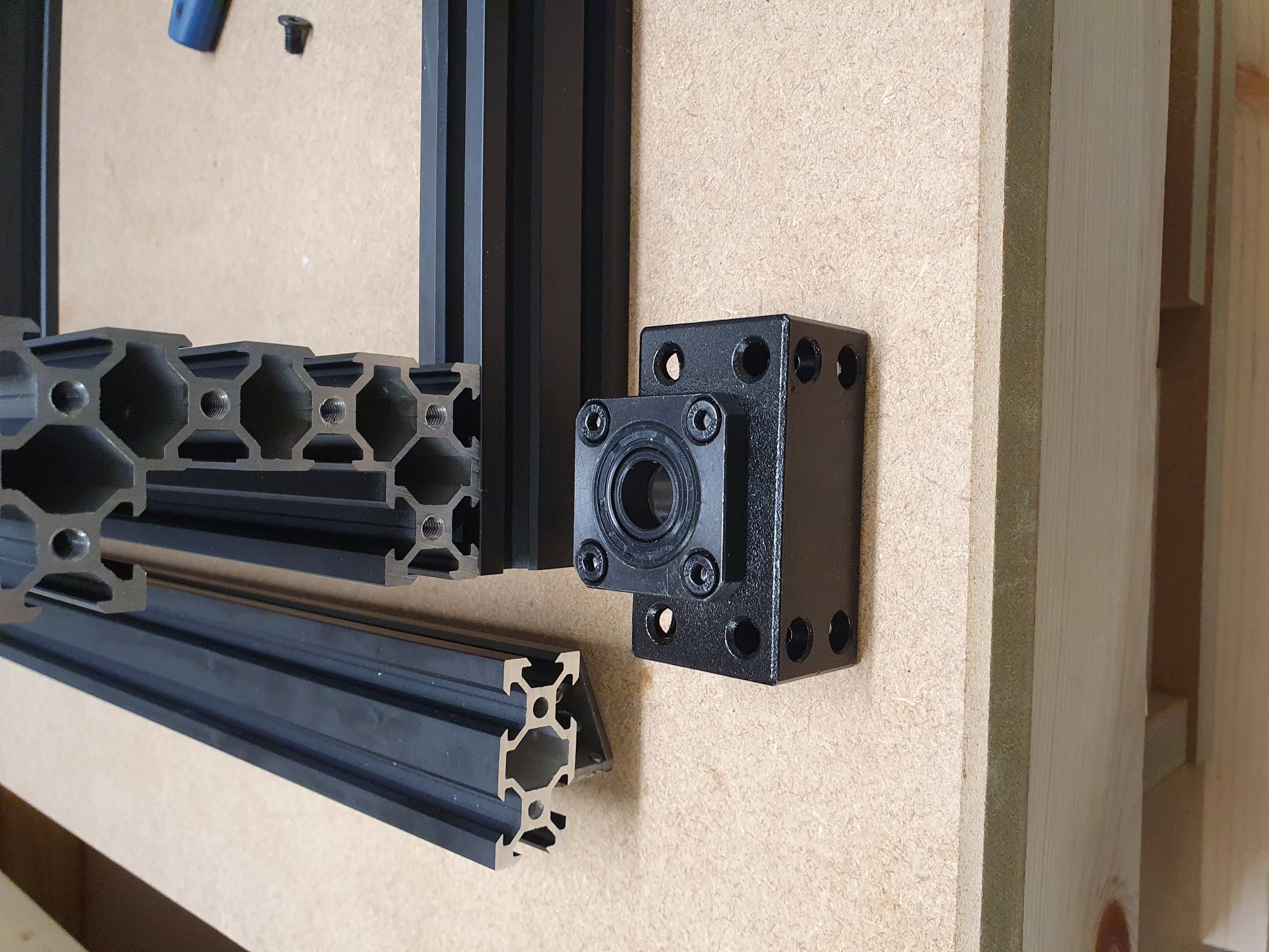

We need more details.
What profile are the extrusions?
What size are the rails? 20mm?
What size are the ball screws, what type of ball nut is fitted, and what support bearings are fitted?
Either links to what you've bought, or some photos will help us provide suggestions.Avoiding the rubbish customer service from AluminiumWarehouse since July '13.

I actually don't see the problem with those lengths. With those lengths you can indeed get the full length movement, which is 1000 - 160 = 840mm. There is no such rule that screws must me longer than the rails. As I said before, it depends on the design, but you always lose at least as much as the carriages take (normally more) so why would there be a problem? The 1605 should be machined like this:
Attachment 30161
So from the full 1000mm you lose 11 + 39 + 15 = 65mm which means that you have 935mm movement and that is more than enough for your 1000mm rails. ...but you can't build that on a single 80mm wide extrusion, so you have to come up with a better solution. Anyway, we need more details, MUCH more details.
If you absolutely want longer screws, one solution is to cut off a bit of the rails. The length is easy to shorten, just use an angle grinder. But like I said, it isn't necessary to have longer screws at all.

OK, I have read everything that has been said so far!
All the machines that I have seen, watched, use this profile, on wheels, no rails, many belt driven and they knock out some nice stuff.
I know that you have all said they flex, so how are they managing it. Many make 1500mm x 1000mm machines from this stuff!
I thought by putting some HGR 20 linear rails on, that would introduce a lot more rigidity into the build
Most of the upgrades that people are doing is that, but often using 12mm rails and occasionally 15mm rails.
Most are still using 8mm Acme ball screws, I went for Rm1605, so twice the thickness.
Yes, I have seen the issues with long 8mm screws 1500mm long, I believe you call it whip or something else?
So I have exactly 40mm to play with between the rails, less the HGR20 carriages.
