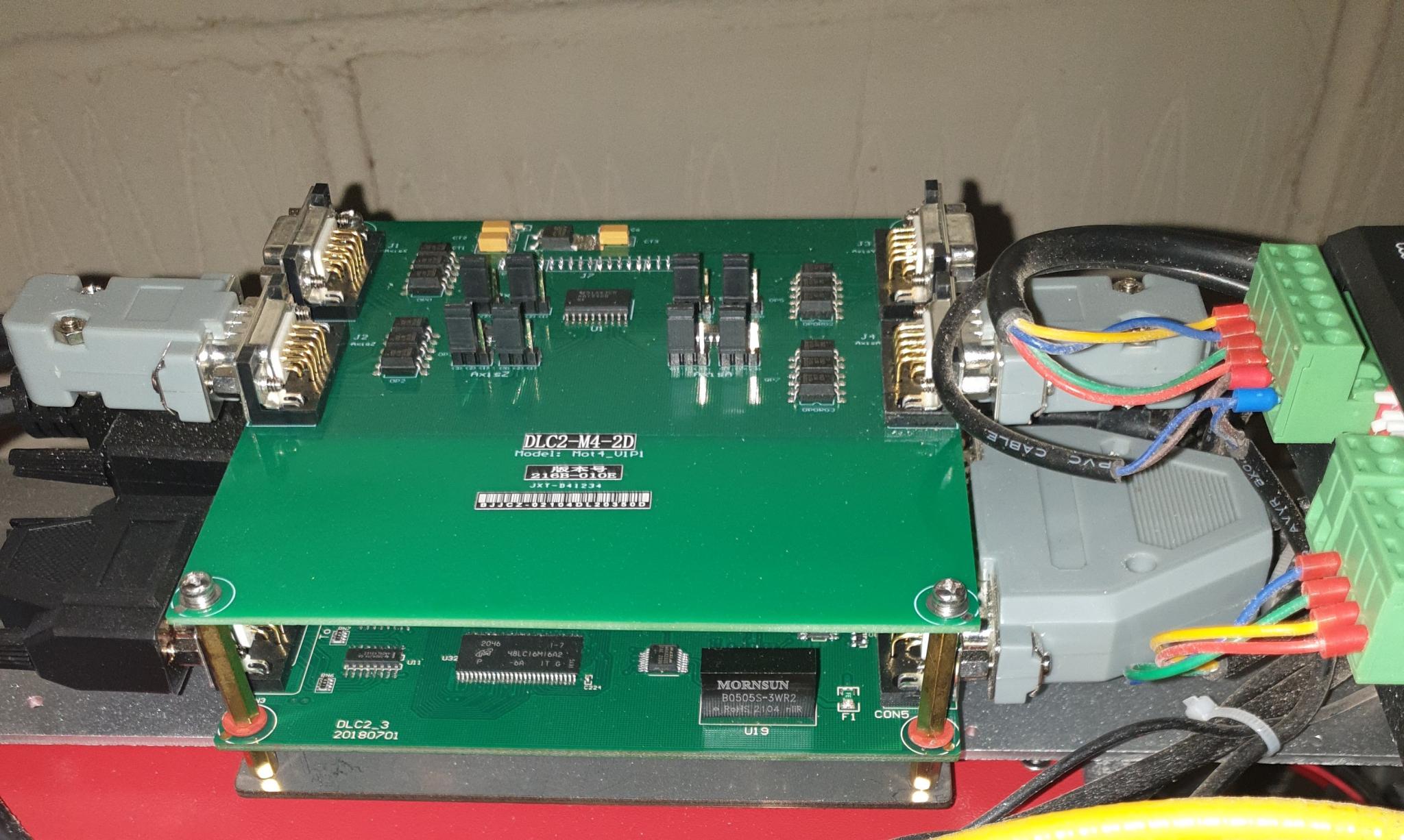

    The fiber laser has a board called DLC2-M4-2D which is a 2 board connected with pins. The top board is a controller for X,Y,Z,A axis (can drive a Z axis, a rotary axis, an XY table and all the combination between). The bottom board is dedicated to run the laser head itself (2 small servo motors connected to 2 mirrors to steer the beam and stop it and start it depending the user design).
    The top board is a step and dir controller and is connected to a stepper motor which operates the Z axis
    I also have a device (with his own stepper driver) which has a measuring sensor for the focal distance (different lens have different focal distance) and this device needs to use the same stepper motor on the z axis.
    This was my question: how can I change the drivers (safely) to use the same motor when I need to use one or the other device?
    Thank you
    Gabi

    I assume you are manually selecting between the two devices rather than using both systems at once. Then I would suggest using a single driver with step and dir inputs switched as previously suggested but use standard logic gates to do the selecting between sources, possibly with optical or other isolators on the inputs to keep the grounds of the two boards separate if required. Power the logic and provide it's ground from the same board that powers the driver.
    This way you could avoid any contact bounce on a mechanical switch and remove the need to common the logic grounds of your two boards. The enable line (if used) could also be buffered/switched/maintained during the changeover by your logic if required.

    I am sorry but I have no diagram. Anyway, it is a simple circuit with one switch and a relay which flips the step, dir, en and gnd signals, all four at the flip of the switch. The circuit is really simple.
    I made a simple sketch and scanned it for clarity.
Name:	UCCNC - Lathe switch.jpg
    UCCNC generates the pulses if I flip the switch and select it, or the Arduino box if I select the lathe mode. The servo is a servo with integrated driver, but it could be a DM542 also, it makes no difference as long as the step, dir, en and the gnd can be used to control it. The relay in my case is one I had in my drawer, if you can't find one which switches all the four signals at once, you can use two, or even four separate relays as long as you switch all at the same time. Just connect the coils in parallel and you'll be fine. Of course, as I said before, it assumes that both controlling devices work independently and you don't need to rely on exact positions between each devices. In my case, I don't care where the motor stops, the lathe accelerates and decelerates to a speed I want it to, and if I use UCCNC then I have to zero the position for UCCNC, so the position is lost every time I flip the switch, but for me that's perfectly fine.
