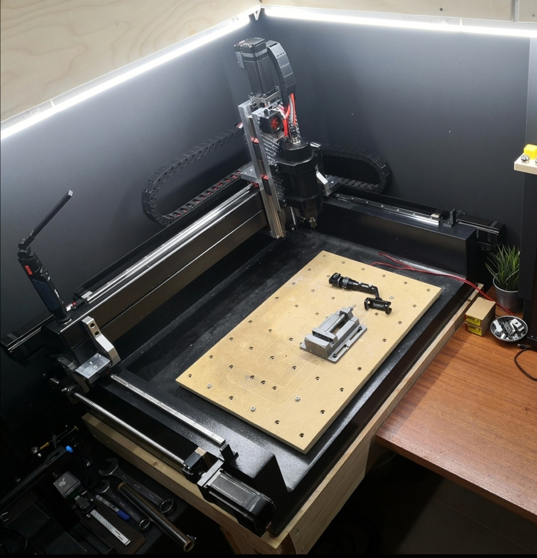

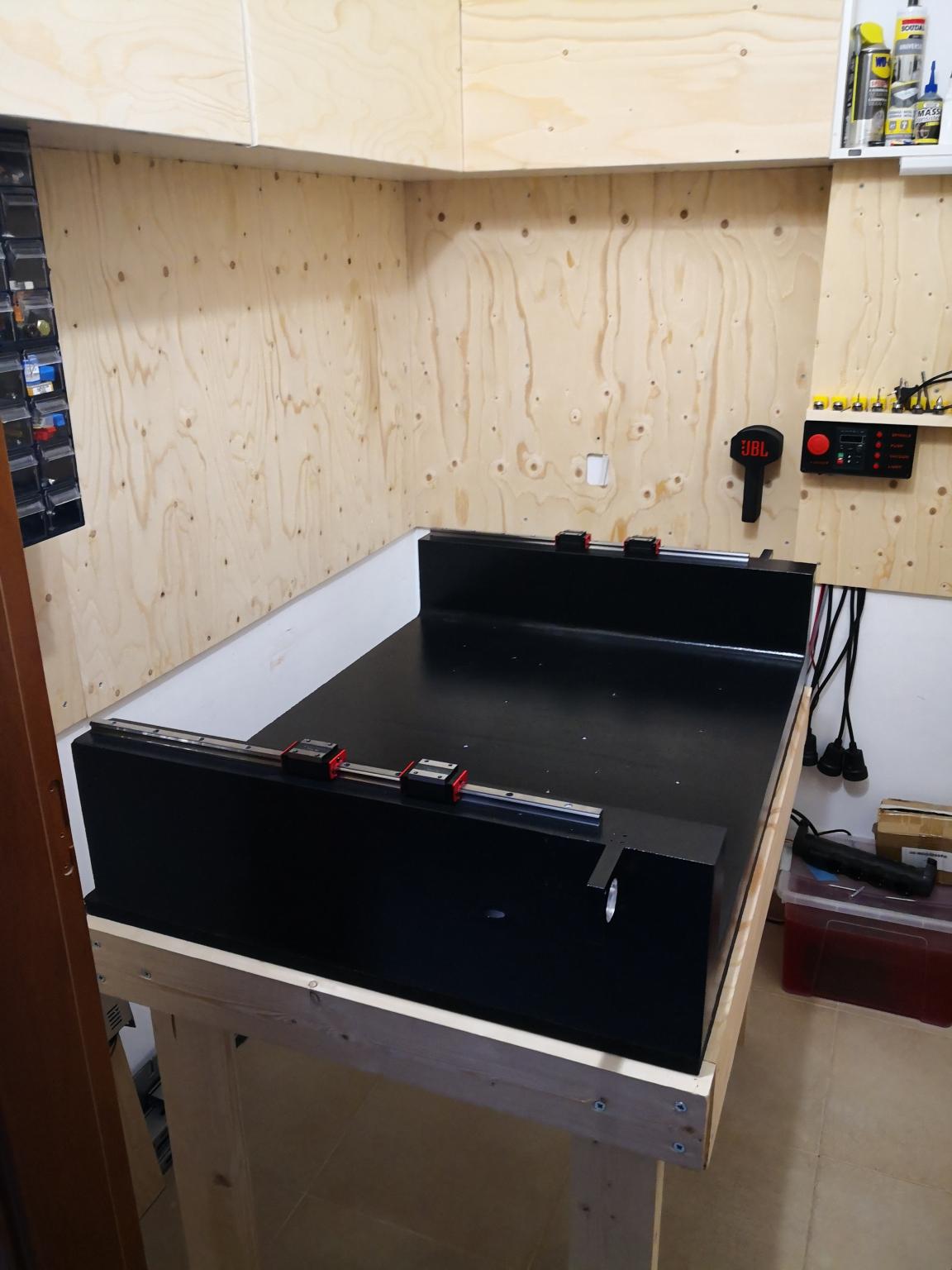

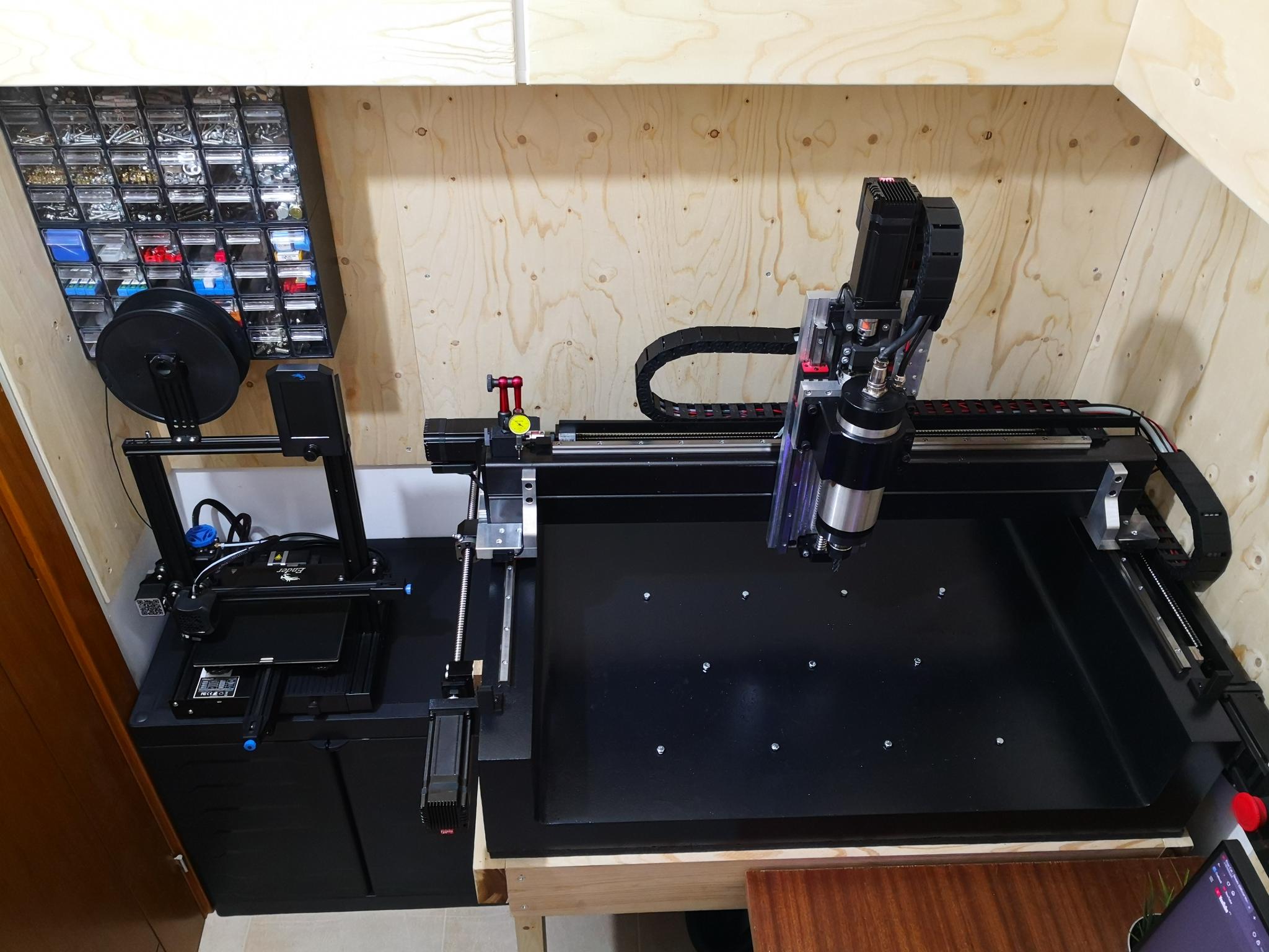

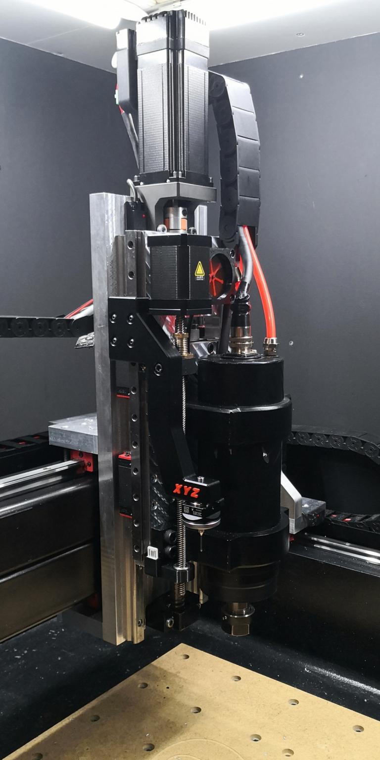

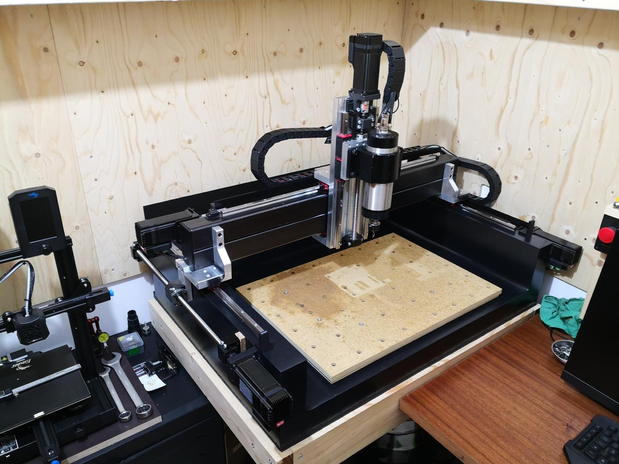

    Hi all, This is my small build. Base is made of structural concrete and the rest is just some steel box tubing for the gantry and some 20mm aluminum brackets and plates. Nema23 3nm closed loop steppers, ballscrews etc...
    Work in progress...

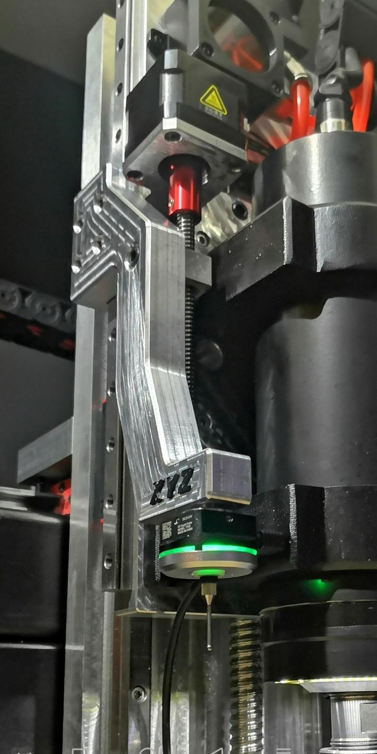

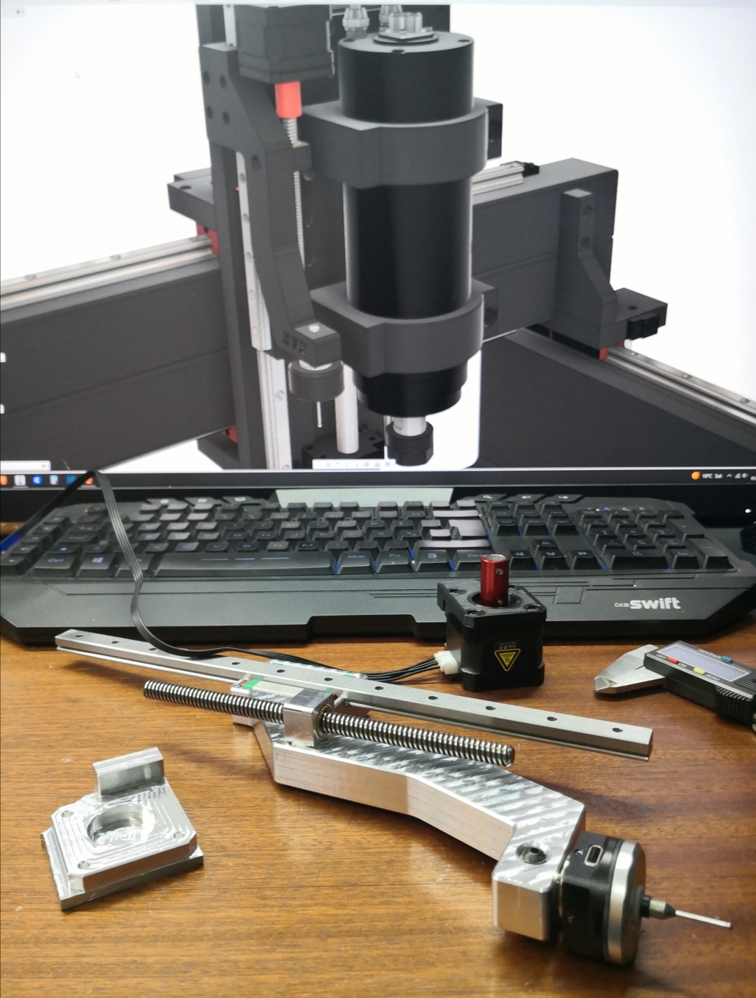

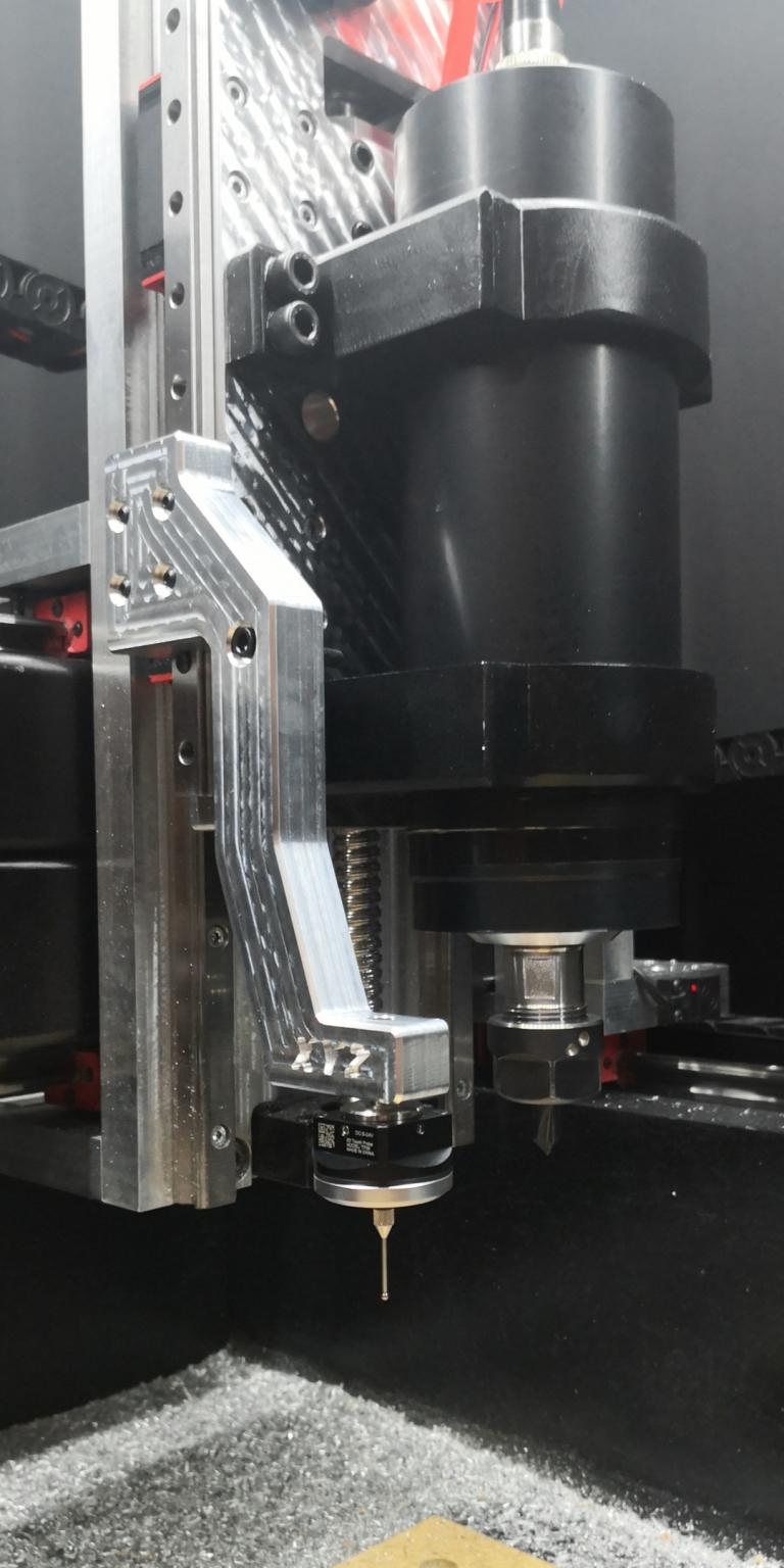

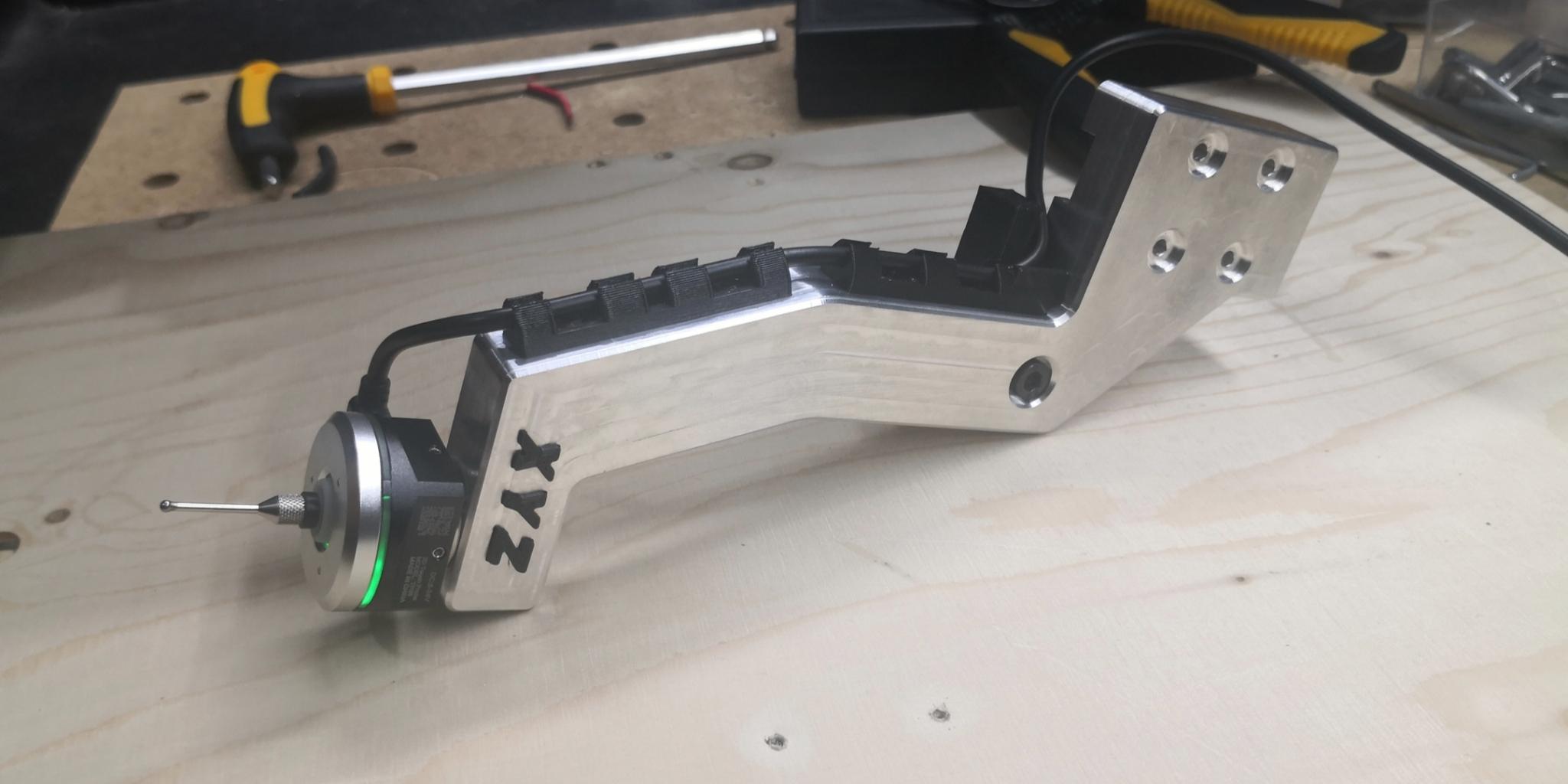

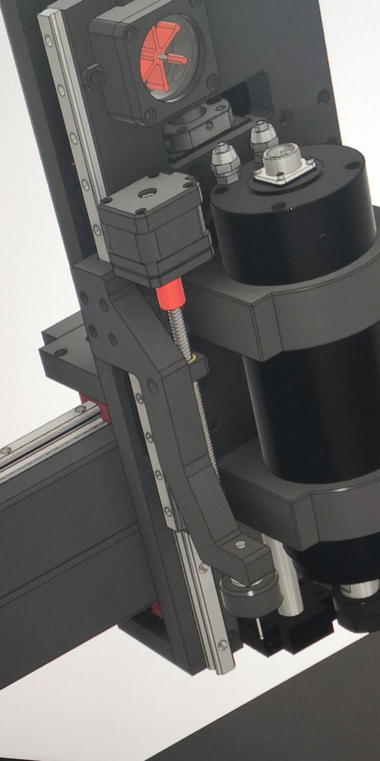

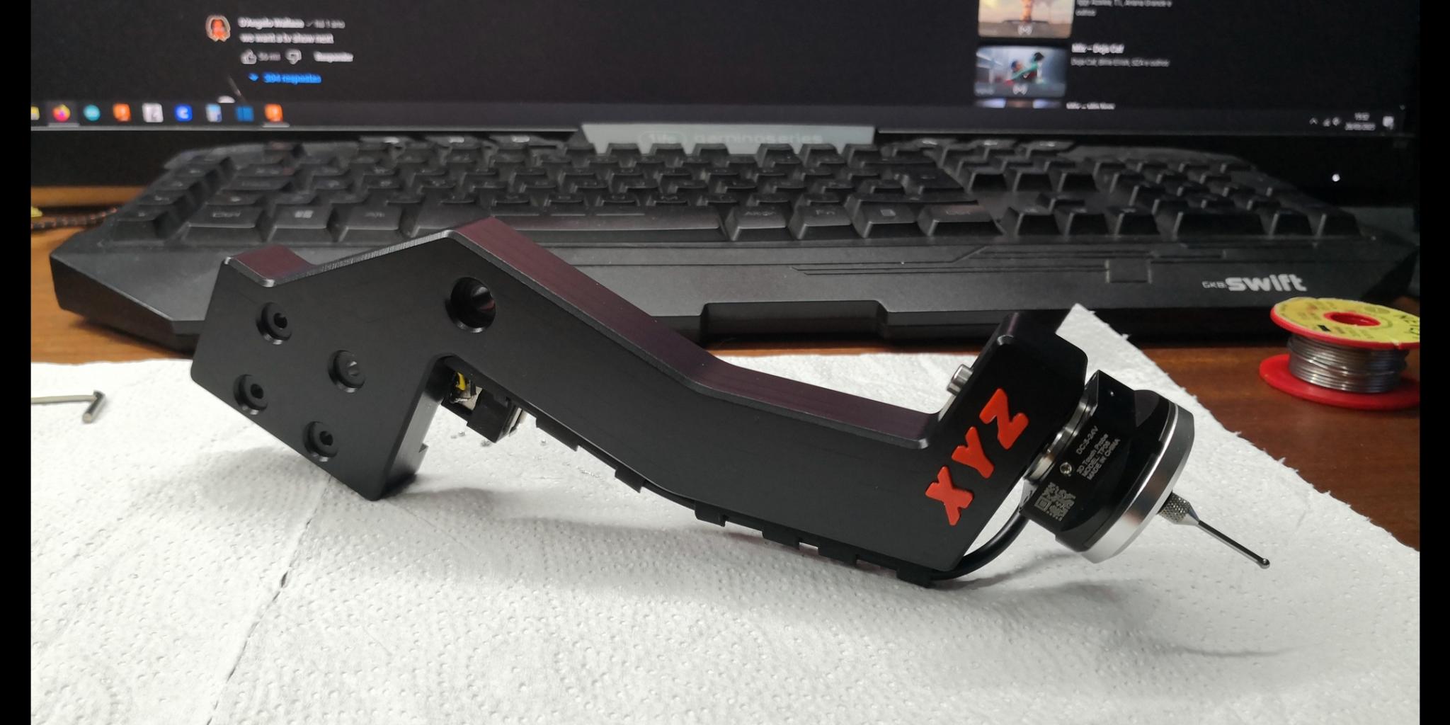

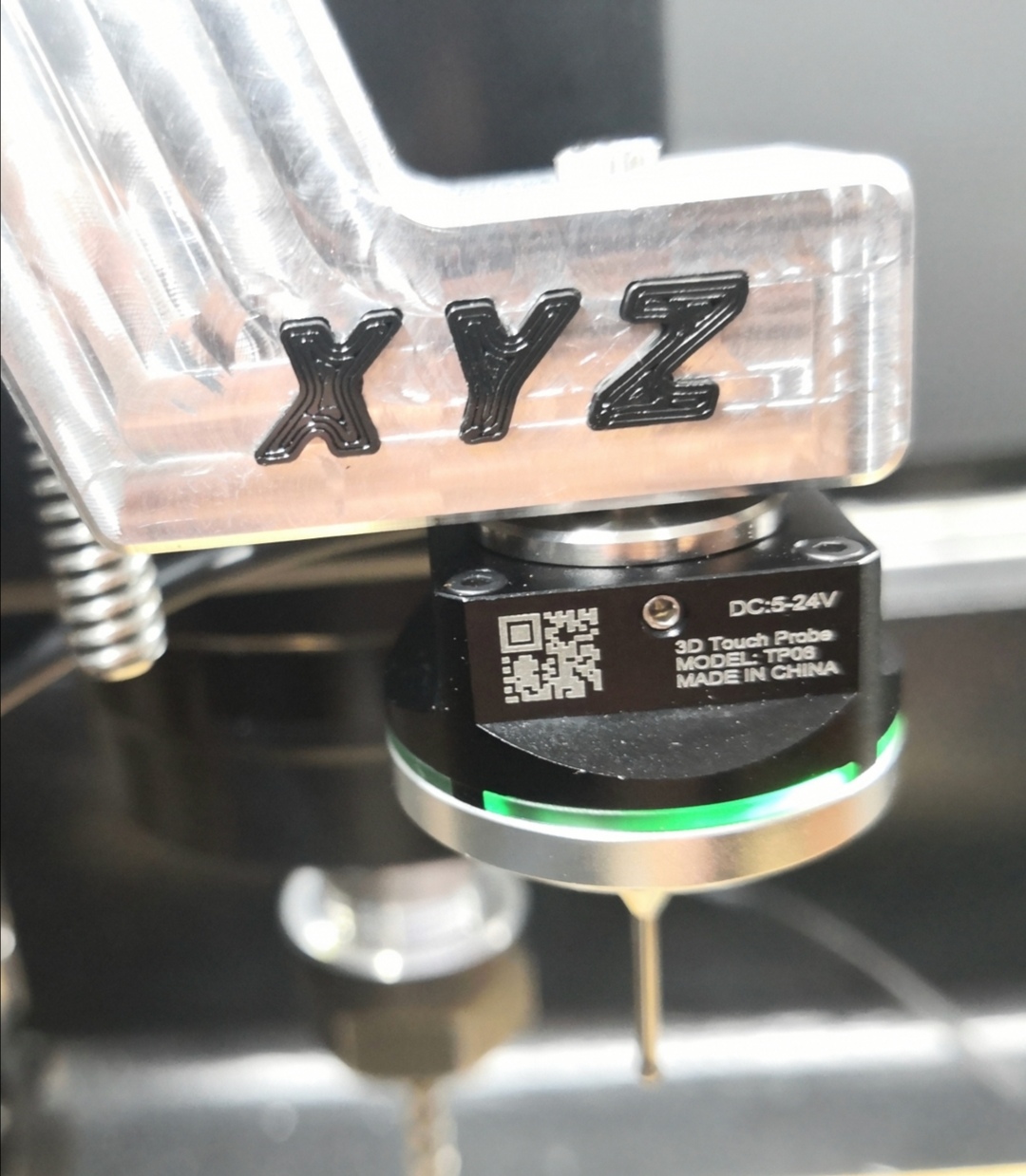

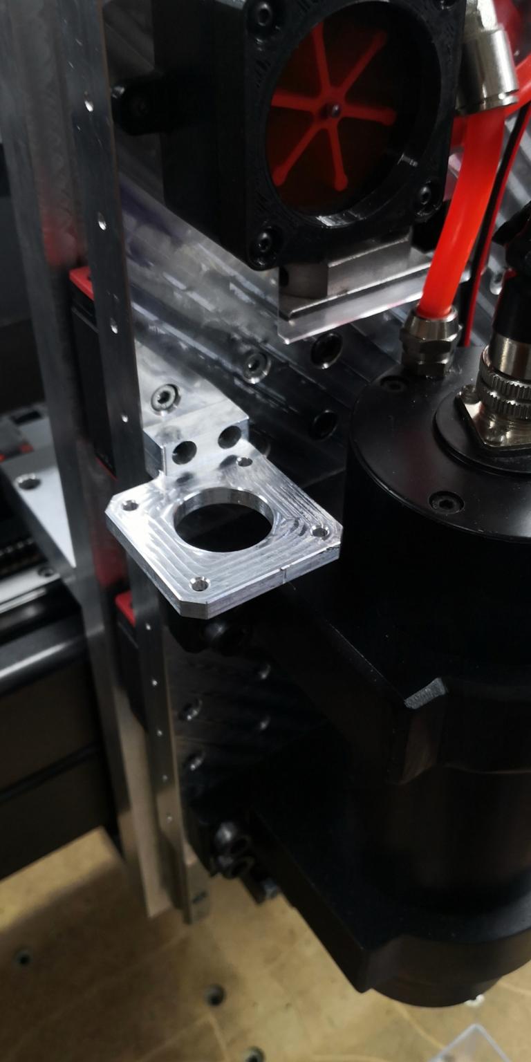

    Hi all,
    New part to upgrade the machine and improve rigidity.
    Hope this video has a bit more quality.

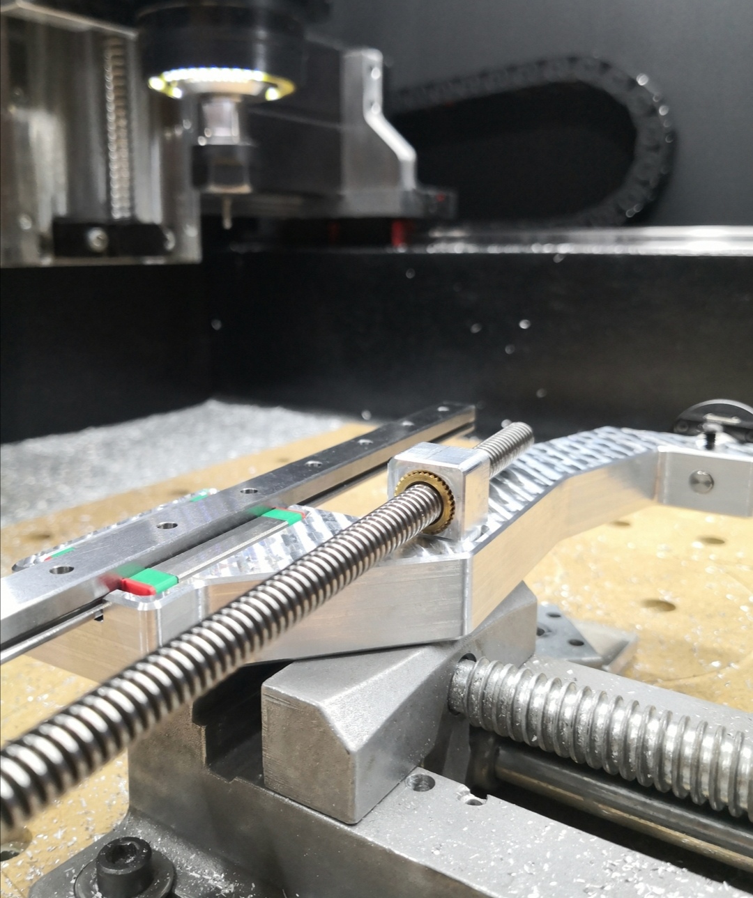

    Wow machine looks great ...

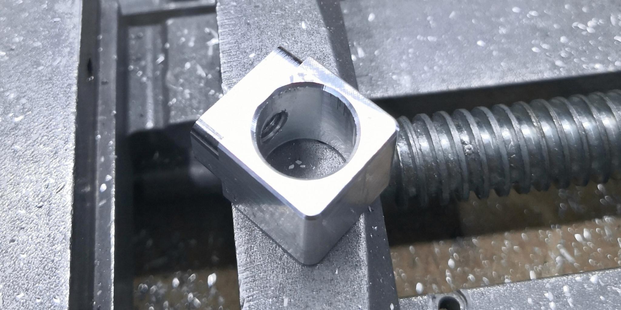

    ...as do the parts your making, what machine did you use to make those? I will sub and watch your videos later :)

    Would you like to share the aggregate ingredients, % of all ingredients and the type of resin. I also want to build , i am almost done with the design but i am looking for proper aggregate now. Thanks !

    Hi Lee, thanks...
    All the parts were made by this machine. It has evolved over the last year... It all started with a 3018 from aliexpress lol

    Quote Originally Posted by masinecc View Post
    Sure... It's not epoxy resin. It's structural concrete with internal steel reinforcements (the same concrete used in bridges, etc).
    So far so good.
  8. #7
    Quote Originally Posted by XYZ_Spec View Post
    So far so good.
    What min and max sand size ?
  9. #8
    It's already done for you inside the bags.
    Pre-mixed, just have to add water
  10. #9
    Hi Lee, thanks...
    Understood, I went on to watch the vids after I posted, looks good :)
    Still what one did you use the finish looks really smooth, any tricks to that ?
    .Me
  11. #10
    The mix is done with fine sand, that's why the finish is not rough. Applied primer, sanded a bit and then painted it. It's not that perfect, but the performance is what matters at the end. :)
