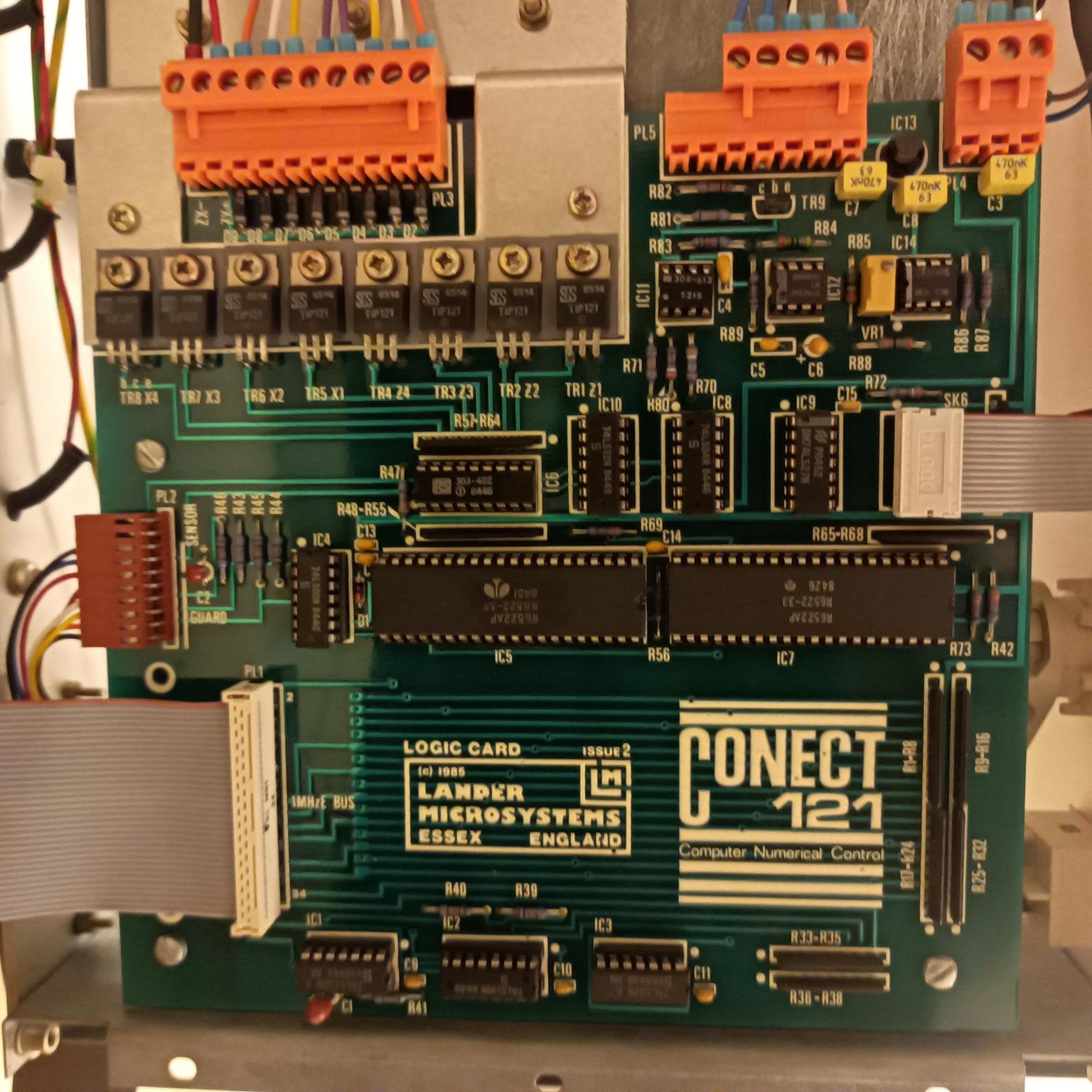

    I picked up one of these today and plan to get it running for hobby stuff.
    I will post some pics during the week but it looks pretty much unused and came with 2 original manuals, bbc computer, control box, monitor, 5 1/4 floppies etc. I don't need to do anything particularly exciting with it and it will probably live at the school I teach at as a training / demo machine only. I do want to be able to cut threads.
    Last year I built a cnc plasma using axbbe board and uccnc control software so I have some knowledge although it's fair to say I am good at following instructions rather than fully understanding the electronic principles behind it all.
    I want to get this running off of modern software though and ideally (similar to how I run our cnc mill and my plasma) produce code in Fusion 360.
    Ideally I also want to be able to use this machine semi-manually, i;e control spindle speed and axis movements from switches.
    The spindle motor is a 0.37kw GEC 180v dc motor (I assume original).
    My initial thoughts are to use a chinese 400w panel mounted motor controller for speed, and a couple of Nema 23 closed loop steppers for the axes. One thing I am not clear on is whether the spindle needs to be controlled? I appreciate it needs to provide accurate speed via the optical encoder for screwcutting but is that information used to position the axis or also to tweak spindle speed?

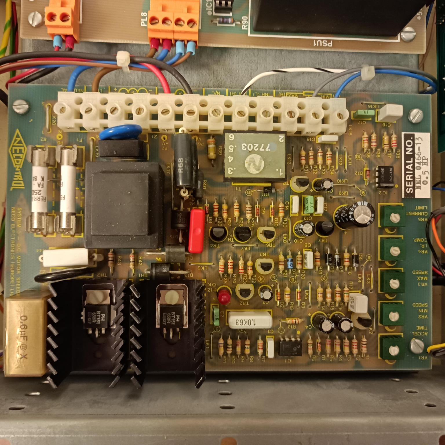

    How do I go about using the original spindle drive? I believe it was controlled by the computer and not sure what I need to do on the control board to mimic that...Click image for larger version.

    That's the early system.
    The spindle drive board (in your first picture post), should have everything marked on it.
    As it's a NEControl, I'm not sure if a manual will be easily found, but some google searches might turn up something.
    The only unknown will be what the inhibit (white/black wire) gets switched to. I'd trace that wire, and see if you can work out the circuit it connects to.
    As it's connected to Inh (H), I suspect it'll get 5V applied to it to inhibit (disable) the drive, with 0V connected to the speed control L.
    The grey and blue wires will go to a circuit that outputs 0-10V (or possibly 0-5V - you can measure the voltage between the L and H terminals, which will give you an idea) to set the spindle speed
    Does the original computer power up?
    If it does, it would be worth measuring the various voltages, as it'll help eliminate guess work.
    It would also let you test the spindle drive, as SCR drives do have a habit of the SCRs failing causing the supply fuses to blow.
    It's also worth measuring the voltages on the power supply board (Second photo).
    If it's anything like the later board, it'll output ~24V for the stepper drivers, and 5V for the control, as well as providing a pass through for the spindle supply.
    Although I'm not sure what the big plastic box does. Is that where the wires from the spindle drive board connect?
    If so, it could the isolation circuit.
