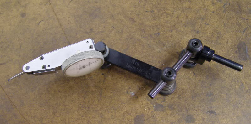

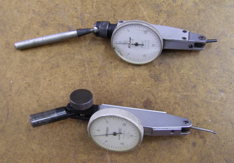

    Hi, I'm looking for a dti to use with the mill and have found some with just the dial, and some that come with magnetic base clamps. I was thinking it would be useful to have one with some sort of swivel mechanism that can be mounted to a mill but don't know what they're called or where to find them. Everyone seems to be at the show this week so can't find much help either!

  2. Have a butchers here.... http://www.arceurotrade.co.uk/Catalo...al-Gauges-DTIs they seem reasonable. your you could got for a more expensive one like a mitutoyo but that will cost you around £80
    What type of mill are you using? Vertical, horizontal, or universal?
    If you're using a vertical mill, then the DTI in the foreground of your DTIHolder1 pic can be used in an ordinary 3 jaw drill chuck (assuming you have one) and is a sufficiently quick and accurate way of clocking a vice for example, or other work with a reasonably smooth datum edge - just don't, whatever you do, overtighten the chuck (I've seen people do all kinds of silly things like that). The chuck only needs a light grip on the clock holder.
    If you are using a horizontal mill (ie, where the drive arbor / spindle lies horizontally), then a plunger type DTI on a magnetic base may be a better option (clamp the magnet to the machine body, with the plunger on the workpiece / vice parallel etc.
    Hope that helps, just yell if you need clearer explanation, and I'll get back to you.

    Vikash, take a look here: http://www.engineering-supplies.com/...s-drop-clocks/
    eg: http://www.engineering-supplies.com/...ck-dti-holder/
    I'm looking for something similar, I'll let you know if I find any more :)

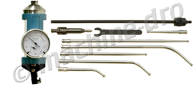

    Thanks for the replies. I think a Coax indicator would be useful, something like this: http://www.machine-dro.co.uk/index.p...product_id=295
    Thanks for the replies. I realise what I was looking for now is called a coaxial indicator.
    For ref, I have a Sieg X3 with chuck, and recently a rotary table.
    I bought one of these from Allendale Electronics. I've pretty much discarded the Chinglish instructions and just having a play with it.

    My only gripe so far is that it shows ~0.01mm movement without a probe attached. Is that a defect or to be expected?
    You turn the outside of the dial bezel to align up the zero mark.
    Bogs
    I mean it registers movement of ~0.1mm as the spindle turns. i.e attach the indicator to a chuck, don't attach a probe and switch the mill on low speed - the needle moves as much as 0.1mm as it revolves.
    I'll have to check again, but I think the needle jumps at the same position during rotation, which I think is therefore a defect.
    Sorry about the misunderstanding.
    Mine does exactly the same sort of thing, but once it is in use, it performs perfectly. I reckon I am well within 0.01mm, which is good enough for anyone except the purist.

    I spoke to the suppliers who said it's probably just at the top end of spec but they can replace it anyway.
