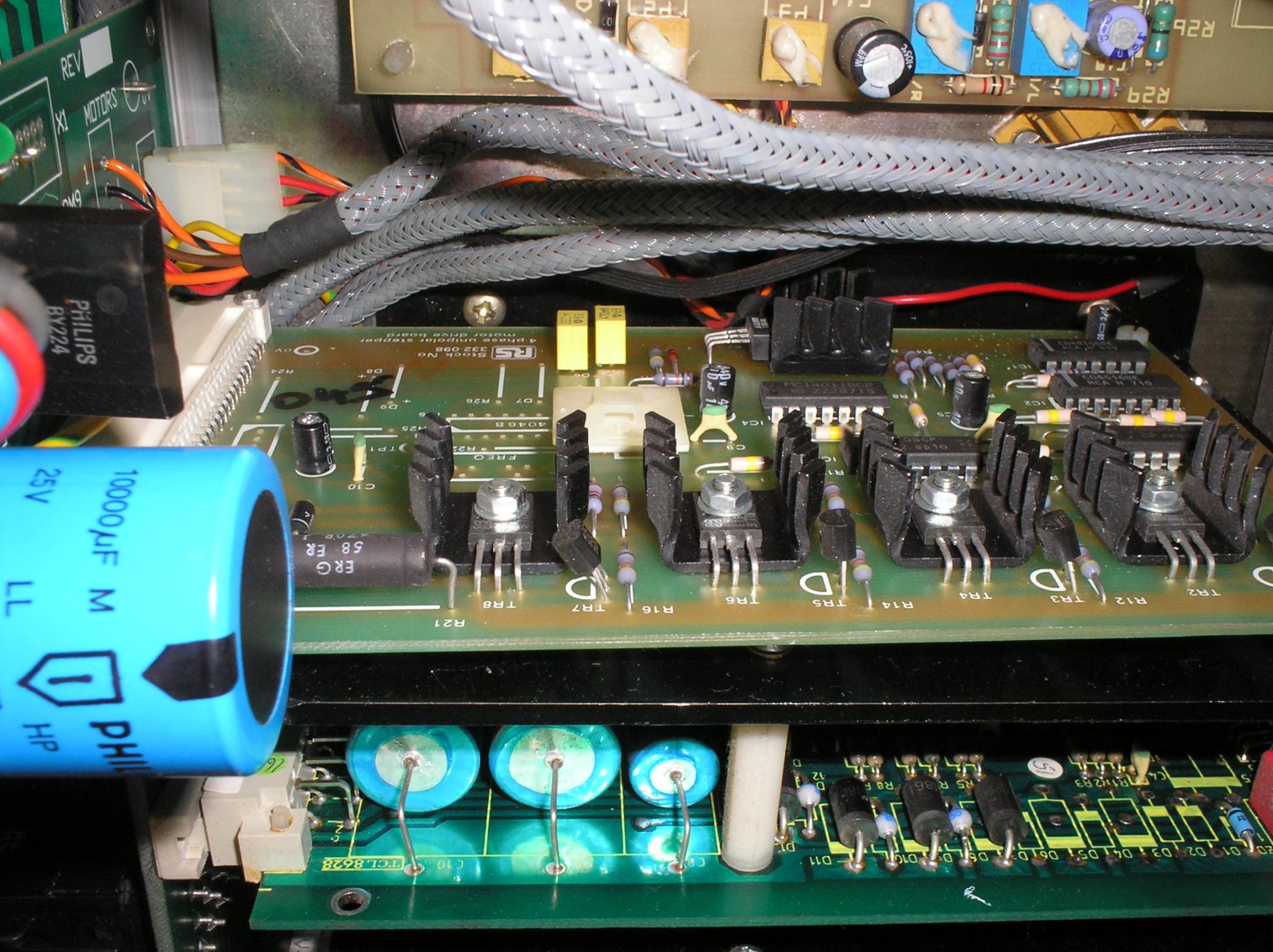

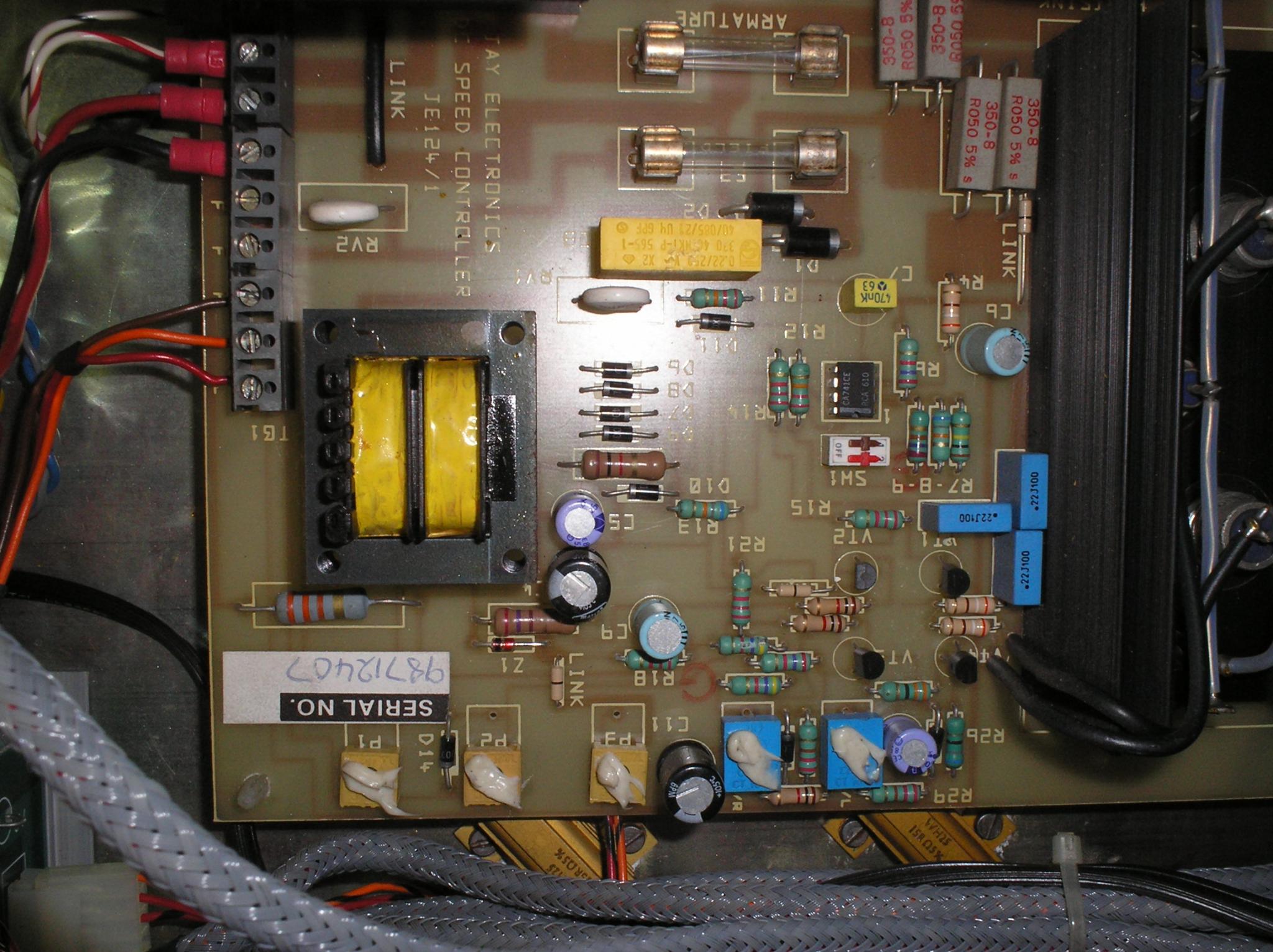

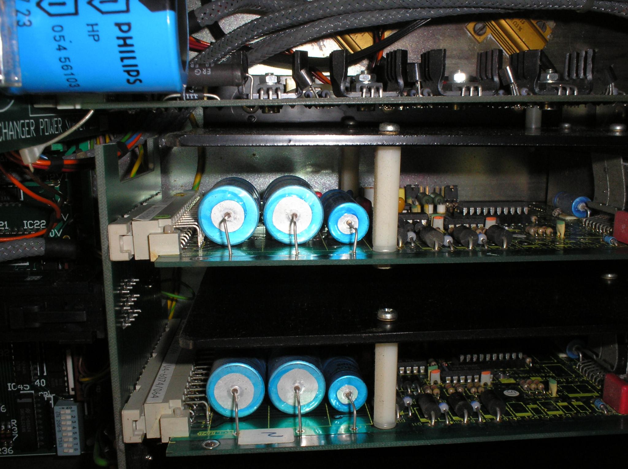

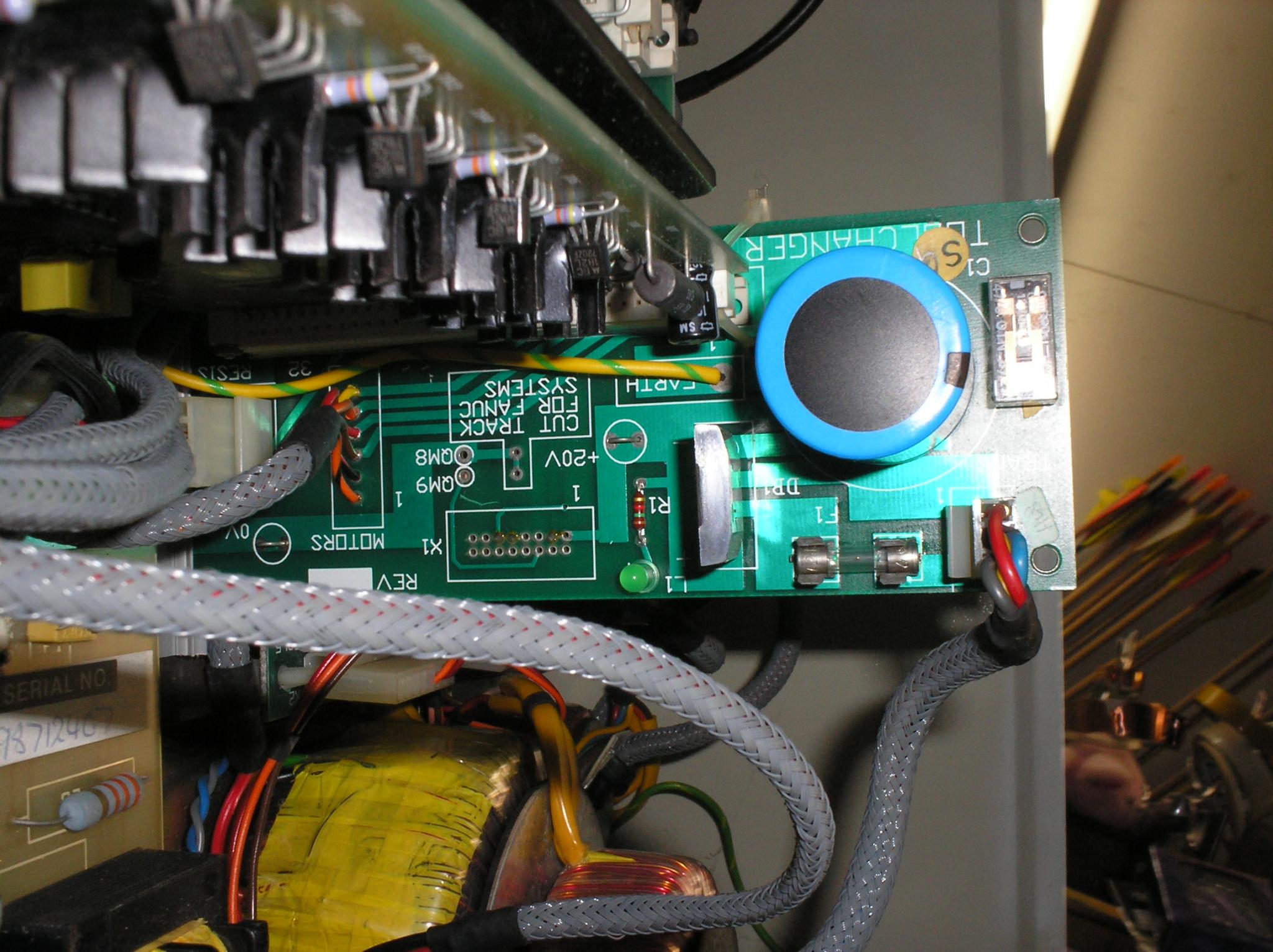

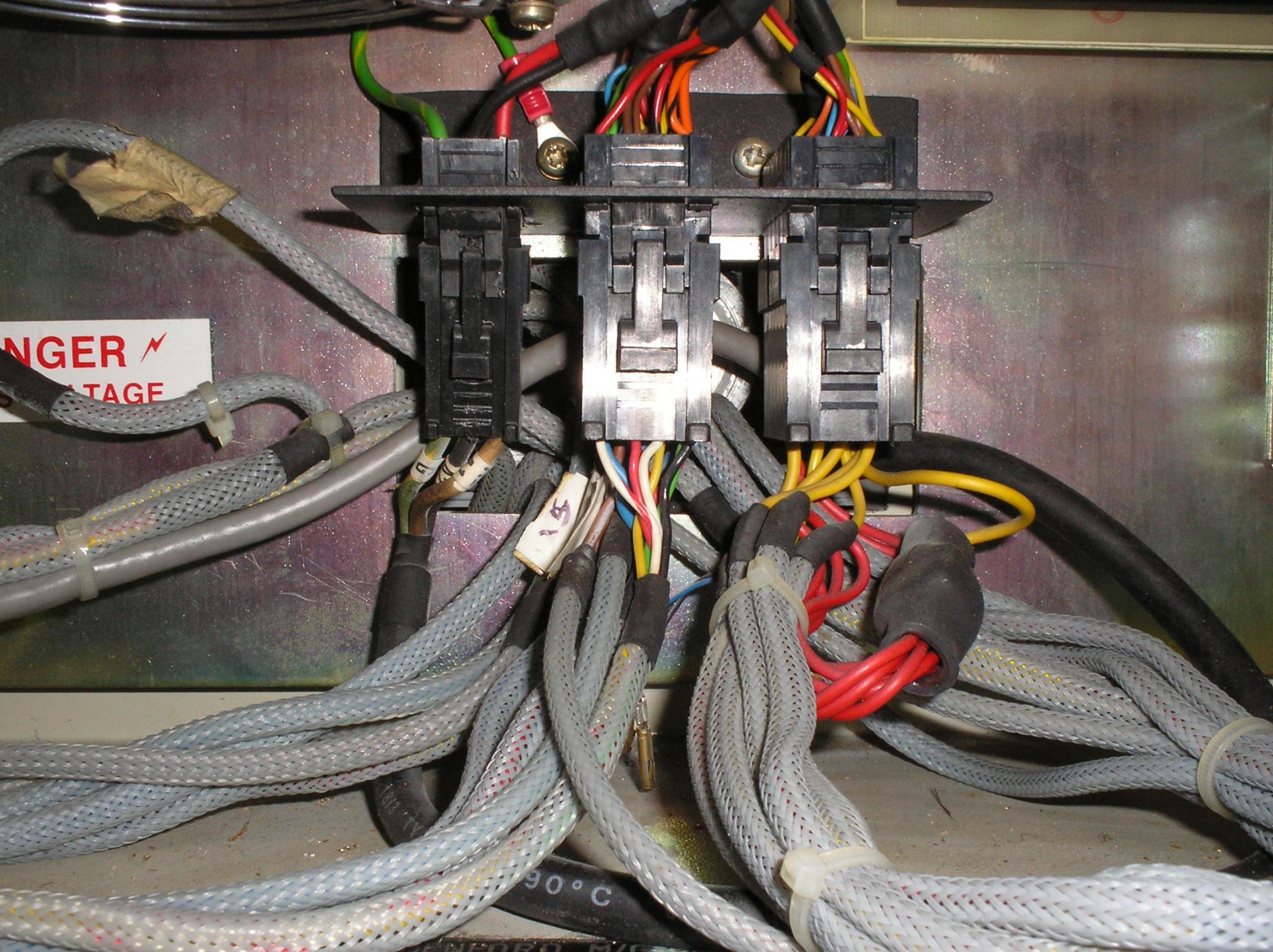

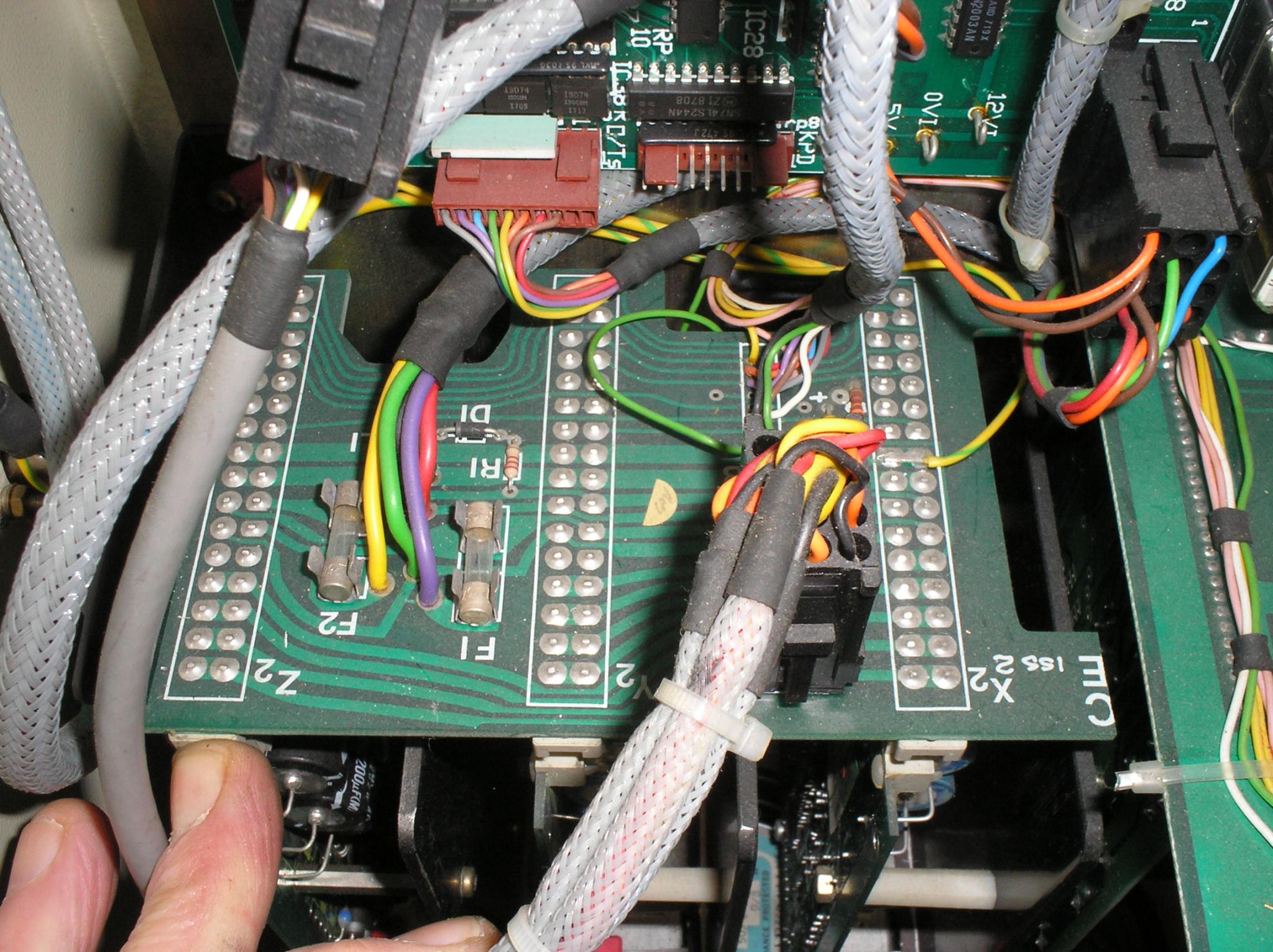

I have hard a good look at the circuits in
the back of the Starmill. I can't be certain but out of the two types of drive on that Denford link you posted, the sd range looks closest.
I have attached a few pics. On one of the motor boards- PKS Digiplan '87.
The Spindle board is- Jay Electrical DC speed control JE124/1 serial 98712407
The tool change psu 122ve.
I have received parts from Maplin to make buffer but haven't got a clue where to connect up. Phil.
11-01-2011 #27
have a look at the end of the stepper drive boards and it will state what type they are, probably a cd20 or sd 20. Page 23 of the digiplan drive manual shows the pinout for the end connector, and pins 26 and 28 of row c are the dir and clock positions. You'll need to find the wiring that feeds these signals into the drives and isolate them from the main board, then it's simply a matter of putting the buffer board between the breakout boards output and these points
11-01-2011 #28
with the spindle board, do the red orange and brown wires go to a pot for varying the speed.
