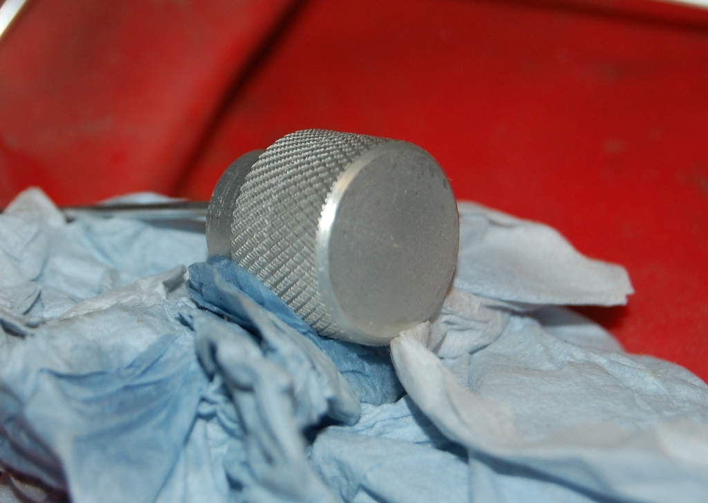

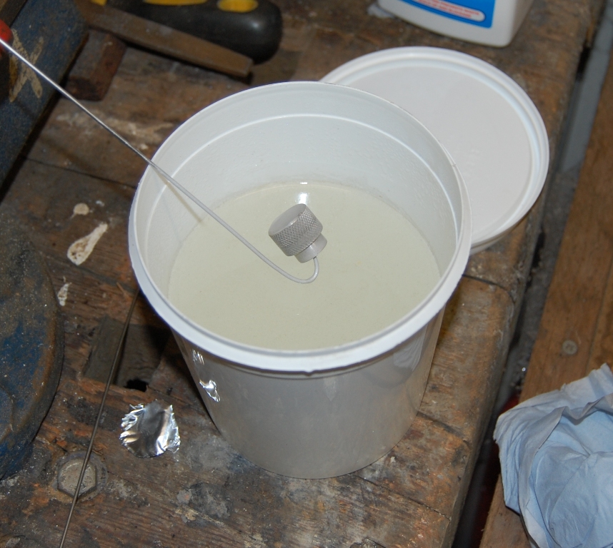

    1. mix about 3 table spoons of caustic soda to 1 ltr water. i leave my part in this for about 10 mins, longer if removing old anodise.

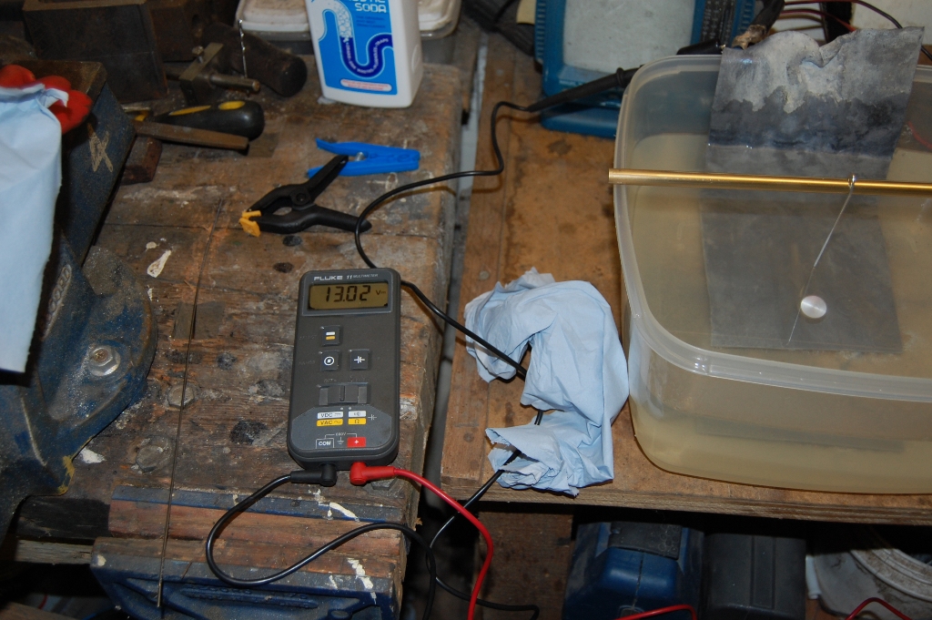

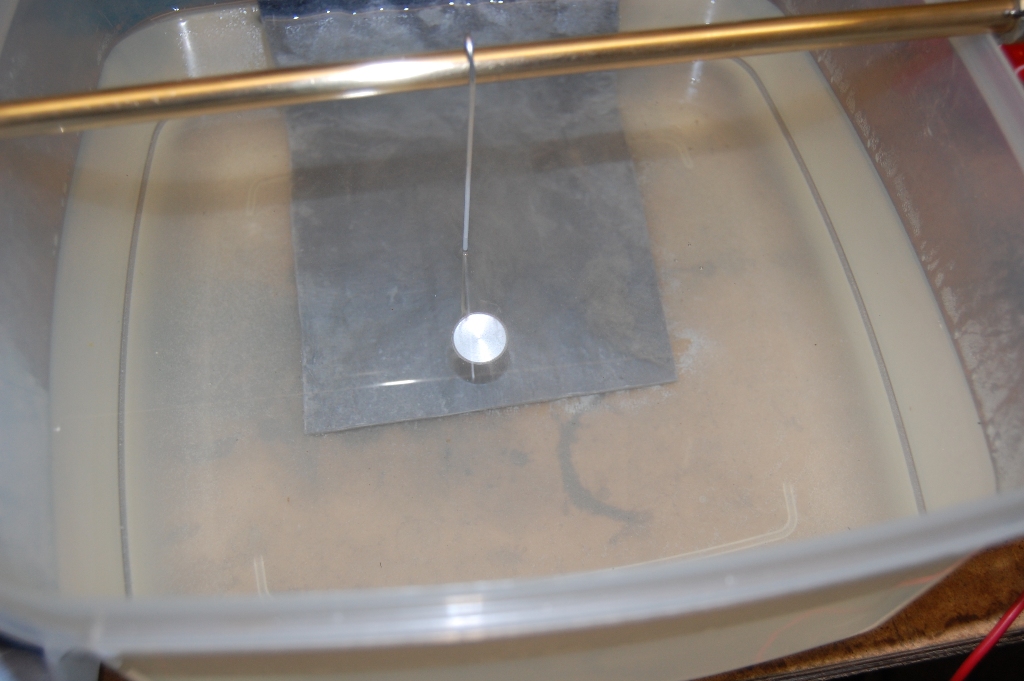

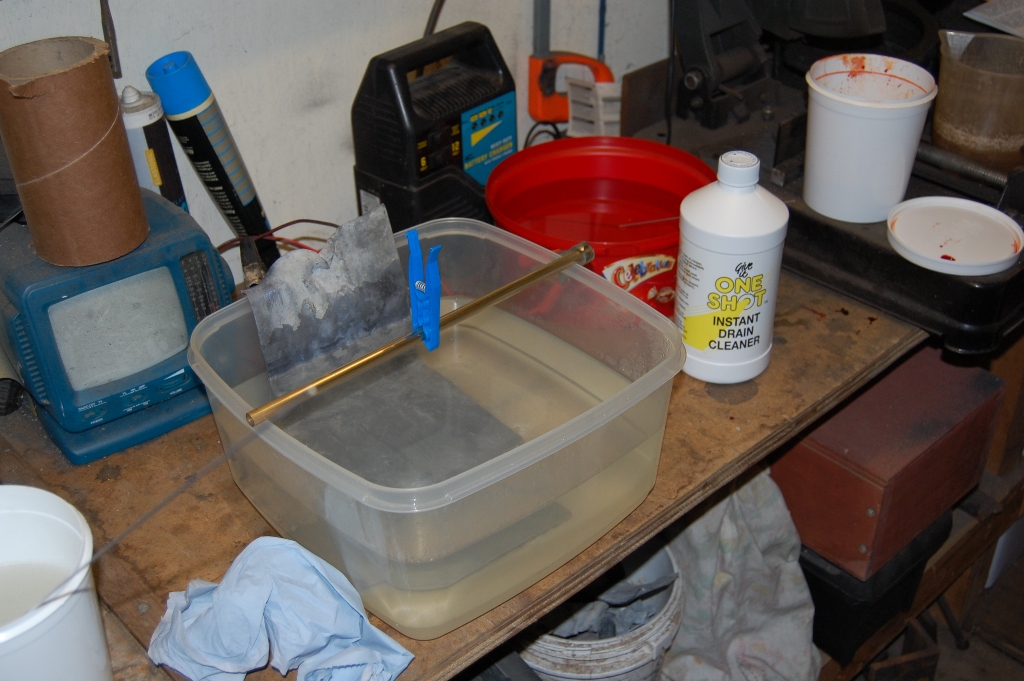

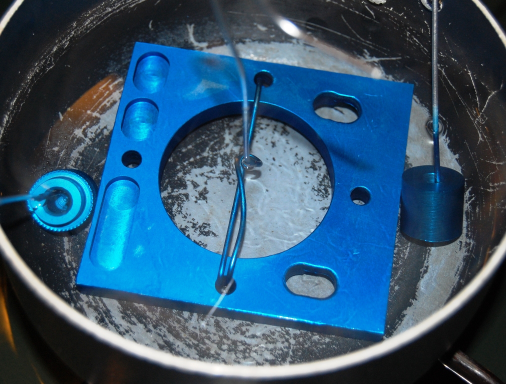

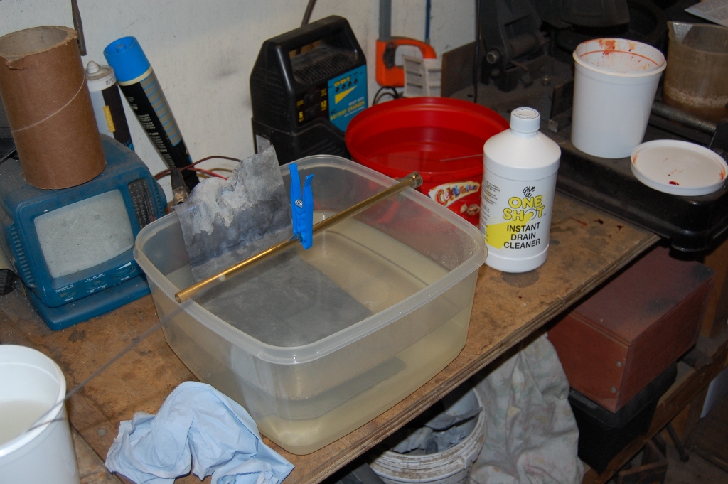

    here's my setup the bath is 6 ltrs distilled water then added to it the 1 ltr bottle of one shot. allways add acid to water never the other way round.
    there is a peace of sheet lead in the tank that the negative is clipped too, the positive is clipped to the bass bar which my part is hung from using aluminum wire. i am using a 12v battery charger on the fast charge setting.

    here's my part fizzin away :naughty:

    it can be in there for up to an hour, i have found that when the multi meter voltage is fairly stable its cooked.
    (multi meter is clipped too the + and - on the battery charger)

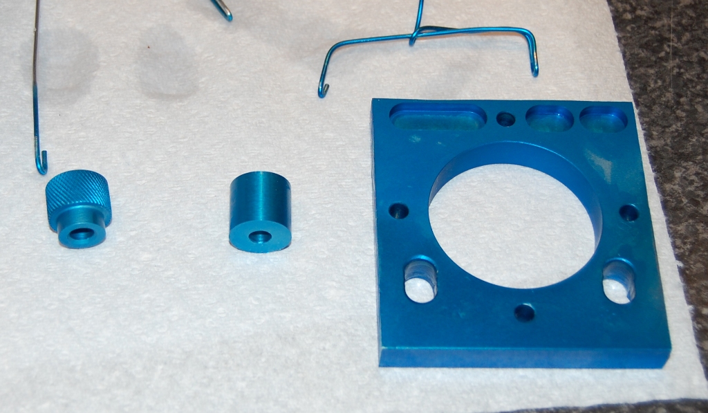

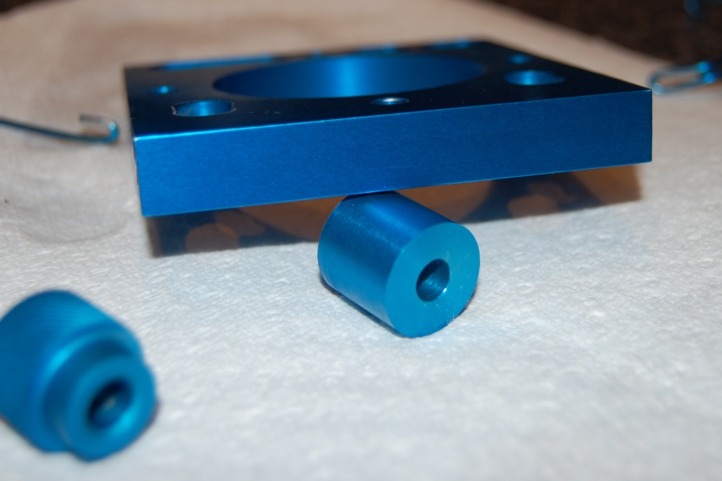

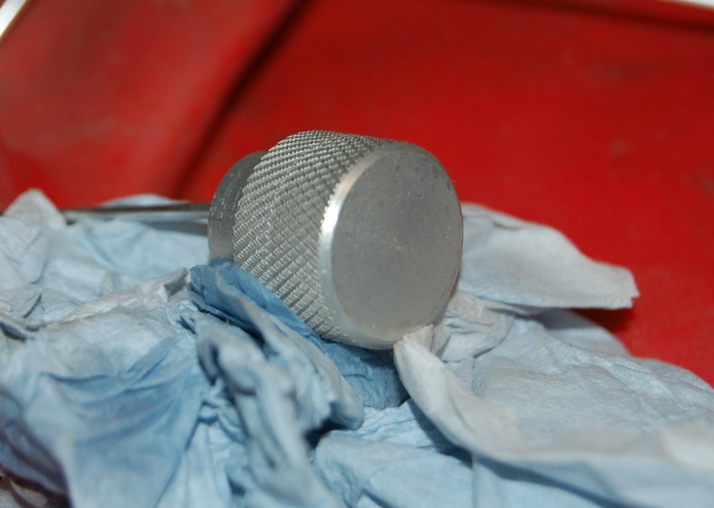

    now anodised.

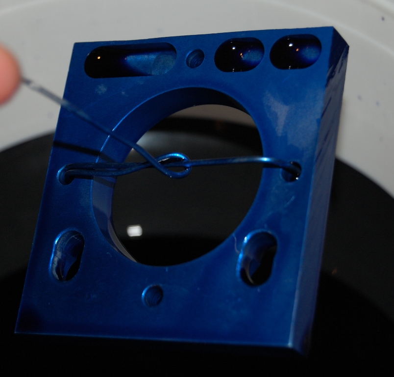

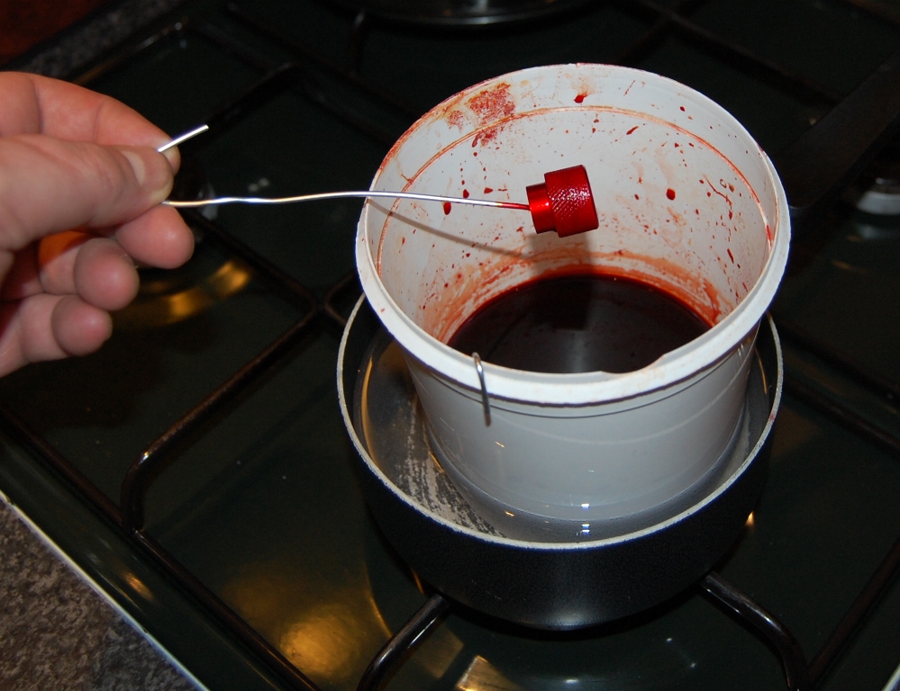

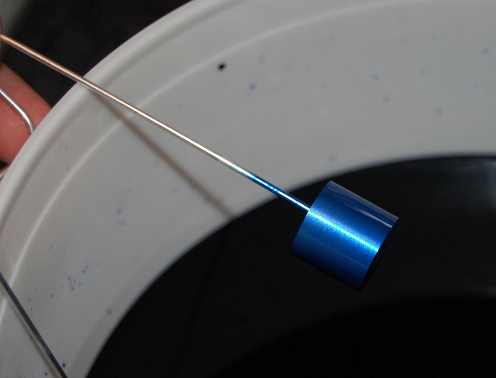

    first step to dyeing it, let it sit in the dye for up to 10mins for a deep colour. (this is just food colour)

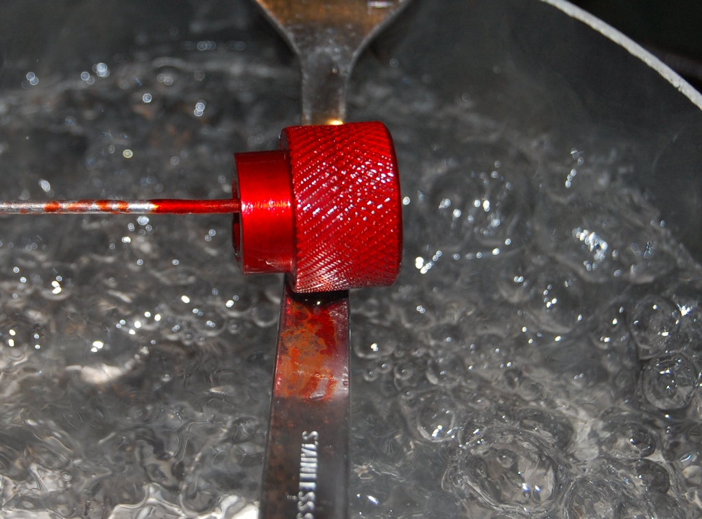

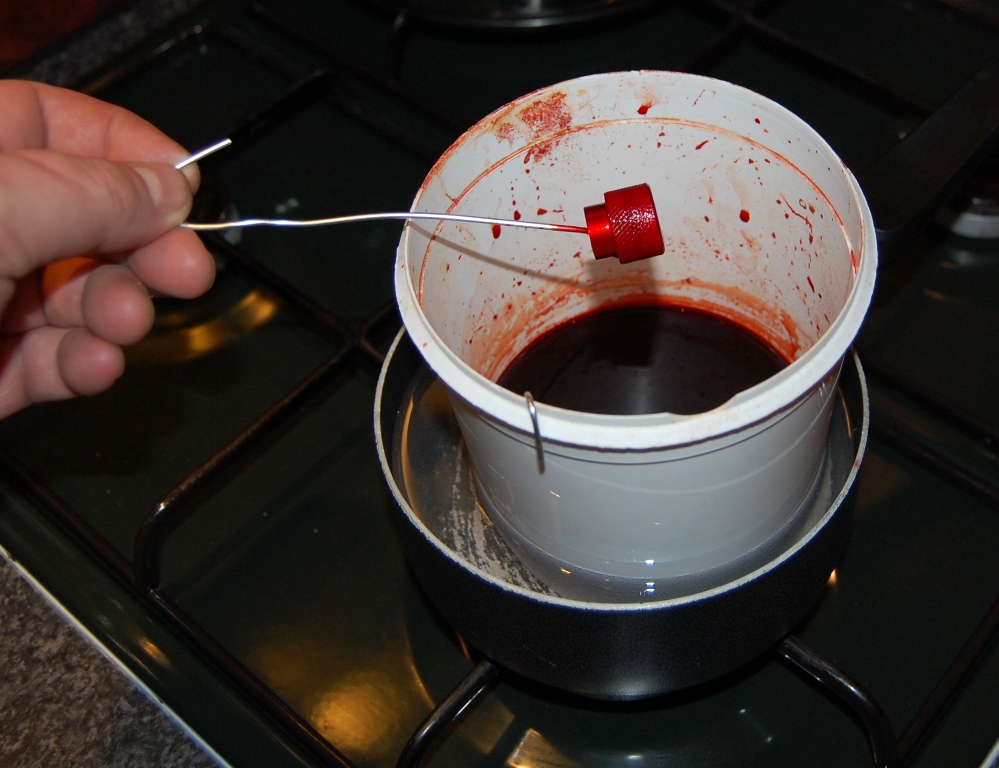

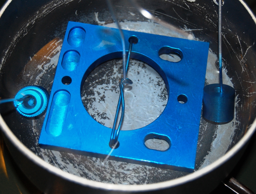

    then i steamed it for 10 mins
    this is it after 20 mins of boiling in water to seal it, it did buff up ok.

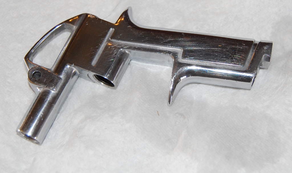

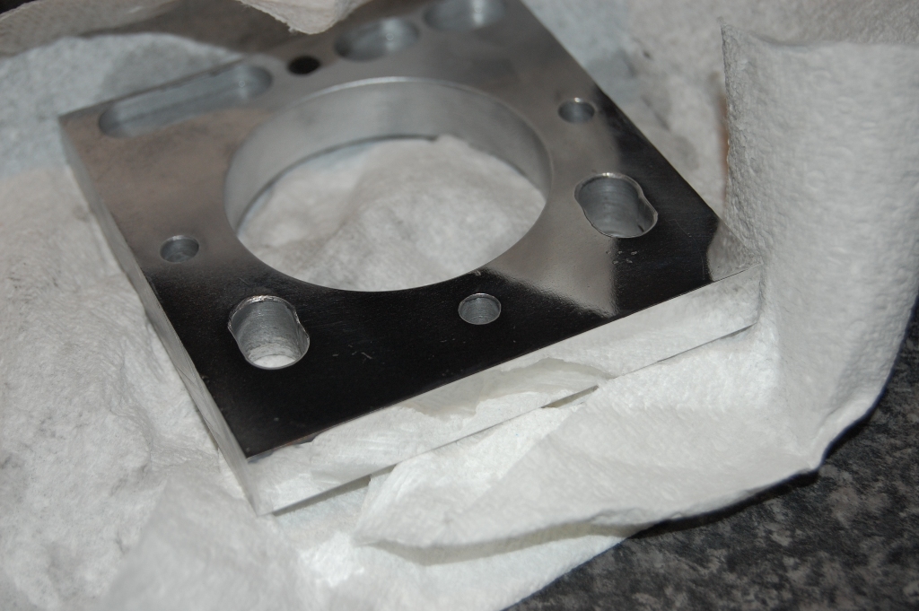

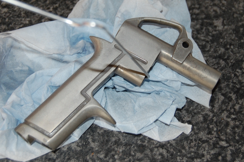

    here's some other parts i have been playing with.
    part polished
    anodised and lost its shine :cry:

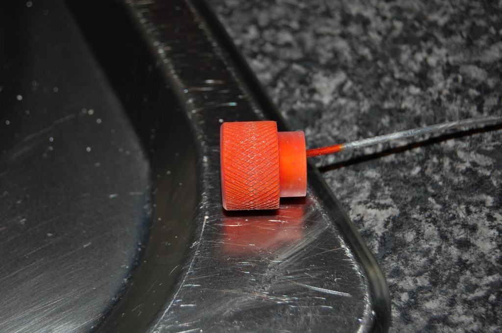

    dyed with the red food coloring

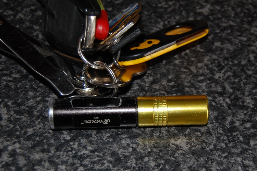

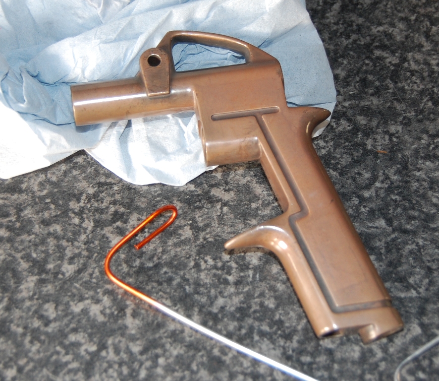

    the gold part was black so removed the anodise polished it to very shiny re-anodised it.
    used yellow food colour, and it came out still shiny

    Think you need to explain the electrical setup... what are you using as electrodes and power supply?
    updated for you mate ;)

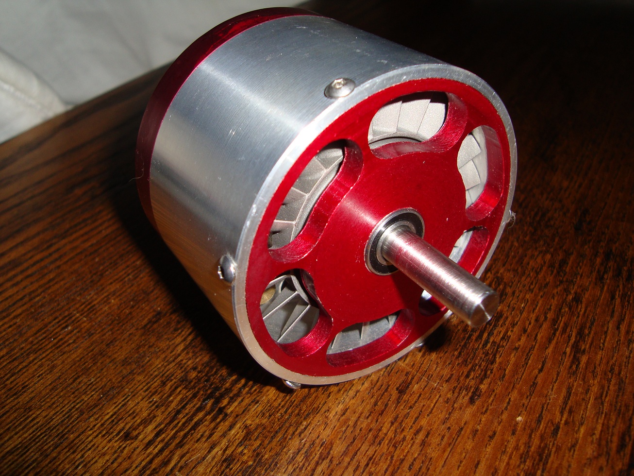

    One thing I've found with anodising is that you need to clean stuff with distilled water, a LOT. Clean in with normal water, then distilled, then etch it, then clean again with distilled, then anodise in distilled water&acid, then clean in distilled water, then dye (with the dye made up with distilled water), then seal in distilled water.
    If you don't do that I've found you get nasty white deposits on the part.
    Here's the first part I anodised, 2 years ago now

    that part looks cool jonathan. i have been using distilled water all the way no tap water at all.
    just got commercial dye today (blue) reds on it's way.
    did you or do you de-smut before anodising?

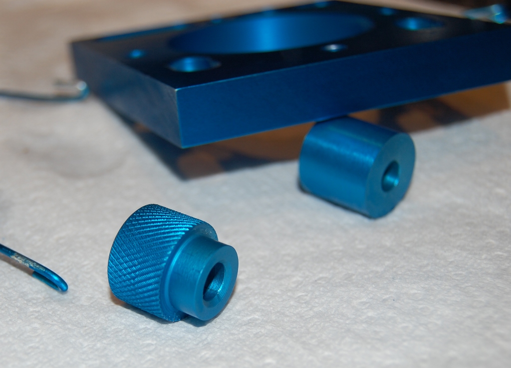

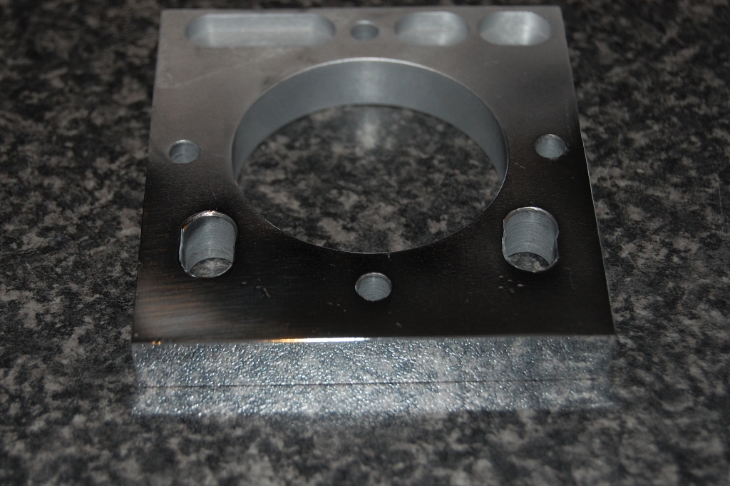

    i polished just half of this to see how it turned out.

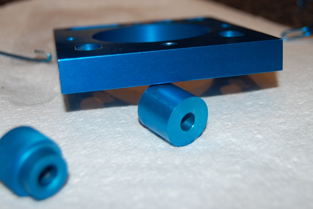

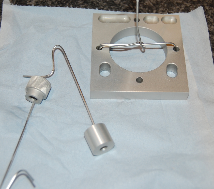

    here's the parts anodised.

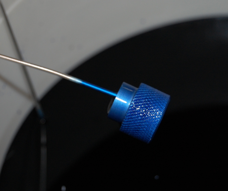

    dyed for 10 mins.
    sealed in near boiling distilled water for 20 mins.
    very happy with these test pieces :naughty:
