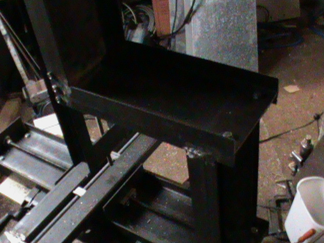

    Update on my cnc mill design.
    This is what I am using to build this mill.
    6" x 2" I beam /1/8
    3/8 threaded rod with nuts
    1" x 2" 1/8 with 1/8 L brackets for x axis
    6" x 2" I beam for y axis
    Frame is welded.

    Tommy do your self a favor and dump the threaded. . . . Nothing but trouble, the little extra for lead screw will payoff big time on head banging.!!
    Also depending on what you intend to cut with this machie I'd strengthen the I beam joint where it goes from vertical to horizontal.!! . . looks like a nice place for flexy springing.? .. . A few triangle plates would help big time.!

    I will add a angle bar, and other metal brackets in the future.
