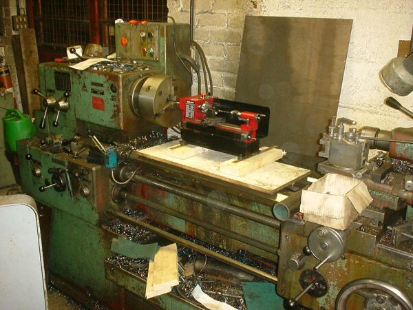

    What are you going to do with 6KW on a poor little C1?
    Nothing, it's a dick slapping contest because I drive my C0 with the 15Kw motor on the big TOS. :rofl:
    Like an elephant humping a Chihuahua!
