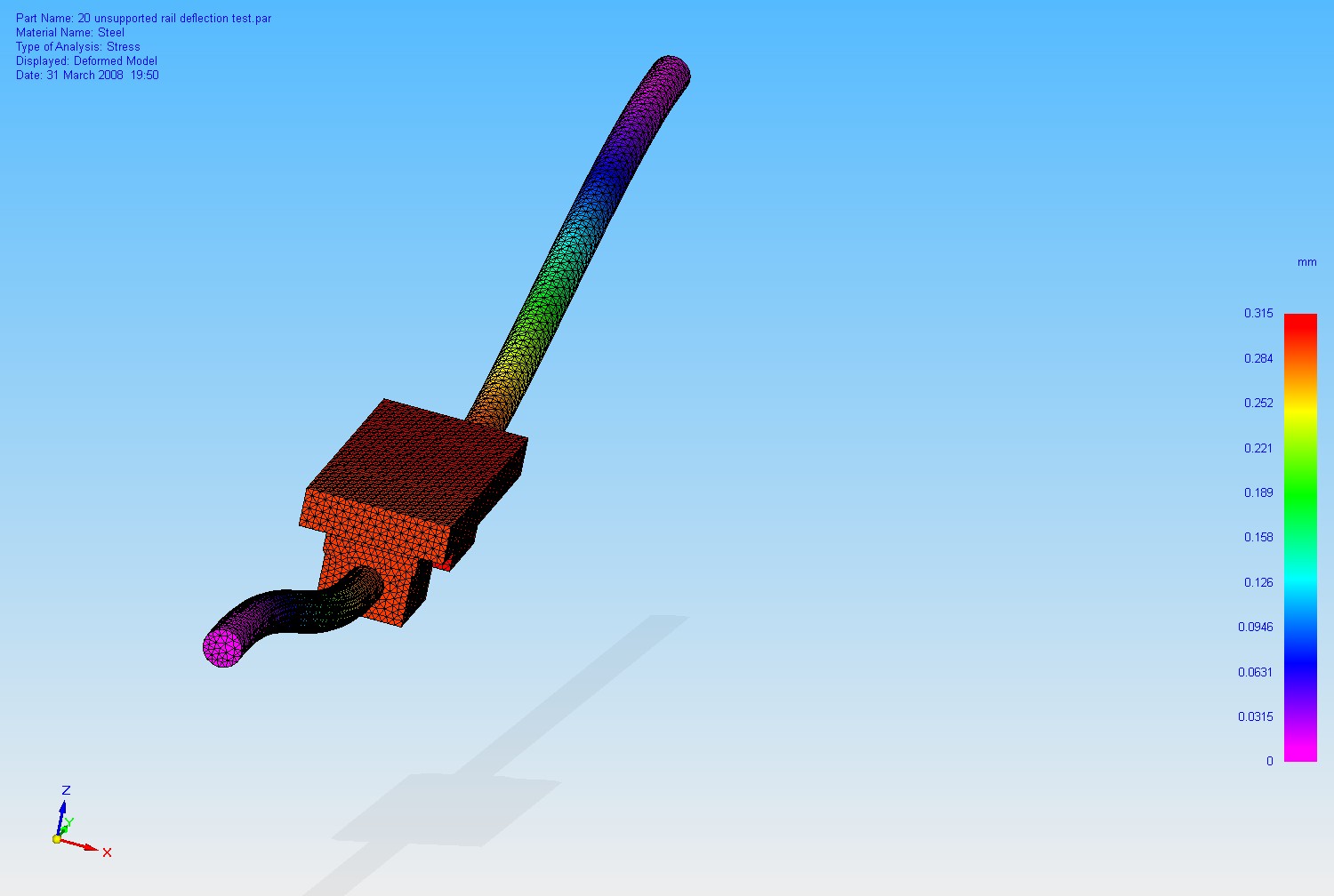

    All rails are 20mm diameter with 150mm between bearing block outer faces. The bearings are attached to a 75x160x20mm plate to which the forces are applied.
    Assumptions:
    Rail / box section ends are perfectly rigidly supported - in reality wont be so deflection will be greater than calculated.
    All joints are perfect, modelled as single entity - in reality will get some deflection between joints.
    The following diagrams each have different scales to make the deflection visible throughout.
    Unsupported rail 200N in Z direction to simulate weight of Z-axis:
Name:	SC20 900mm z200N x50N_steel.jpg

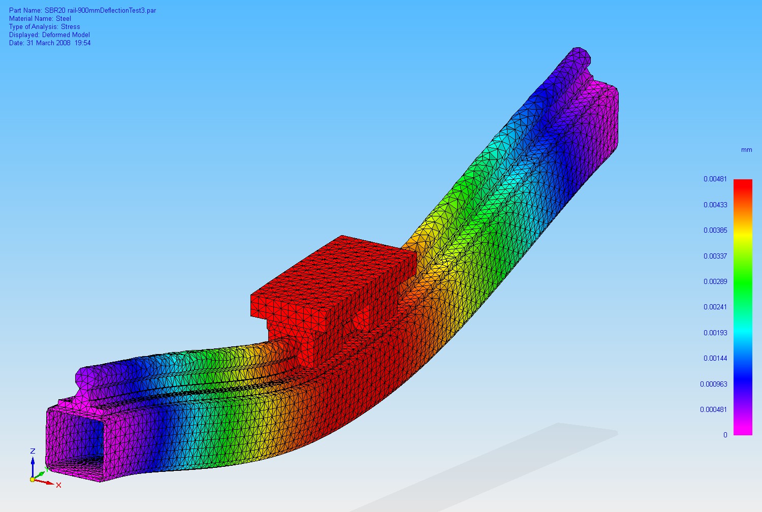

    Supported rail 200N in Z direction to simulate weight of Z-axis:
Name:	SBR20 900mm 200N_steel.jpg
    Unsupported rail 200N in Z direction to simulate weight of Z-axisand 50N in parallel to X for cutting force:
Name:	SC20 900mm 200N_steel.jpg
    Supported rail 200N in Z direction to simulate weight of Z-axis and 50N in parallel to X for cutting force:
Name:	SBR20 900mm z200N x50N_steel.jpg
    Max deflection for supported 0.0074mm vs 0.34mm for unsupported... draw your own conclusion.

    Case 1) Unsupported deflection is about 100 times greater than supported
    Case 2) Unsupported deflection is about 50 times greater than supported

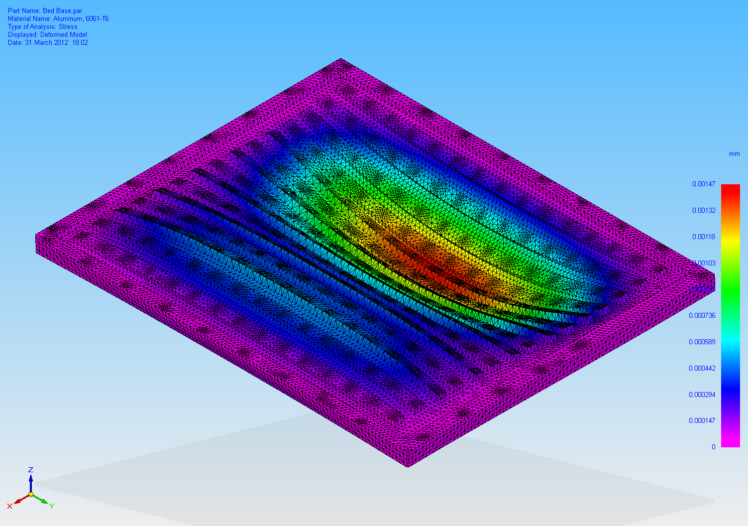

    An FEA simulation is never 100% accurate, but it's certainly a big improvement on estimation and common sense. I've simulated bed designs too, here's park of one I'm working on:

    Jonathan i make no accusations, i just responded to your weak bold statement that lacked accountability of all facts. It was you that made the statement that unsupported rails are weak not me. I just pointed out some of the missing facts? If you could show how strong supported rails are attached to 40 x 40 profile like a lot of machines are you will see just how weak they are in comparison to your model?
