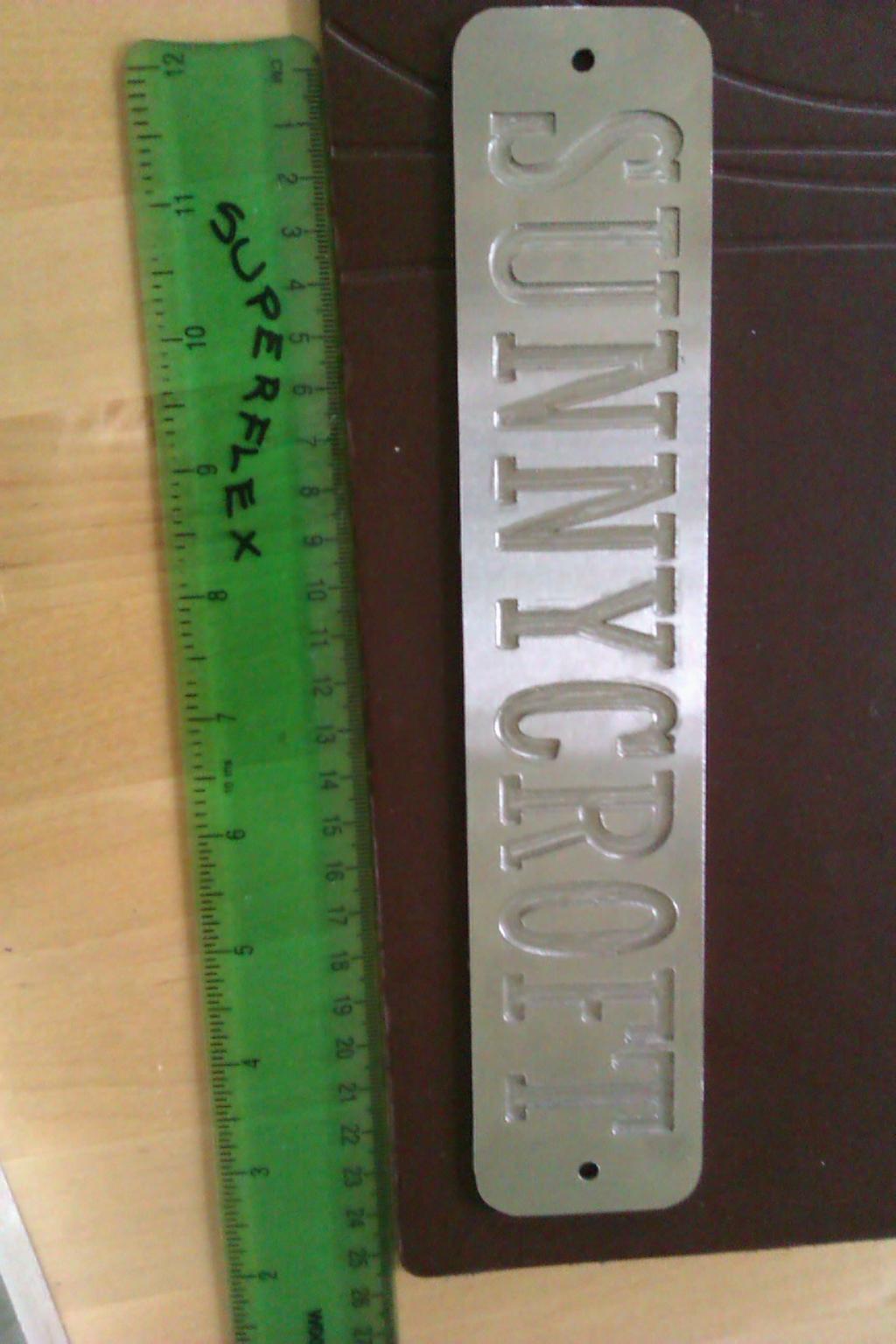

    kell's Avatar
    Lives in doncaster, United Kingdom. Last Activity: 15-12-2024 Has been a member for 9-10 years. Has a total post count of 53.
    This is a picture of the type of thing I am trying to achieve. I use solidworks and solidcam. The lettering in the picture is only 5mm in height.

    Quote Originally Posted by kell View Post
    Which is the best software to use to produce fonts ready for cutting on cnc ?
    If you have decent CAM you can already use any fonts available to your Operating System.
    There is software available to produce fonts but making fonts is a lot of work, even with the right software, it's easier to choose from the thousands already available for free download,
    - Nick
    kell's Avatar
    trying to match the one in the picture thats is all no interest in designing one.
    That's a case of trawling through the available fonts for something suitable, you've seen it in good detail and so will be best placed to pick one,
    - Nick
