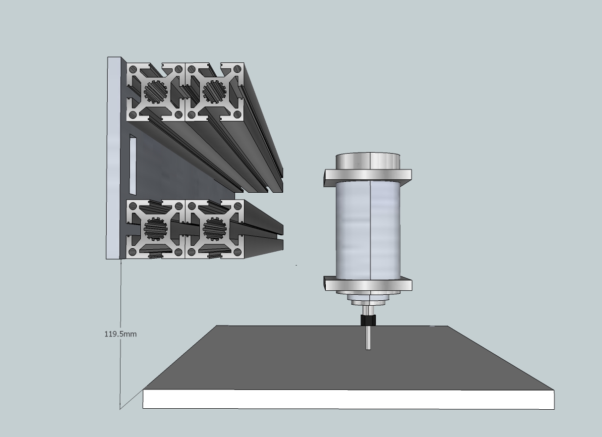

    I will have a go at the analysis tomorrow evening and report back...approximately what distance do you expect between the tool tip and the bottom of the gantry?
    Could you use some hypothetical distance at this stage... I'm more interested in a general comparison and haven't got to the Z-axis of Mk1 design yet and things may well change if the recent past is a good yardstick... lol
    Are you able to volunteer a distance you would like to be used Adil?

  9. #28
    Quote Originally Posted by WandrinAndy View Post
    Erm, if I'm understanding it correctly the vertical distance is about 5 inches, but depends on the length of the tool also.
Name:	tool height.jpg
