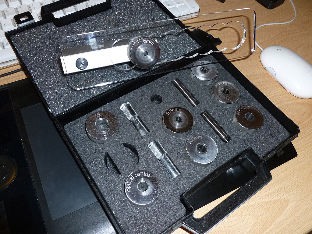

    A while back I posted an RFQ about getting one of these made to help me with drilling and tapping into the edge of 15/20mm aluminium plate:
    It became a bit of a pet project, tweaks were made here and there and Dom contributed massively with a few refinements of his own whilst machining it for me. Anyway, after cutting the acrylic set distance guides along with the case foam this weekend, I think it's near enough finished - here's a pic:
    ...and here's a vid of it in use:
    It can be used to drill/tap M6, M8 AND M10 into 15mm and 20mm plate.
    Yeah - I know, I know - it's a bit over the top for what it is - the number of people who've told me they'd have just used a pillar drill... The whole point of getting this made was down to the plates not being able to fit under my pillar drill, or the length of plate meant that clamping would have been cumbersome and a bit hit and miss (the usual response to the latter was along the lines of "well, in that case I'd make myself a clamp...") Anyway, it's made now. It works well, it's accurate and it should save me a bit of time in the future!
    Thanks to all who offered design suggestions/encouragement at the start and a huge thanks to Dom for creating it. It really is a lovely thing!
    Wal.

    Looking good and professional with that box:)
    Two things:
    - wouldn't it be better to make the drill guide and tap guide taller so that the drill bit and tap bit are held more securely and wobble less?
    - does the grub screw go straight through the guide, chewing into the side of the ali plate or is there a bit of SS which the grub screw pushes from the side and in effect presses against the ali plate?
    Regards,
    dsc.
    Wal's Avatar
    Hey dsc.
    I wouldn't make the guide any taller due to M6 taps generally not being that long - in its current state I'm already losing 2cm of plunge off the taper tap - although for the depth I'm tapping it's not really an issue. Any deeper and it probably would be. The boss bores are a smidge over the diameters of the drills/taps so there really isn't that much flapping about.
    Yep, in its current state the grub screw leaves a little crescent shaped mark on the plate, but I have some nylon tipped grubs on order to solve that problem!
    Cheers.
    Wal.

    You probably know this already, but a nice spiral flute tap will lift the swarf out the hole which is good for blind holes. If it's a good one, you should be able to use it in a cordless drill too, which makes things faster.
