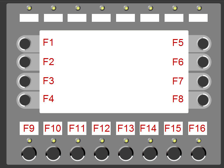

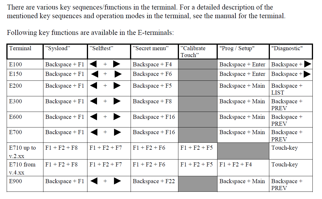

    Andy, does this sound familiar?
    1. Press Backspace+F16 to get the "Secret Menu" (not mentioned in the manual)
    2. Format the flash from the "Secret Menu"
    3. Put panel into Sysload mode
    4. Install new firmware with HMI Tools > System Loader
    5. Install HMI program with e-designer
    Sounds easy, dunnit?!
    Bit stumped as to which keys are F1, F2, etc as they're not labelled. There must be default numbering but dunno what they are. Don't suppose you know??

    Yes that does sound familiar the F1 key is the first one on the left with the small LED above it just below the screen and above the numeric keypad.
    Hope you get this sorted.
    I'm back at work tomorrow I'm sure I made some notes at the time and saved them on my PC if I find anything I will post you a PM on here.
    Andy
    Cheers Andy. I have managed to find the attached default key layout, which again is not mentioned in the Mitsubishi manual. I've passed all of this info onto a colleague as I'm on holiday the rest of this week. What's the betting he'll sort it in 10 minutes and make me look a twat? lol
