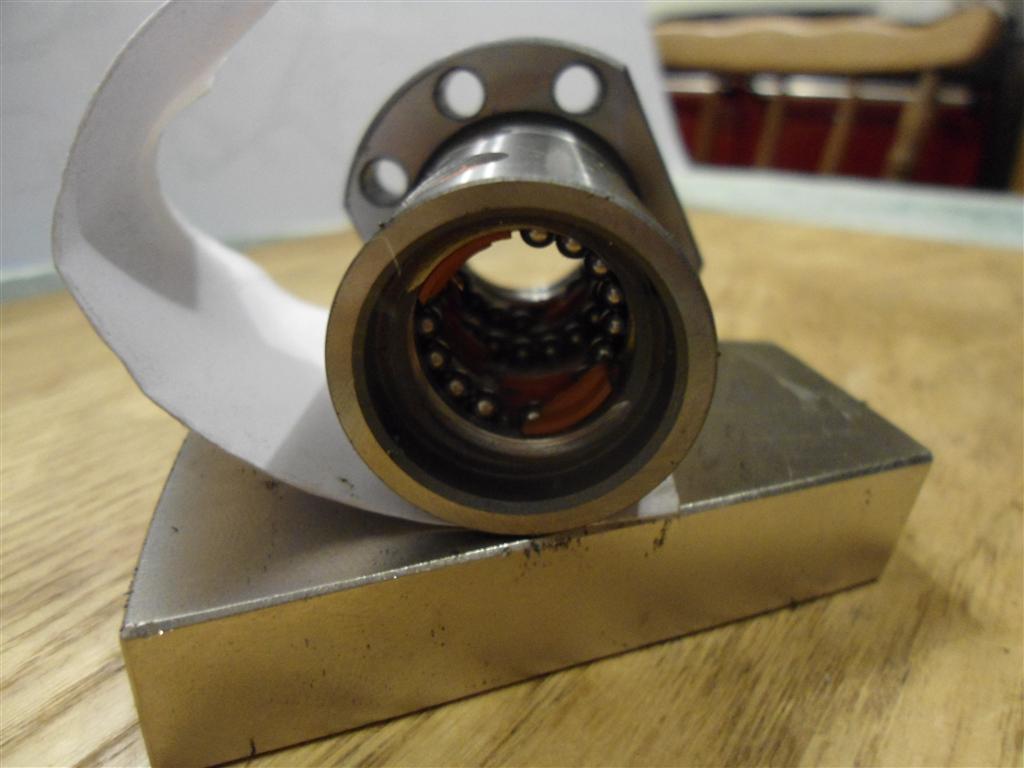

    Having balls missing will effectively reduce the load rating of the nut, which in turn will shorten its life. So if this ballscrew is for your average diy CNC router that's probably not an issue, as if you calculate the lifetime with the relatively small forces on a router, they'll last for many years. Many years minus a bit is still a long time.

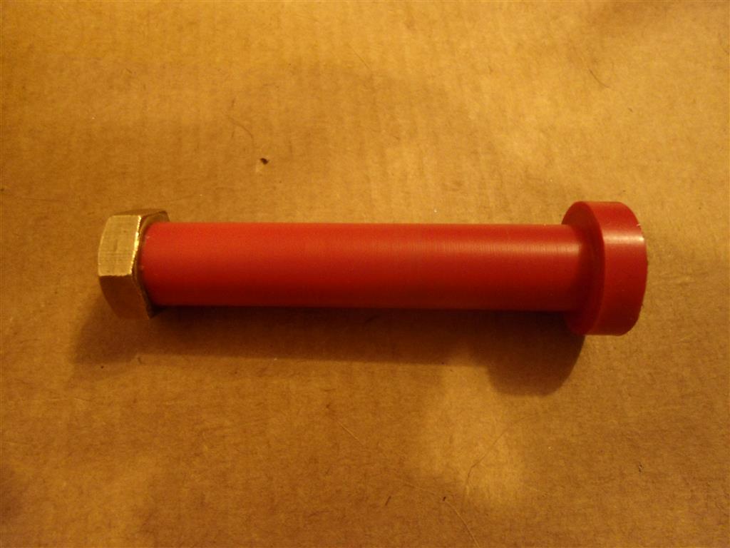

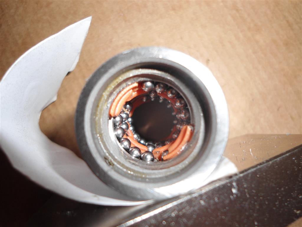

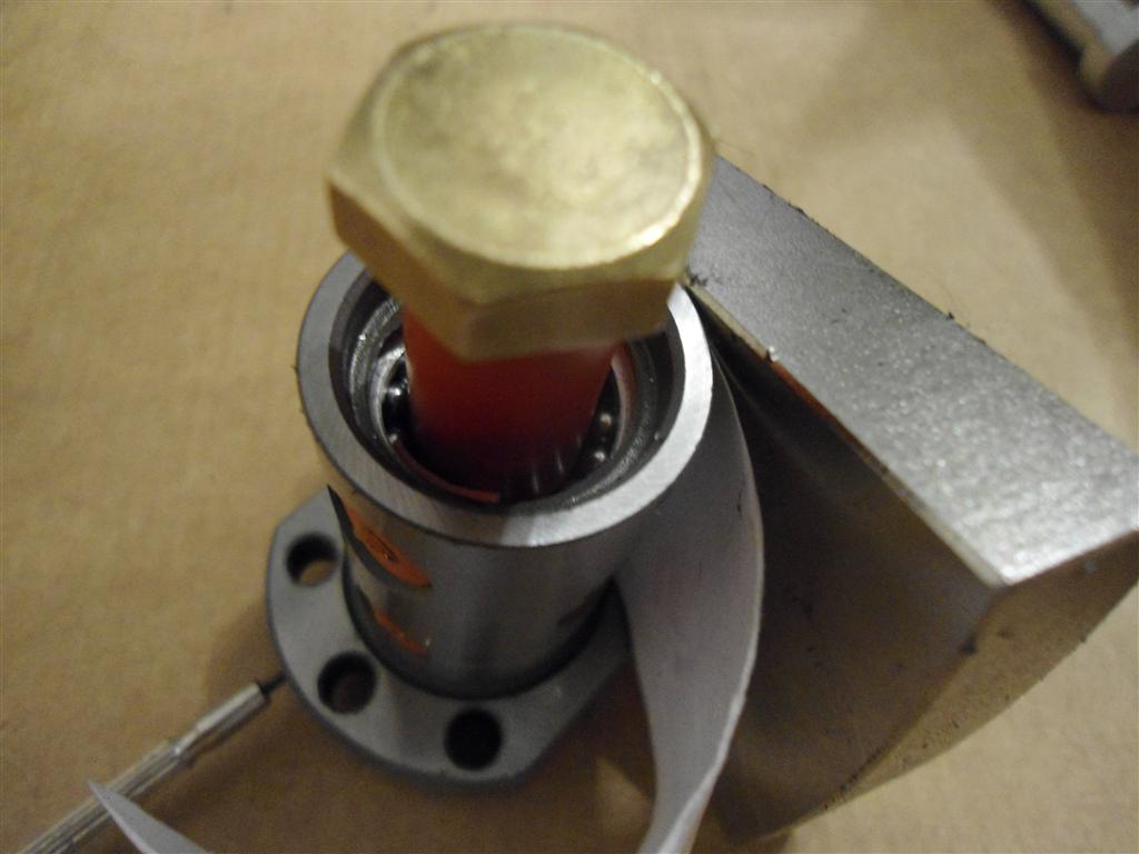

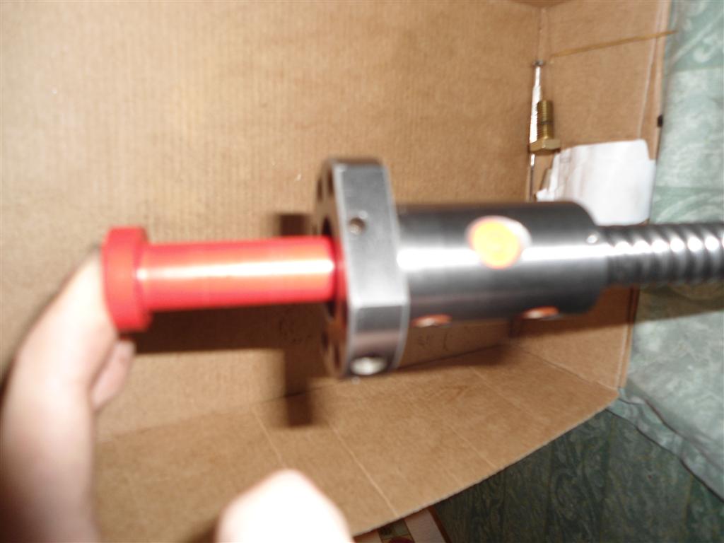

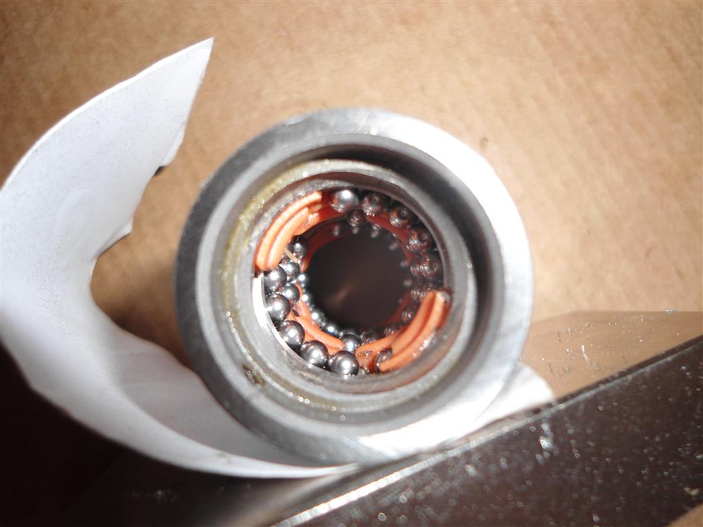

    However, you should be able to get them all in. The grease idea sounds good. You could put as many as you can in, unscrew the nut on to a tube, stick a large magnet to the side of it (so the balls don't fall out), then poke the rest of them in. That's the way you'd do it if there was no access through the return channel, as it's generally more difficult than the former. The following pictures show this process:

    Put the return track cover back on.
    Put a light film of grease inside the nut.
    Stick all the balls into the nut in the correct places.
    Make a roll of shim just under the core diameter of the nut and balls and then slide the nut onto it making sure the balls stay in place.
    Offer this up to the screw and wind the nut back onto the screw shaft making sure the nut is the right way round.
    If necessary, wash the grease out with paraffin and apply the correct lube.
    Sit back, drink beer.

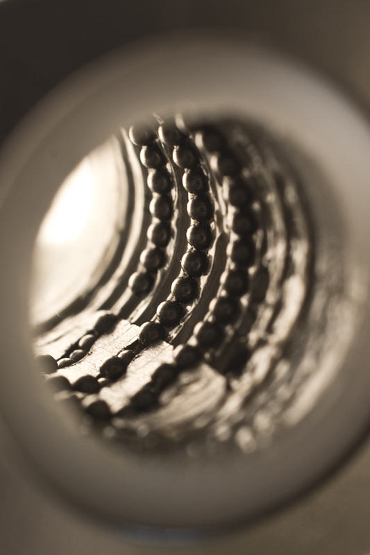

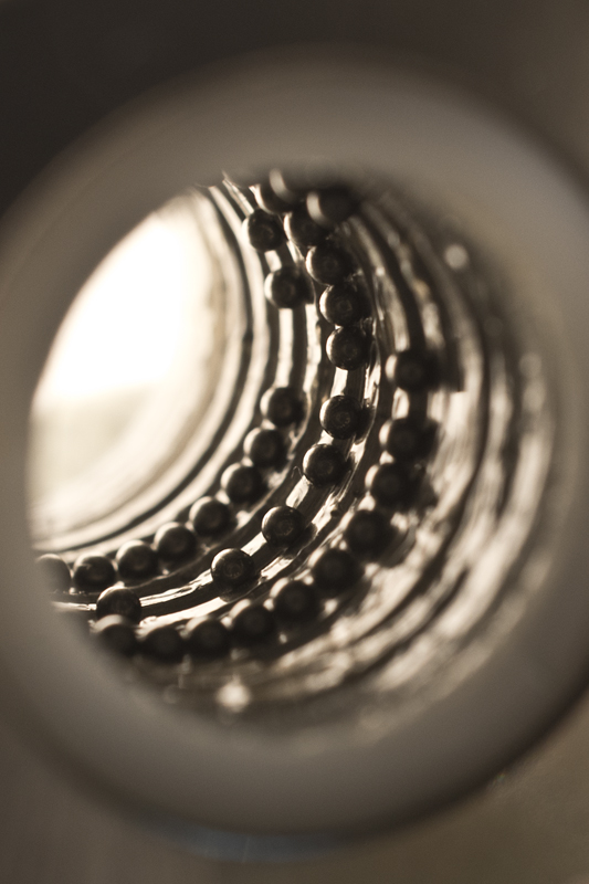

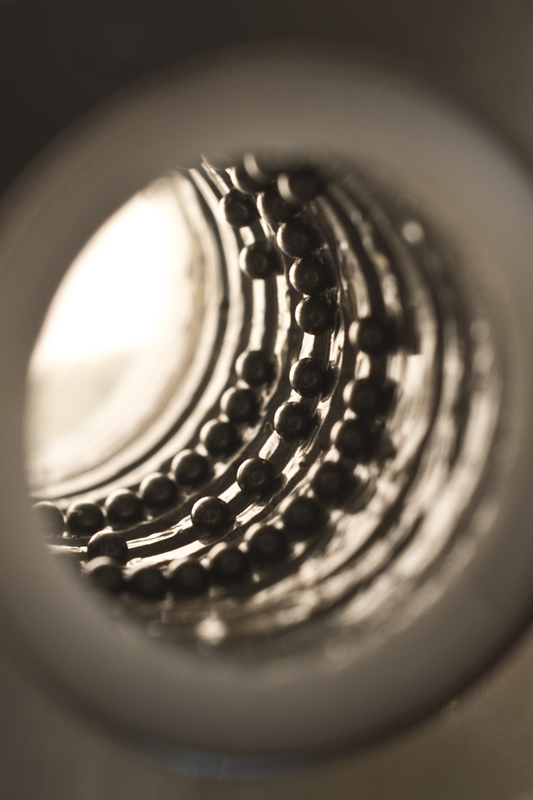

    This is getting annoying now, I've re-done the ballnut yet again, for the n-th time I think, still it gets stuck. It seems like there's balls getting stuck in the return plate, just crammed in and not wanting to circulate. Here's two photos showing the balls all sitting nicely in the three circuits:
ID:	10728Click image for larger version.
    and a video showing the nut stopping every few turns, you can also hear rattling and rubbing as something is getting blocked inside.
    I'm one step away from chucking this out the window...
    Regards,
    dsc.

    I've popped it apart 50 times or so already, so one more won't make a difference. I'll see if it's all the same or whether the diameter is different on some of them.
    I have 85 balls in the nut, the max capacity is 92-97, so I've lost 7 or more somewhere, although according to Gary (Zapp) they never load the nuts full to the brim. I've definitely lost a few somewhere as I've dropped the retention tubing at one point and the balls came flying out.
    I've realised the return plate can go on in two different ways, so I've rotated it 180deg and it made things better, only to get stuck under load. I've assembled the Z-axis, popped the ballnut on the ballnut support and tried moving it, it crunches ever few turns and something definitely gets blocked. If I lay the Z-axis horizontal, nothing gets stuck as the ballnut is not loaded. I took a hit and ordered another ballnut, so hopefully that will end this nightmare.
