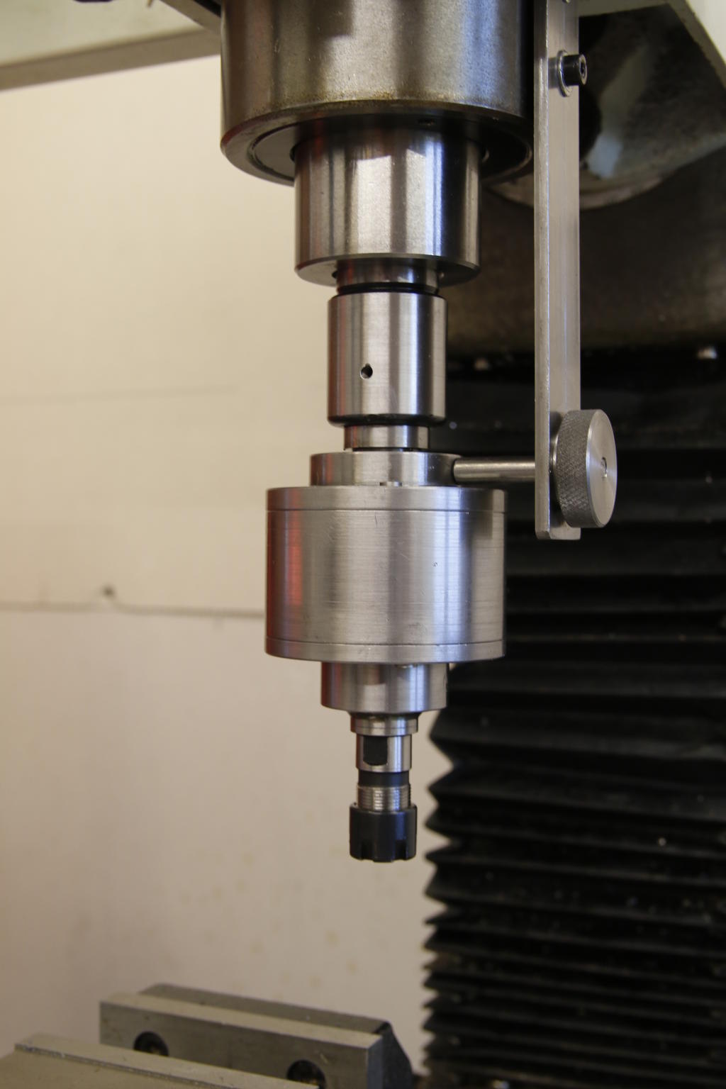

    Just finished make this speed increaser, its by Hemingway kits with a ER11 chuck instead of the
    6mm tool holder and grub screw as in the kits spec. the unit gives a 3X speed increase.
    so far its works very well.

    That looks cool how dose it work?
    .Me
    Hi Lee
    its a epicyclic gear box that gives a speed step-up of 3X spindle RPM, the low speed input shaft has a internal cut gear wheel then an intermediate gear that drives the sun wheel.
    The Kit came with all the gears and bearing.
    http://www.hemingwaykits.com/acatalo...Increaser.html
