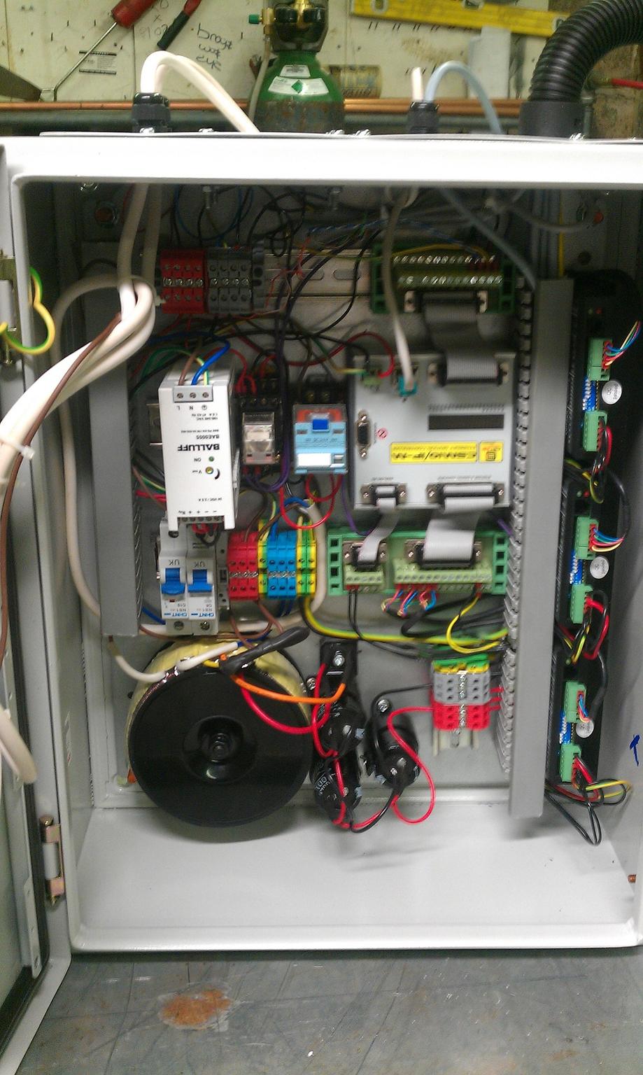

    Hi All,
    I have a typical Chinese R1325 router which after a great deal of work to complete the wiring of the control panel, and truing/squaring up the axes is now working. The control system is Nc Studio driving Nema 34 stepper motors. I mainly use it for cutting profiles in 18mm melamine faced chipboard for kitchen units. I use a 12.7mm dia PCD cutter and cut the full depth in one pass. For the most part this is producing acceptable results. However if I try anything more ambitious where multiple tool paths are required I get lost steps all over the place. I don't think it's due to any tightness in the machine as it occurs anywhere in the tool path. It's quite obvious when it happens as the motors can be heard to "knock" quite loudly. This can even be heard when the machine is sent "back to zero". My question is this, would fitting a hybrid closed loop step servo drive system in place of the existing drives and motors solve the problem? I've seen a few around and like the look of this http://www.ebay.co.uk/itm/CNC-Hybrid...item417b121221
    What does the collected wisdom think? am I barking up the wrong tree? should I maybe be thinking of changing the control system to Mach 3 instead or as well?
    Many thanks for any advice you can offer, this is driving me quite mad.
    Bob.

    Thanks for the reply Jazz, I will get back with all the specs on Monday when I get back to work. Meanwhile I think it unlikely it's due to asking for too much speed from the motors, or low voltage drive, the problem is less evident with a feed rate of 3600mm/min and never happens at rapids of 10000mm/min. The drives are fed from 4 separate windings on the transformer at 70 volts so should be high enough. Drives are Leadshine MA860H. More to come next week.
    70V is only just enough if they are smaller 4nm 34 motors with low inductance but if they are larger motors then it's not really.
    It sounds like this could be few things working together.? Possibly some binding and overtuned motors but without knowing more regards screw pitch and size etc then difficult to say. But with 10mtr/min rapids and guesiing 10mm pitch screws your all ready tuned over the corner speed of the motors and running the motors with low voltage so torque less higher up the speed curve.
    I'd tip these steps are lost on directional changes thru inertia pushing with low torque and guess your using 25mm screws with a 10mm pitch.? (Things only get worse if your using R & P due to low efficency)
    Give full SP on machine ie: size/pitch/ratio etc of linear motion. Motor tuning setup Velocity/accel etc. Drive setup amps and Micro step setting.

    The machine has rack & pinion drive to the x and y axes and 10x25 ballscrew to Z Y axis has 2 motors with the drivers connected to the same pulse/dir circuit. All motors have 5:1 reduction drive to the screw/pinion via toothed belt. Motors for X and Y are set to 1600 steps per rev and machine output set to 0.01042mm/step, the rack pitch is approx 4.15mm which is confirmed by the drive ratio and machine setting. I therefore calculate the maximum speed of the motor in rapid at 10000mm per min is 600RPM. Drive current is 4.86A. The motors are Nema34 type about 115mm body length They have 86BYGF 450B on them but a google search reveals only ads for machines no specs. The machine manufacturer reckon they have no details they can let me have. Hope this all helps.

    Quote Originally Posted by cncbobuk View Post
    This needs explaining better.? Do you mean your just using 1 Step and 1 Dir signal to drive borh drives.? This is a Big NO NO. One reason is the drives have resonance compensation circuitry built into them and doing this just confuses the drives so they don't know which drive to apply compensation too. The net result is that one drive/motor can get thrown into resonance. Then you have timing issues thrown into the mix and this just results in all sorts of random and strange happenings.!!
    Not saying this is the problem but it certainly won't be helping any if it is setup this way.
    Regards the R&P setup then what size are the pinions, ie diameter not No teeth.?
    Reason I ask is because from the 0.01042 per step then that translates to 16.672 pitch with 1600MS and with a 5:1 ratio this means a pinion diameter of approx 83.5mm and this means a small pinion size.!
    With Module size then pinion size for same number of teeth increases which means your module size would need to be small to have diameter of only 83mm And I'd be surprised if it's less than module 1 and more likely to be Mod 1.5 or even imperial.? . . . All this makes me wonder if your actually set correctly.?
    Sorry I probably didn't make this clear. Y axis has one motor at each end of the gantry each driving their own rack. Each motor has it's own MA860H driver but the pulse and direction inputs are connected to the same output from the controller.
    I assume you mean 83mm circumference??? if so you are correct, the pinion diameter is approximately 26mm I can only conclude the basic setup is right as when I do a simple full depth cut the produced dimensions are essentially correct.
    Ok well this is BAD news and needs sorting. Chances are this has been done because NC studio cannot use slaved motors. Mach3 does allow slaved motors and is what you need. This allows each drive to have it's own set of pulses which are controlled as one axis. Effectively you are slaving 2 axis together Ie: X with B or whch ever axis you designate to be slaved.
