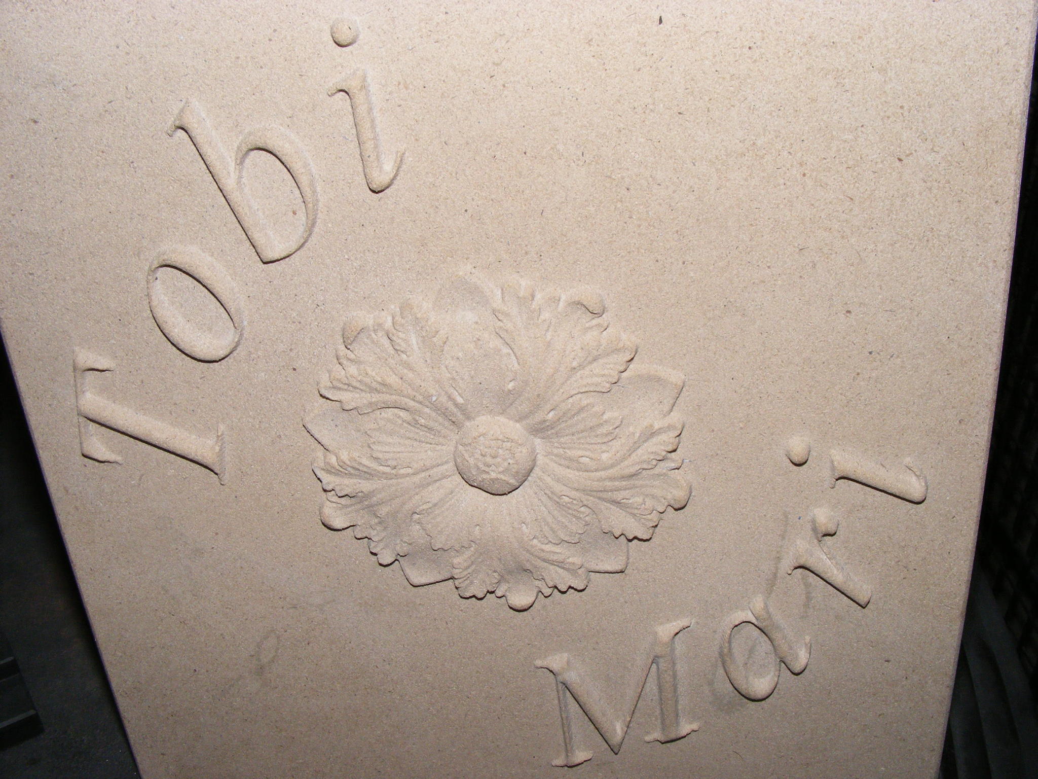

    The image below shows a 2.5d relief that is 8mm high for the flower and 6mm high for the text all the stone between is ground out with 2mm roughing passes then change to a V cutter to do the relief in 2mm passes.
