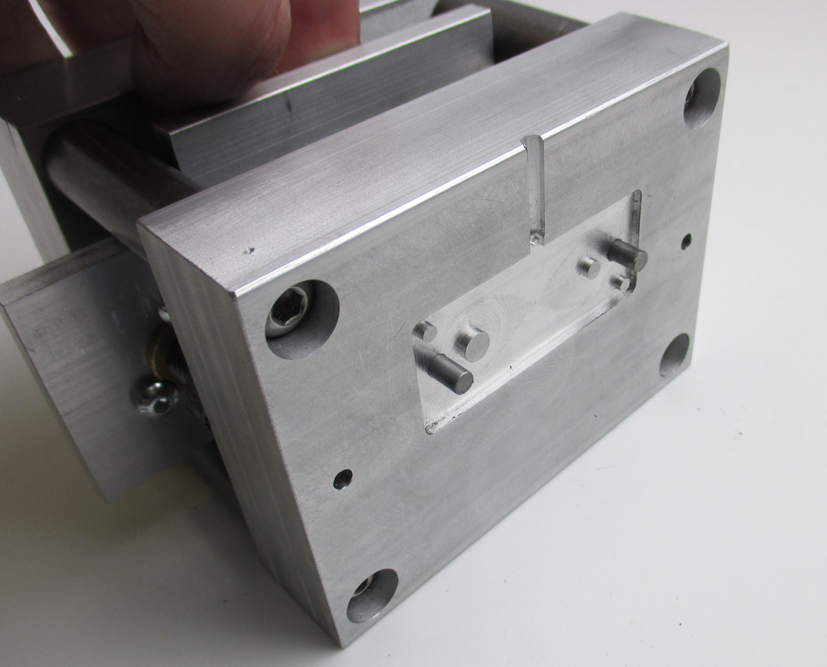

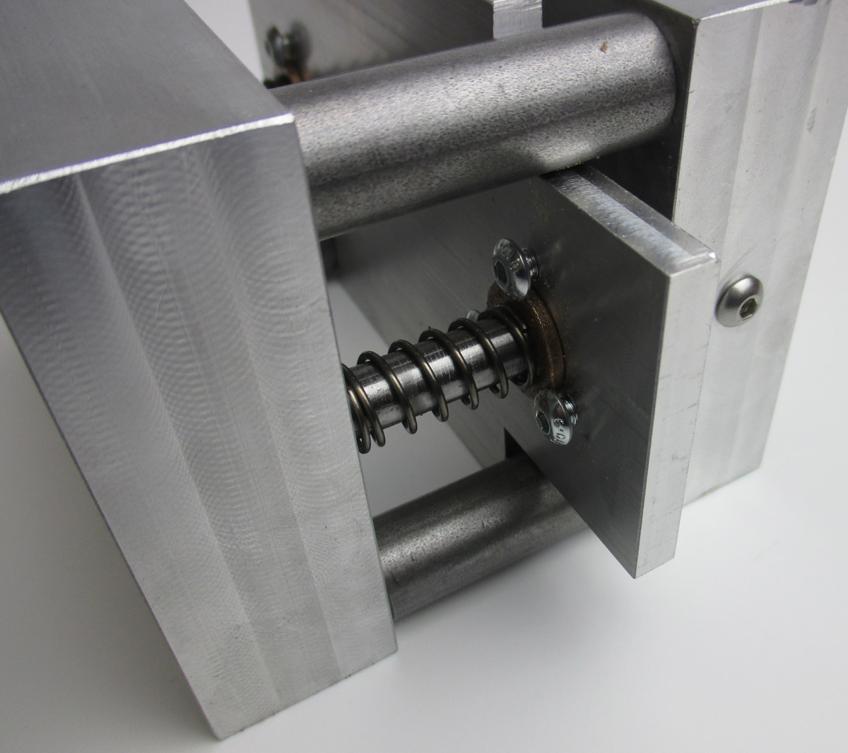

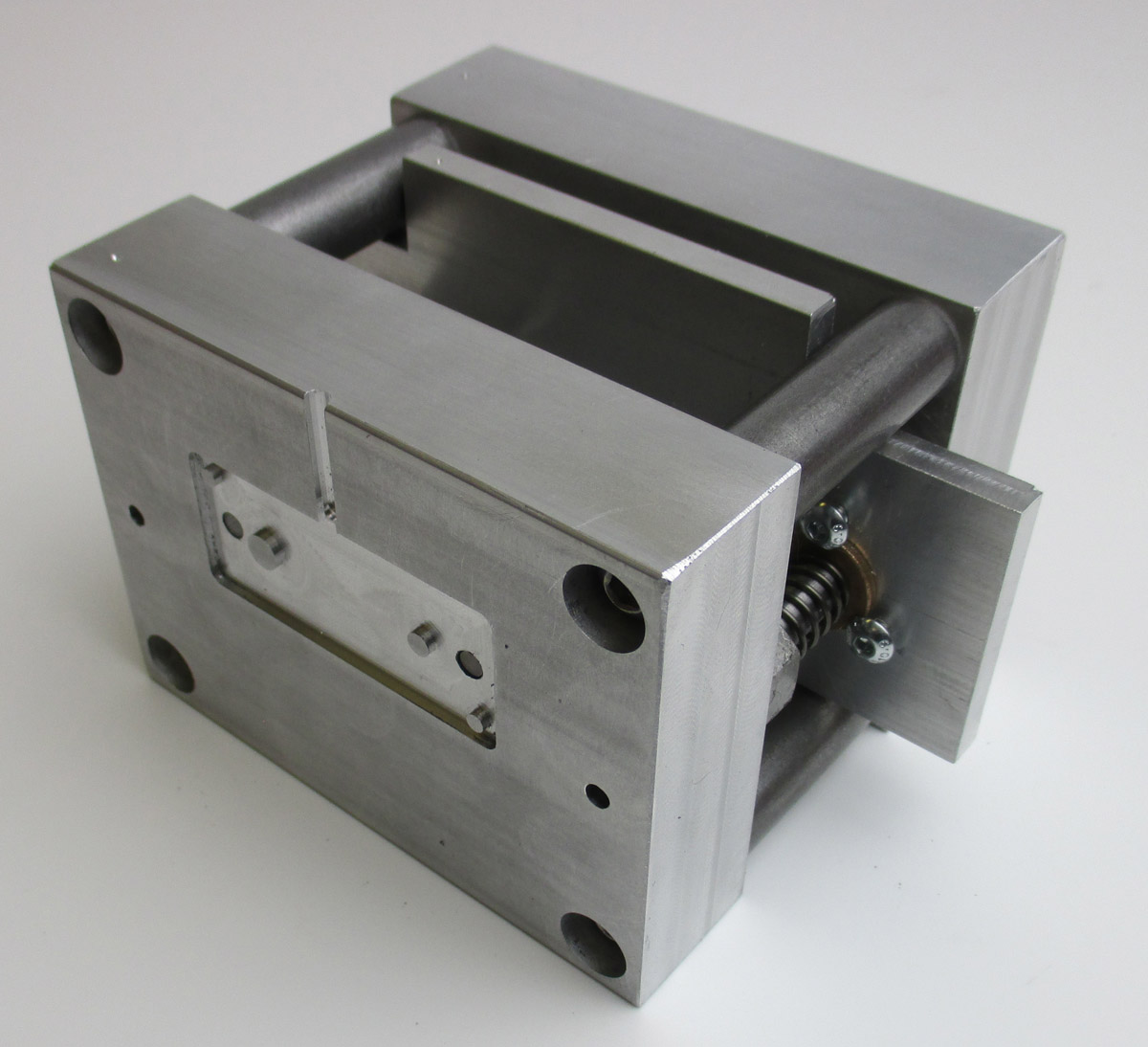

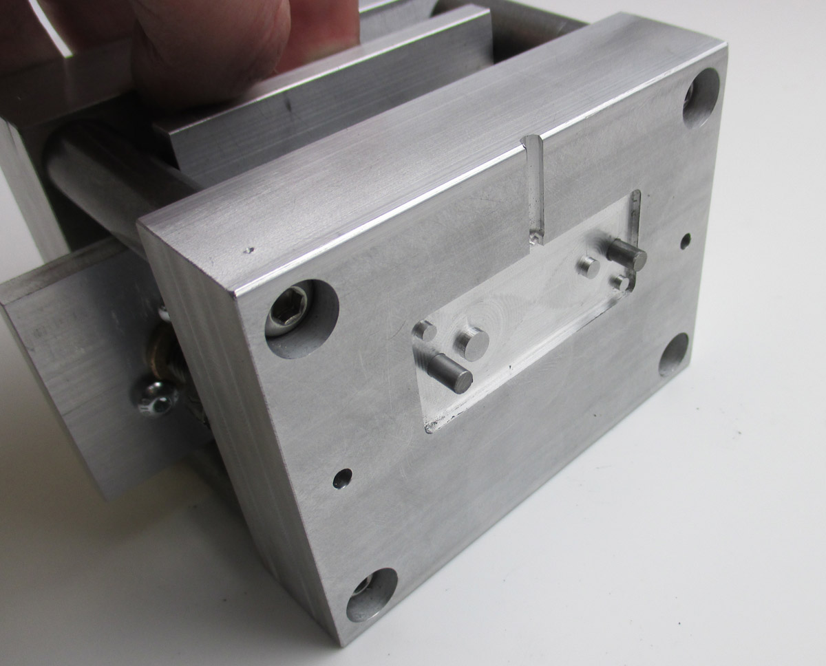

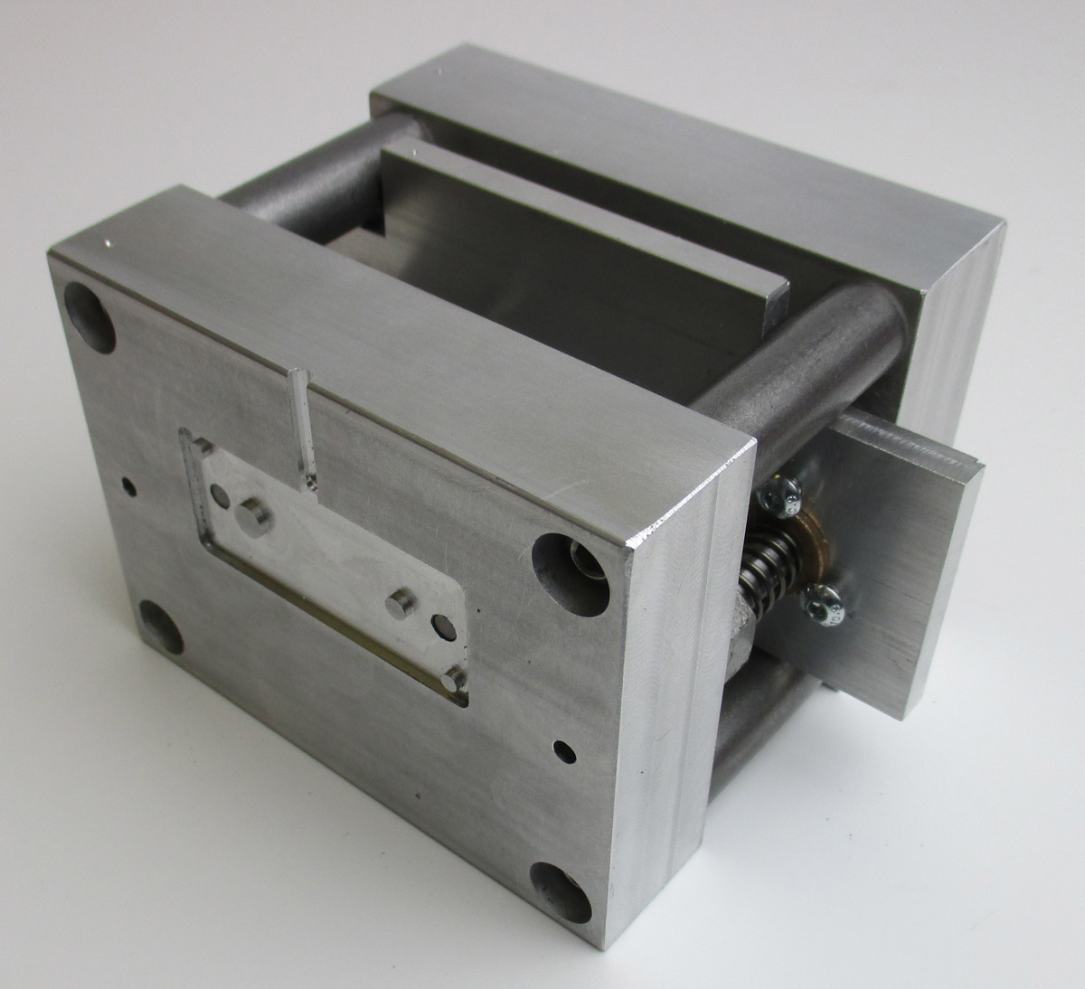

    Anyway, I thought some photos of a mould tool that I produced may be of interest. it's for a simple flat lid with 4 holes in it. The photos are of the moving half of the tool. The other half is simply flat, although that might change.
    The real time-saver is the ejection mechanism. This means that the machine can probably do 2 cycles per minute.
    The tool is the standard size for this type of Travin, i.e. 4 inch by 3 inch, and injection is obviously on the split line.
    The tool path for the cavity was produced by Meshcam, and milled out on a Taig. It's almost 2D, but as a starter tool, it was enough to give me an idea of what was required, and a feel for how the machine operates.
