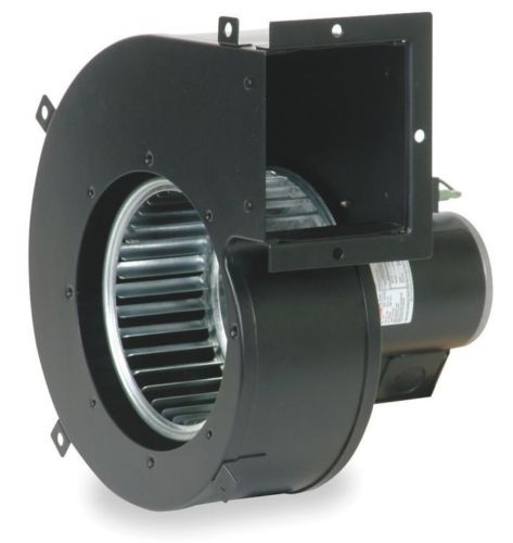

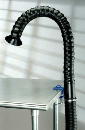

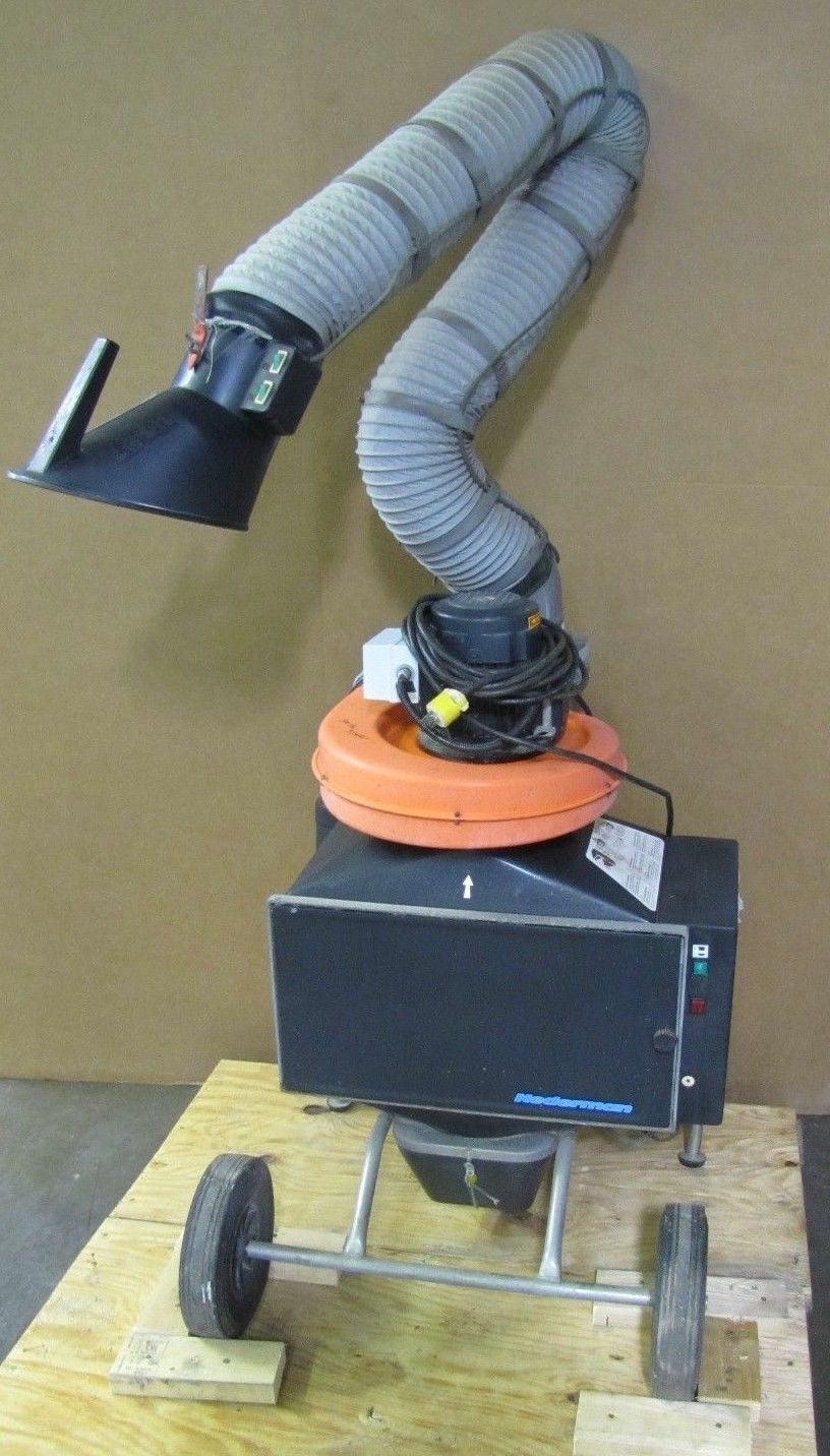

    The extractor fan could not be so big as some would imagine. If i was doing it i would make it more local with adjustable arm and not so big funnel, there is some big lock line on eBay for this purpose. Couple that with "fan blower" , use that exact words on ebay search and you will be fine. Use "welding fume extractor" and maybe you will find cheap the hose part separately.
    One thing is that i would make it portable though. So i could use it anywhere.
