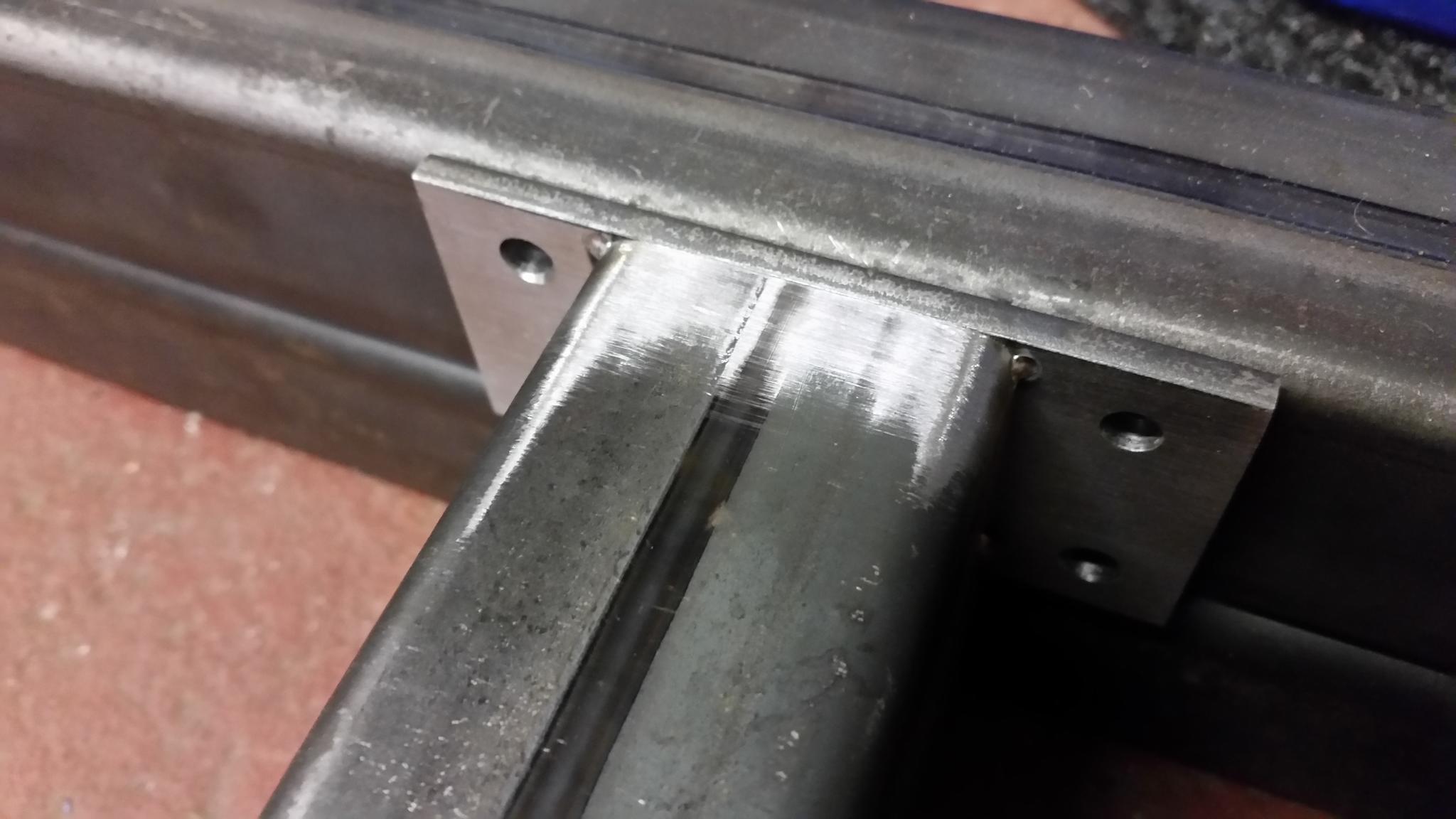

    Hey Guys
    Thank you very much for the replies and I am sorry I haven't updated the thread it didn't let me know that anyone had replied for some reason.
    The image below is what I am trying to bolt together.
    I have used a 4.2mm Cobalt drill and then used a 5mm tap in the pillar drill and started it to keep the tap straight and then finished it off by hand although the threads aren't very good at all on two of the holes it has only got 1 thread fully around and hardly any on half of the hole which I guess must be an oval hole or something. I'm just not getting the result I should be the main issue seems to be the drill wanderd around using the pillar drill. I have used a big centre punch and then even started with a step drill of 4mm and then swapped to the 4.2 I have even turned the drill by hand and drilled the starter hole before turning the drill on and that doesn't seem great either.
    I guess it's most likely the pillar drill that's not up to the job the sad truth is I think I will get a better job using my dewalt hand drill. It is a Kinzo pillar drill so a cheapo unit but I would have thought I should be able to get a hole really maybe its the monkey that's using it blaming his tools

    Hi Rob
    Sorry to hear you are having problems.
    Are your Drills ground finish and do they run true in the drill chuck?
    I have had drills that were totally useless because of being bent.
    Drill the holes @ one sitting ie just go for the 4.2mm.
    Please don't start drilling your frame until you have perfected your marking out/drilling & tapping technique.
    Also you have made a nice job of tacking your plates onto the tube, if i was going to finish weld i would only weld the top & bottom of the plates, if you weld down both sides you will get weld shrinkage that will cause them to bend.
    Mike

    If you look closely at the tip of your drill, you will see that it comes to a so-called chisel edge; the very tip is actually a short sharp line and not a point. If you are going to pick up a centre punch mark with a drill like this, you need a dimple from the punch that is at least as big as that chisel edge so that the "point" of the drill sits right inside it. One way to do this is to use a small sharp punch to put the first mark in and then go to a bigger punch to enlarge the dimple. The other way that works for me is to use small centre punch mark and then go through with a smaller drill (say, 2.5mm or so). These are a bit more fragile so need a bit of care but these smaller drills have a much finer point and they will follow the mark and go through the steel much more easily. Then follow up with the 4.2mm which should follow the pilot hole. Advice to use centre drills is great and probably the proper way to do the job, but only if you can clamp the work firmly on the drill table. The points on these things are pretty fragile and while they'll take quite a lot of downforce for cutting, they will snap at the slightest sideways movement.
    I don't know if it's encouragement or not, but I drilled all the holes for my linear rails (total of about 100 M5 tapped holes) freehand using a cordless drill. However, I clamped the rail in place and then used a little drill jig to locate in each hole in turn to guide the drill so that it was central in the hole and close enough to square. I am using 3mm steel, but I have strengthened it with 5mm strip on the inside so I was effectively drilling 8mm of steel with a hand-held cordless drill.
    For tapping, forget the usual hand taps. Get hold of some spiral point taps if you are tapping through holes, and spiral flute taps for blind holes. They are ground very differently to hand taps so that they can be used in tapping machines to tap a hole in one pass - no backing off every half-turn. I've used a spiral point tap in my cordless drill for tapping some of those M5 holes and (using a good tapping compound to lubricate the tap) they are magic. They are pretty cheap although you'll have to wait for delivery from China. You'll find them on eBay.
