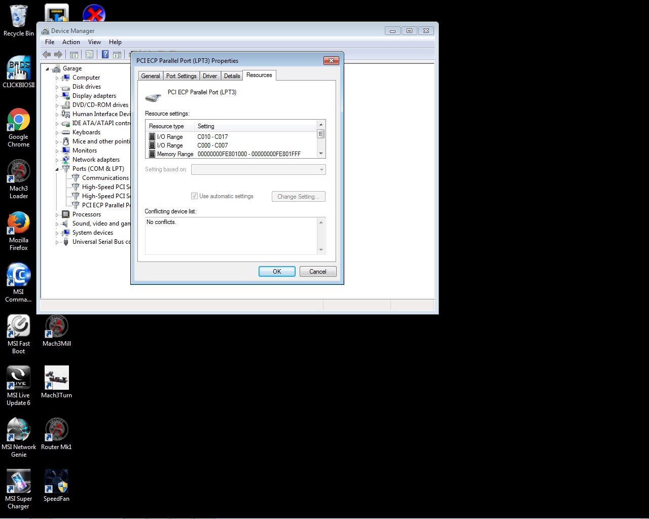

    I'm using one of these on an AMD A55M-E33 motherboard.
    Here are some screen shots of device manager entries, which may or may not be useful!

    I'm inclined to agree with Rob - most likely issue is the wrong driver. Are you happy that you have the right one for your system? Again, FYI, I'm using Win7 64-bit. Sometimes you might need the corresponding Vista version (32- or 64-bit) if there is nothing newer around and these seem to run OK on Win7.
