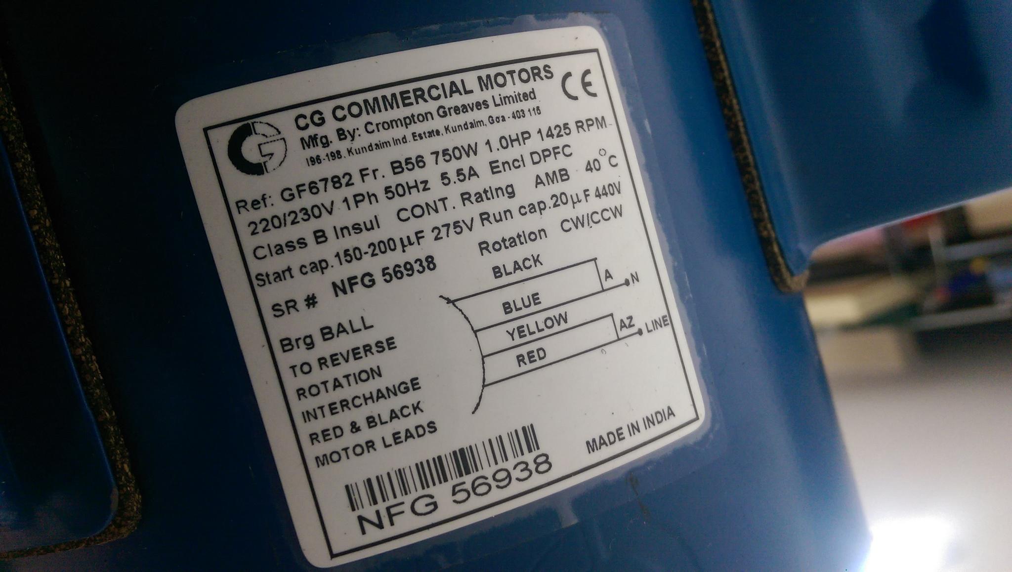

    Hi gang, would love your input on this, got a drill press with 1HP motor, unfortunately at the time of purchase I didn't get to test it thoroughly so I'm stuck with it, it is fine for the most part but changing the belt pulley ratio is a big hassle in this model basically. (and indian company with no website as far as I know) , is it possible to keep the belt at a position and just put a VFD and use that to change the speed/torgue?
    motor information:
    CG Commercial motors
    230v 1ph 5.5A 750W 1.0HP 1425RPM

    Yes, but you need for that to work well - 4 pole 3 phase motor rated at ~1400rpm. Then you would be able to control it in the range of 600-3000. As you see is not enough. So you need DC motor, say from a thread mill, or even better would be a servo motor. Expensive? Then change belts...

    Yes, you can easily do it.
    Use a 2 pole 0.75kw compact frame motor and an Inverter-Drive of decent makes and your top speed limit will give you plenty of range, I have a 2 pole 0.75kw compact frame motor which runs at 7000 rpm on my benchtop mill, I used it to replace a DC motor/controller which wouldn't give me a usable 1000rpm to 7000rpm.
    Motor £150 new, Inverter Drive £100 NOS from eBay.

    In short, I think that the answer to the original question is, yes, fixed pulleys with variable-speed motor is a practical proposition, but you need a VFD plus replacement 3-phase motor to do it. You can't make a simple single-phase motor into a variable speed motor just by feeding it from a VFD - unfortunately.

    lots of great information surfaced in the thread, appreciate if you can just let me know what would be the problem in using a 1ph VFD?
    got my eye on this one http://www.ebay.com/itm/0-75kw-Frequ...16402#shpCntId and seems it would work, am I missing something?
